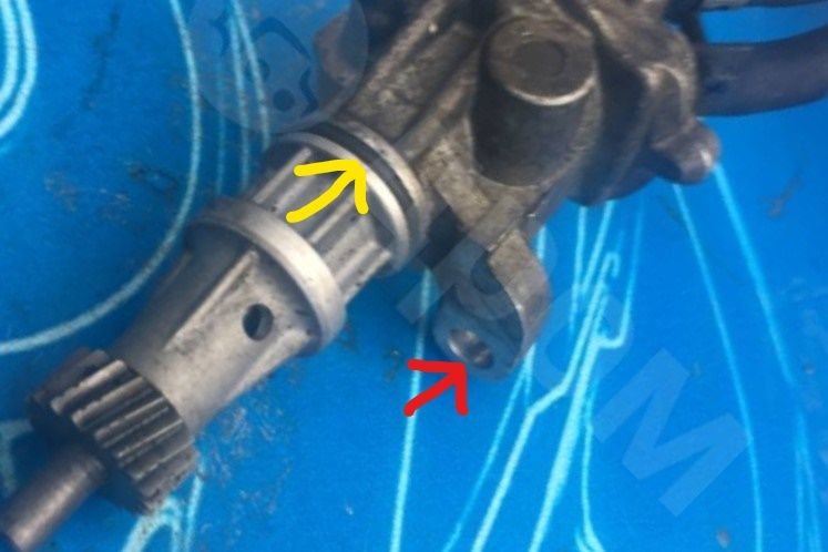

It looks like #20 Bolt Washer (8X26) (at the red arrow) is the only fastener that holds it to the tranny. It may just lift up vertically, that is if there is space where you'd be working.
Maybe #17 might have to come off held by #29 bolts?
Select Parts Category - 2001 Acura TL SEDAN | Acura OEM Parts
Is that the O-ring (Yellow arrow) you'd be replacing; #25?

Yes its that o-ring and I believe there is another internally once you disassemble it. I got that bolt off but its not coming loose and i don't see any other bolt attaching it. I may just have to muscle it up and out..looking forward to smashing my fingers lol. If anybody is replacing those inlet/outlet hoses they are 1/4 and 5/16 and i used trans cooler hose..thank you for help btw.

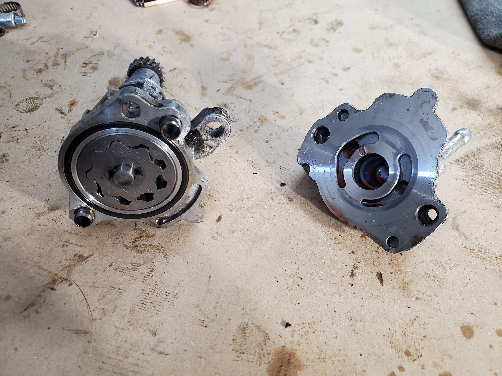

I tapped it out with a hammer from underneath using a long extension. So here is the speed sensor out and dissambled. I'll be replacing both o-rings and that should eliminate the leak...

Thanks for the pictures. It is quite evident that those O-rings a perished and flattened.
Just to clarify, is this p/s speed sensor a secondary 'pump', of some type, to the main power steering pump?
What's it function / role in the grand scheme of the p/s system?
I don't see that larger O-ring on the parts diagram?
5AT ATF Warmer - Speed Sensor for 2001 Acura TL | Acura OEM Parts

Yes the o-rings are flattened and hard. It is not really a sensor, more like a little pump that runs off of the fluid inside the tranny and controls power steering pressure by the amount of flow in the transmission.
