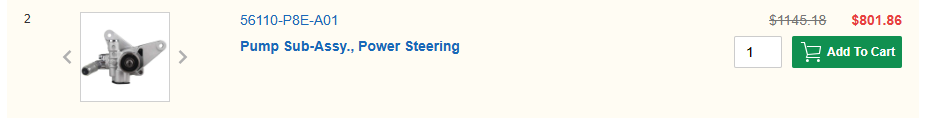

Acura OEM parts prices have increased significantly. My 2000 TL’s power steering pump needs replacement, but Acura wants nearly $900 for the pump. Can a Honda P/S pump work? If so, please share the Honda part number.

Even if you wanted to consider a new OEM Honda model P/S pump equivalent, which the 00 AV6 is the closest to your 00 TL, you'd only get $8.25 in savings joy, lol.
The 00 TL P/S pump part # is
The 00 AV6 P/S pump part # is

Four viable options.
Comb your local salvage yards for the year / model Acura's below & get lucky with a low dollar salvage unit?
Purchase everything OEM to rebuild your 25 y/o factory P/S pump @ roughly $102.59 before shipping / taxes / handling / rebuild time:
Roll the dice & consider one of the below replacements from rockauto (before shipping/taxes, before tariffs hit, lol!), throw it on, done, cross fingers.
Go OEM at those ridiculous prices.
