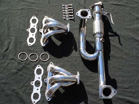

For those who have aftermarket headers. From the picture, one of the pipe on manifold is bend is that the way it should be or not? Thanks

Yes, that's normal.

these are 6 speed headers.
but they'll work on auto.

Damn those are SHINY!

yup good to go, good luck with them, youll love em

Yup, those look like mine - Stone Racing headers.

Yep. Those are Stones and I got them from ebay for 275 shipepd. That's the picture the seller used in the auction. FYI I had them installed by an Acura tech and he said there were ro fitment issues (downpipe, O2 sensor etc.)

nope fit up just right. there was a slight resonance at about 2400 rpm, but it was because I didnt get the bolts re-torqued...so get that done and it will be all good.

What is different between the 6sp headers and the auto headers???

see the bend in one of the pipes in the bottom header in the picture? that is it...the 6 speed headers need that for clearance - but it can be used on the auto also.

damn that is nice. what you should do now is get it either wrapped with head wraps (ebay for 40 dollars - 2x50) or get it powdercoated. that'll keep the heat in the headers and let nothing out into the engine. getting your headers wrapped or coated makes a huge difference! and you wont get that ugly bronze color.

I think the bronze color looks 100x better than header wraps !!! plus there is no reason to do that really
