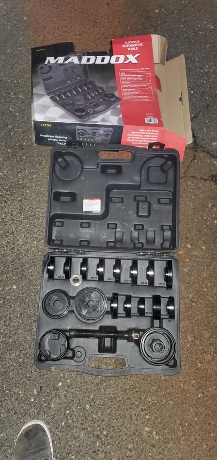

Bering press hand tool ( ohhh snap this is from 2015! )
Originally Posted by Dabu
What a coincidence, I have to change out my cv axle/wheel bearings, new NSK bearings on the way but I don't think this is a DIY job... I can't press the hub and bearing without some tools I don't have access too..
Harbor Freight
Maddox 21 peice Front Wheel Bering Adaptors & Tool $119
​​​​​​$105 after %20 off coupon and tax.
Part # MC21-1
Picture below
No i dont work for them. Lol
WORKS GREAT
CHEERS
