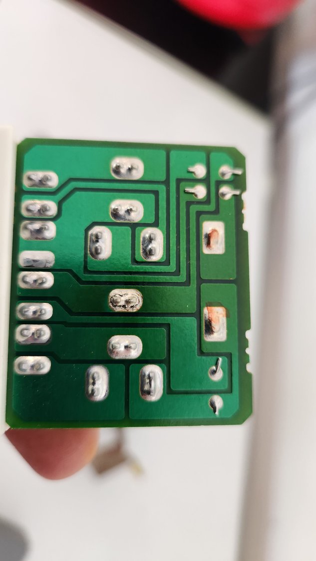

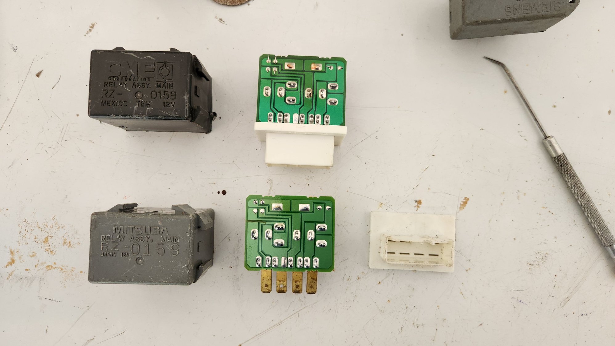

had that happen yesterday, check the main relay. mine was hot and cut the fuel pump off

Thanks. I repaired mine a few months back, guess I didn't do a good enough job. I'll order a replacement and see if it's fixed.

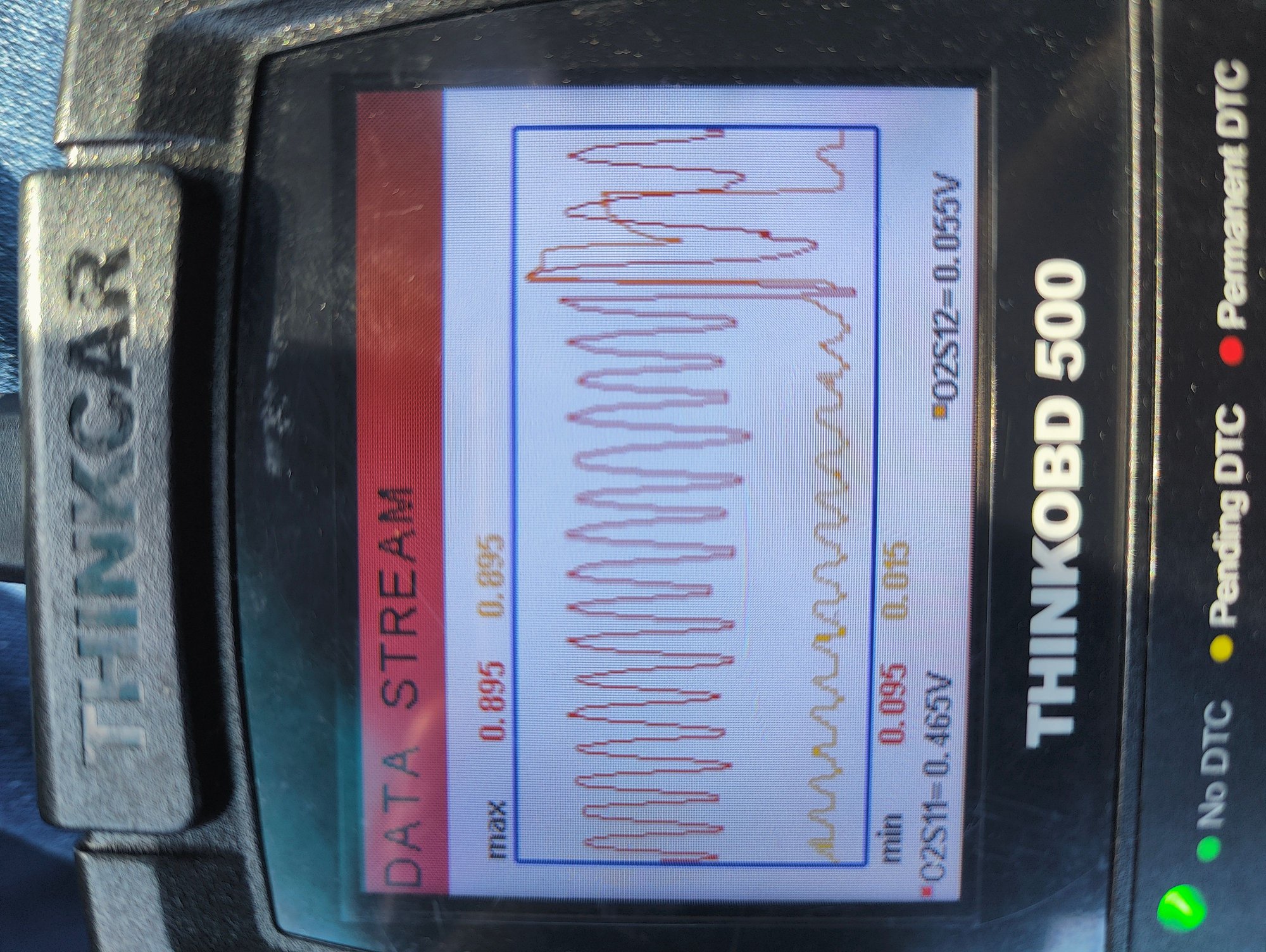

Here are the fuel trims and air readings I grabbed back when the code popped up. I think these were taken after I cleared the code.
At idle
on the highway. After driving about 40 miles
I also initially thought it was too much air, so I checked the MAP vs throttle position:
Throttle / MAP (inhg)
  • 9.8% / 6
  • ​​​13% / 12-13
  • 31% / 25-27
  • 56%+ / 30
These all seemed within normal range to me though. What do you think?

Interesting. The first picture of the fuel trims shows you just cleared the memory as the long and short term are the same. A reading of 10.9 says that the computer is feeding more fuel to keep the air/fuel mixture good. The trims should be between +/- 10, The second reading shows the car is not getting enough gas and is trying to compensate by adding more fuel. Over 20 is maxed out. Do you have Fuel Pressure gauge?
The car battery and alternator can have a few checks at home. You can measure the battery using a voltmeter. Should be about 12.7 - 13.4 vdc, if the car is idling it should be about 13.4 - 14.4vdc. When I suspected my battery in the past, I would bang on it a bit to help settle any growth of metals between plates. Then charge the battery, and if it was low or ran low quickly I would either buy some battery acid and add to each cell (when I was low on cash) as this could help make it last a few months or I would buy a new one (if I had the cash).
The alternator is bit more tricky as it needs a load to see if it performing correctly. One was is to start the car and disconnect the battery, if the car is still running the alternator is good or ok. If the car stalls the alternator is bad. We used to replace the diode packs in them but I don't know if you can find them now days.
Auto parts stores are not repair shops so I doubt anyone will come to your home. You should call them and see if they can bench test the battery and alternator.
Right now you are still at the part where you need to identify a cause. This can be many things at this point but the more information you provide the better others can help. Lets eliminate the easy stuff you have concerns about such as the battery, alternator, and timing belt.

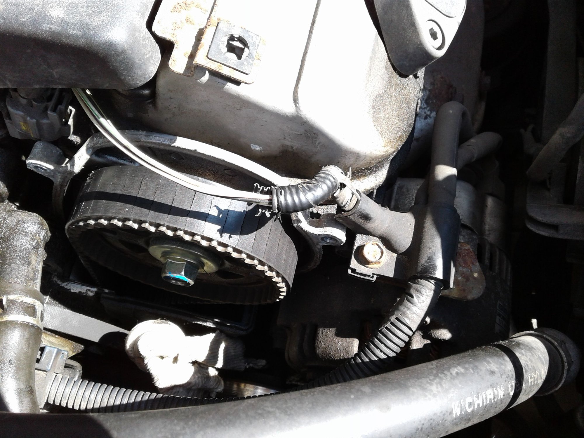

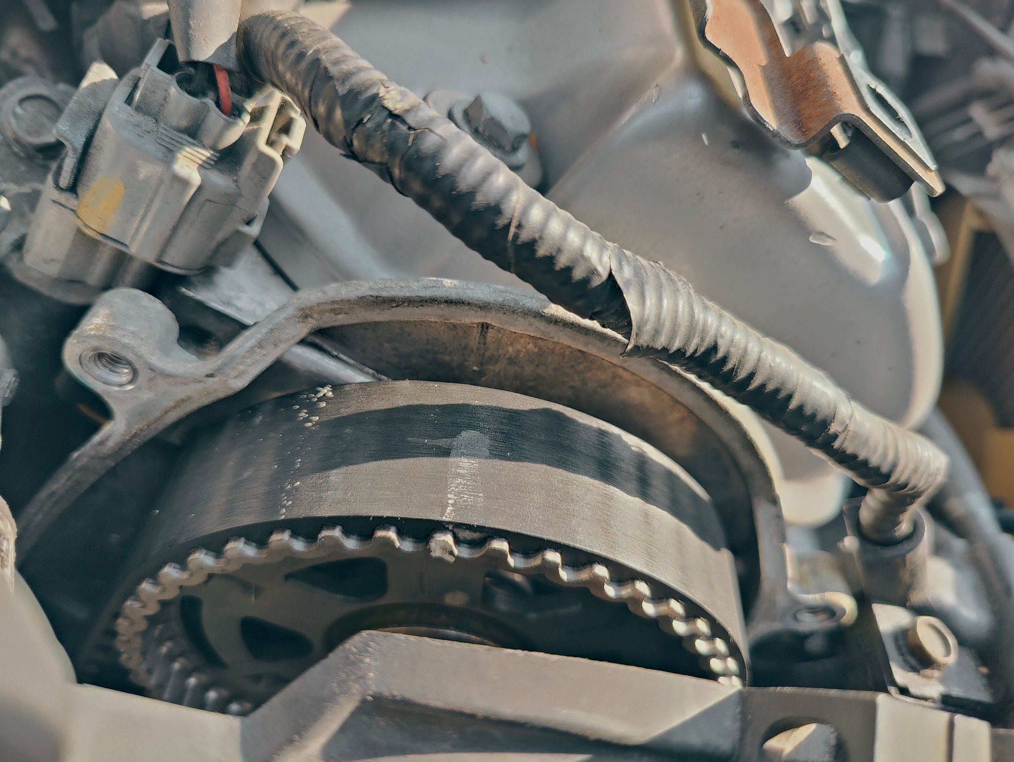

Timing belt at TDC, looks like it's ok. Belt also looks fairly new (<10k miles on it, although it was done 2yrs ago).

Regarding the o2 readings, here are a few charts I grabbed around the same time as the trims I showed earlier.
Cruising on the highway
Mixed driving, some stopping, acceleration, coasting
Same as above
I believe this was idling at a light
Red is upstream. Anything jump out to you?
They seemed ok to me, which is why I cleared the code. figured the car had been sitting for a few weeks and maybe needed some time to adjust everything - clearly I was wrong lol.

The o2 sensors look fine. You now have a new battery and know the alternator is fine. So it is not a main voltage problem. Out of curiosity does the immobilizer key display come on and go out when you try to start the car or does it stay on?

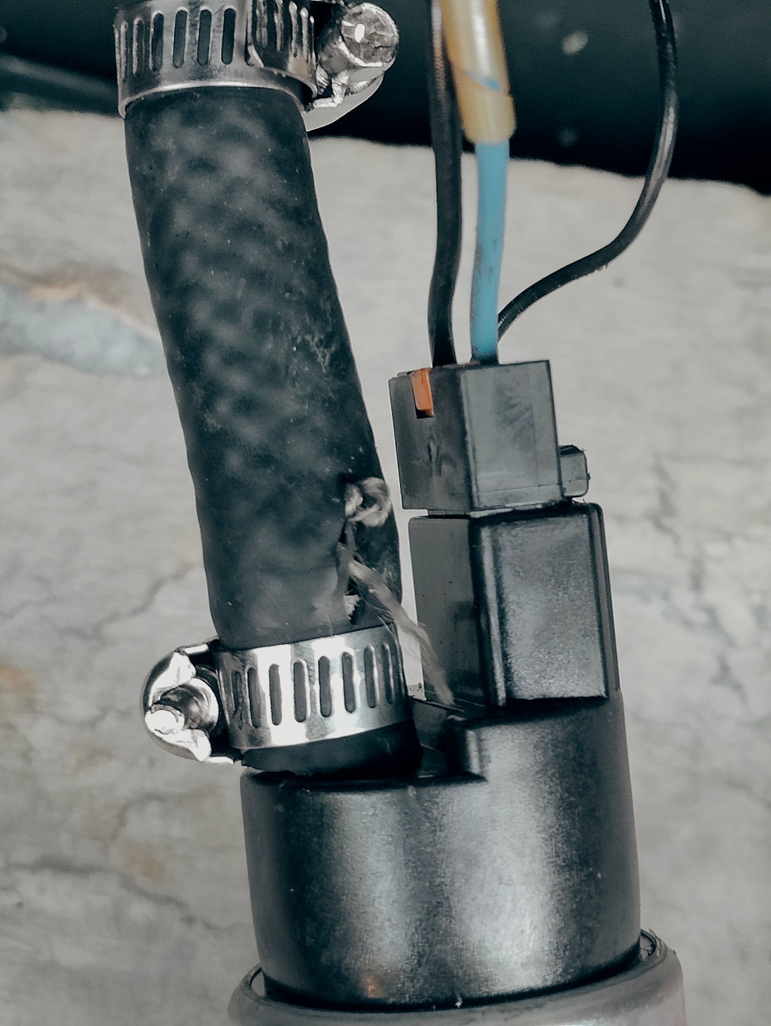

Besides the cracked fuel filter, shown in the link, I have also had cars with a bad fuel pump and worked on several were someone replaced the fuel pump but used regular fuel line not submergible fuel line. The fuel line connected to fuel pump melted away or burst.

Yep, here's your burst pipe - good call Jon!
replacements are on the way so I'll report back once they go in.

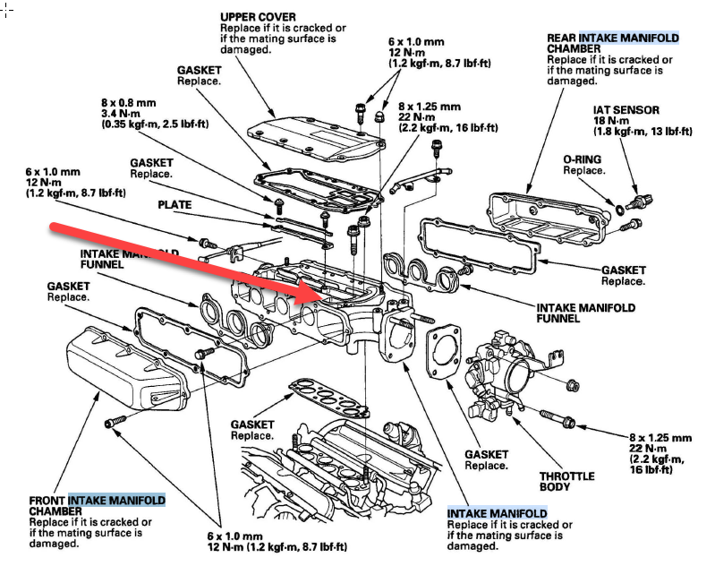

As for the intake I removed the whole manifold when I replaced the injectors so I put in a new upper and lower gasket along with the gasket between the TB spacer and manifold.
The kit did come with 2 lower plenum gaskets which stumped me a little bit. I ended up using 1 gasket since that's what was installed before. Should there be 2 gaskets?
And as a sanity check, these are the torque specs I used on the intake:Lower plenum: 16ft-lbUpper plenum: 8ft-lbTB: 16 ft-lbtightened from inside to out per the manual, rubbed a little oil on it to help with the the seal.
I guess i can try the spray test around the intake as a start.

Is the 'tab' on the upper gasket facing the rear or towards the firewall?

If I remember correctly the 2 gaskets are included for the lower but only use the one that fits. I believe that one is for the model that has the more individual pipe looking manifold and the other that has the flat top manifold. I think the 99 had pipe and the 200-2003 had the flat.
2000-2003 TL
99 Tl
16ft-lbs and 8.7ft-lbs are correct (page 9-3). Be careful of over-torqueing bolts as it is easy to strip out Aluminum blocks. Picture below. Did you clean out the grooves in the intake manifold (red arrow)? They are part of the EGR system.
Looks like it's on the drivers side, pointing towards the TB. Is that correct? I wasn't 100% sure about which way it went, just tried to match the groves as best as I could.
Sorry for the quality, took it in the dark.
