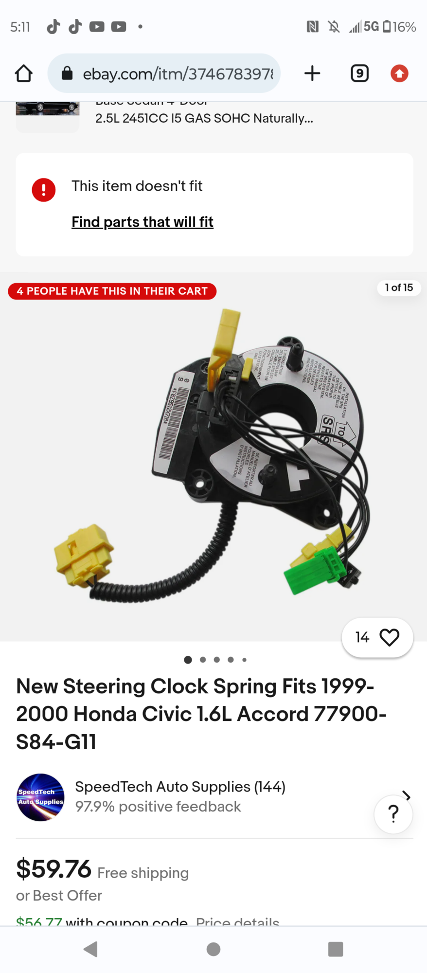

Need help with clock spring my clock spring broke can't find one

​​​ need help finding new clock spring took off steering wheel to replace windshield wiper switch behind steering wheel and clock spring broken fell apart and can't find one I've looked everywhere
Found these on car-part.com.
As an alternative, maybe try looking at the clock spring for a 1997 Honda Accord, although, they maybe 'discontinued' as well.
