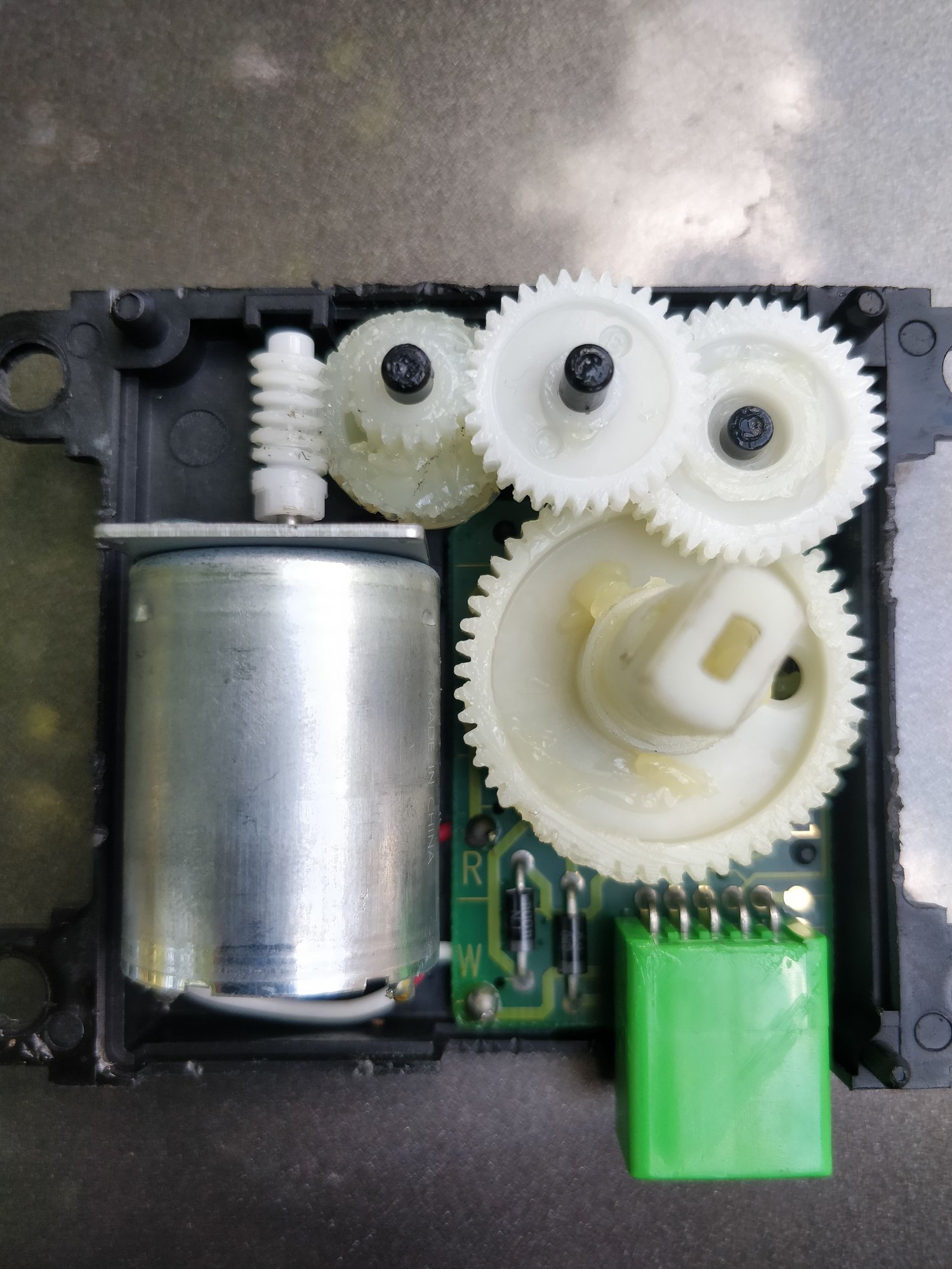

Originally Posted by sniz
I have a '99 TL with 40k that just started doing this. The problem is a broken tooth on a plastic gear in the motor gearbox. I fixed it by taking apart the motor and turning the gear 180 degrees so the broken tooth doesn't mesh with the other gears.
You can only do this if the broken tooth is on the large main gear that's attached to the output shaft. It never makes a full revolution.
The motor is under the dash on the passenger side upper left, with a green connector.
Remove three 8mm screws (I had to unplug the middle ECU connector to get at the rear one)
Use a flat blade screwdriver to pry the plastic lever from the motor shaft.. take note of the position of the linkages.
The gearbox is held together with plastic clips. They're brittle.. I broke all but one, but it doesn't really matter - it goes together pretty tightly, and when you put the motor back in, the mounting screws will hold it together.
Carefully pry the gearbox halves apart, so the gears don't fall out.
Remove the circuit board on top of the large gear. If the broken tooth is on this gear, you can turn it 180 degrees and put it back in. There are 2 sets of 3 brushes that ride on the circuit board like a potentiometer for position feedback. They're exactly the same, so it doesn't matter if their position is reversed.
Everything was moving properly after I did this, but no heat - the heater valve cable was also broken under the hood right where it attaches to the valve. When I turned the lever on the heater valve manually, it was difficult at first, then loosened up. This could be what caused the problem in the first place.
I had the same exact issue with my 2007 Acura TL.. this was exactly what happened to me, clicking noise under steering wheel. I took the motor off, disassembled and sure enough a tooth gear was broken off. I turned the gear 180° like mentioned here, assembled everything back together and it went away. Thank you so much!!
Little tip, when taking off the big gear try to remember the position of it so that you can turn it around as close to 180° as you can get otherwise the motor and the linkage won't align under the steering wheel when you go to put it back together. Since I forgot where it was I had to take it apart and put it back together few times in order to get the positioning just right.
​​​​​​This part costs $70 plus tax at AutoZone,
can go take my gf out for dinner. Good luck to all!
