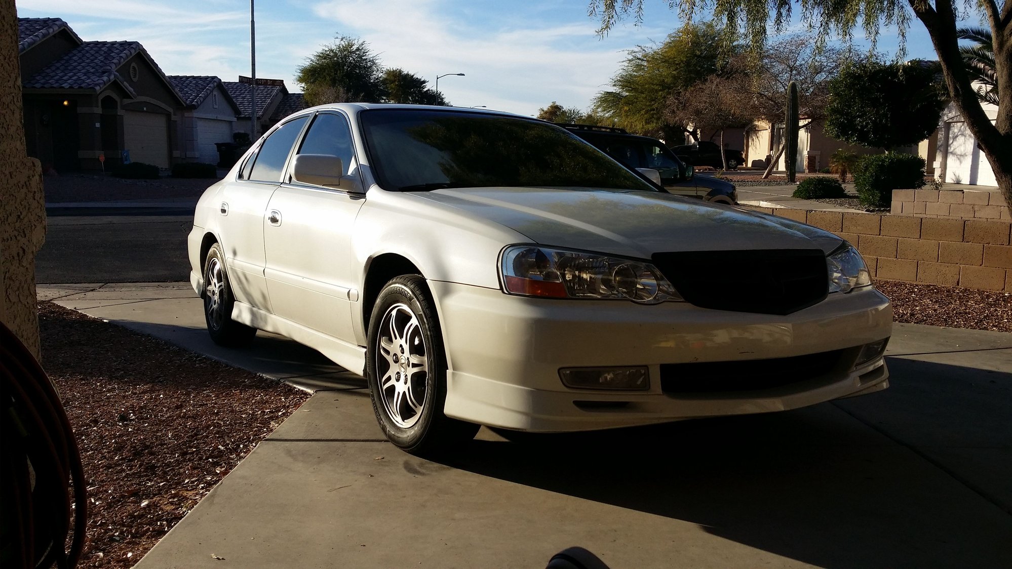

I am happy to report that she is back on the road though! It only took a couple hours to fix surprisingly. I only had to install a new lower ball joint, CV axle, rotor, tire and alignment. Did the work myself, except alignment, totalled a little over $200. MAN I WAS LUCKY!
