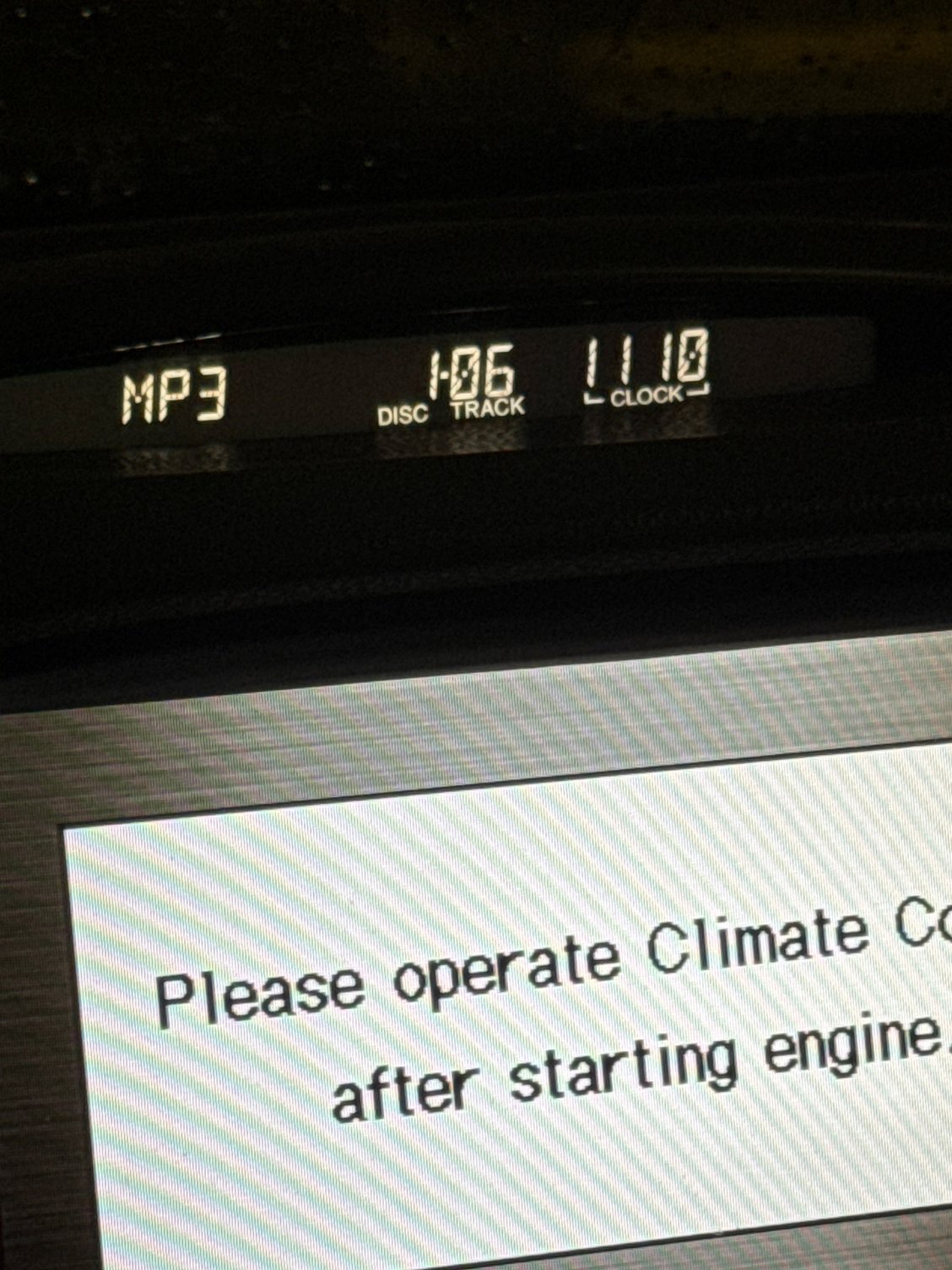

So I was on eBay looking for a new ambient temperature sensor that wasn’t +$50. After my purchase it recommended a clock display service that involves you purchase the service, mail them the part, and they fix it. I’ve seen videos on YouTube stating that the clock display needs to be resoldered and to “rewet” those connections. So I took off the clock display and disconnected the speaker and started taking off the clock display so I could remove the fabric cause it was stained and bugging me so I figured I’d wash it and glue the fabric back on. Turns out the plastic was also stained so I wet it down and got that stain off. I decided to disconnect the speaker because I had aftermarket amp, speakers, and sub installed and my amp didn’t power that speaker. I initially didn’t remove it because I was worried it would throw a code. So I restarted the vehicle and I’ve been driving it around and now the clock display works just fine. Maybe something to consider if you’re having that issue and you’ve moved to an aftermarket system without the center dash speaker.
