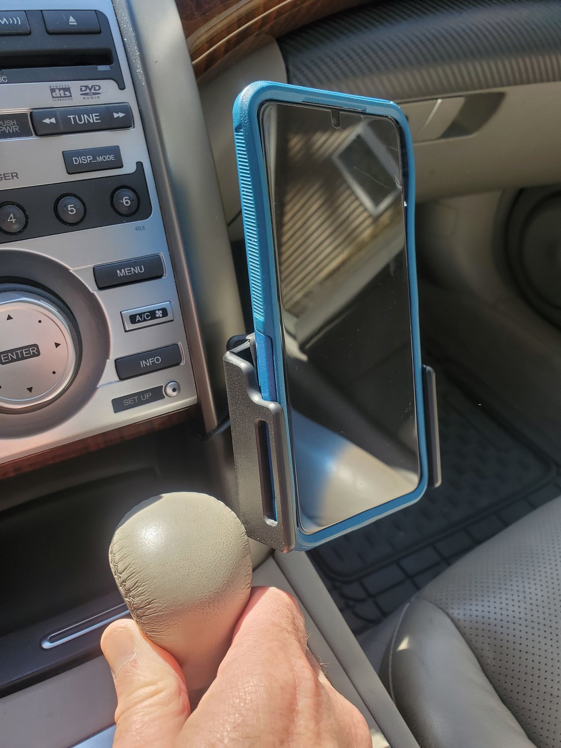

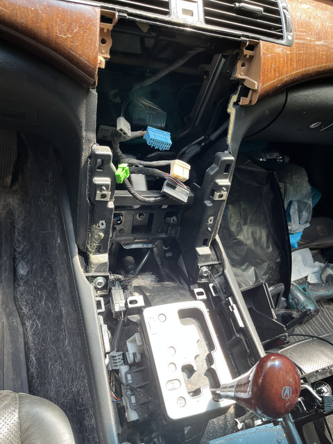

I bought a 2008 RL from a good friend about six months ago and I love it! Yesterday it got an oil change and tire rotation. Upcoming projects will be a BT45-ACU Bluetooth module and probably a ProClip phone mount. I have seen several posts about the Bluetooth module. It looks like that is a good, and probably the only, option for the RL. But I am open to suggestions on both of those items.
I have the BT45-ACU...works great. I even connected and ran the microphone wire up to the driver's side sun visor so I have hands free phone/SIRI.
If you have the inclination, upgrade the door speakers...even just the front 2 doors will make a huge difference in sound. The woofers and tweeters are separate, not a coaxial. The rear speakers take a lot more work to replace the tweeters (they are in the rear deck, have to take the rear seat out) though the woofers are simple, but most of the sound is in the front when driving. The front tweeters are in the door along with the woofers.
I put in Polk audio speakers, but any decent type will do. I have a link somewhere on how to do it...
I also put in a backup camera (I have a "Base" not a "Tech" version). That was easy to do too if you don't have one.

Originally Posted by marjenmiller
I should clarify that I have the BT45-HON (Honda version, not Acura version). Check your Model Year/Trim to get the correct version. I bought mine through Crutchfield, so they can help you identify the correct BT45 you will need. Simple to install, hooks up in the trunk on the driver's side to one of the XM radio plugs
Thanks for all the advice! I bought my BT45-ACU through Crutchfield and used their product selector. So, I believe that it should be correct. Planning to do the installation tomorrow. Not sure if I'll install the microphone.

The BT45-ACU installation went very well, and I'm happy with the sound quality. I installed the microphone at the top of the driver's side A-Pillar, tucked the wire into the trim under the edge of the head liner, then down the C-Pillar and behind the rear seat to get it into the trunk. There is only about an inch or so of microphone wire showing between the C-Pillar trim and the rear seat back. I had to remove the rear seat cushion then loosen the rear seat back, but that was simple and my shop manual had good instructions for doing this. I've been told that I sound good on phone calls. The audio of phone calls is fair. People sound a little like they are muffled, and it's different from how they sound when I'm just using my phone or earbuds. Not sure why, but it's good enough for what I do and I'm not going to spend time trying to improve it. The stereo audio is very good. I'm not a picky audiophile, and mainly listen to podcasts anyway. Installation instructions were clear and the DIP switches came preset correctly from Crutchfield. Really happy with how this all went!

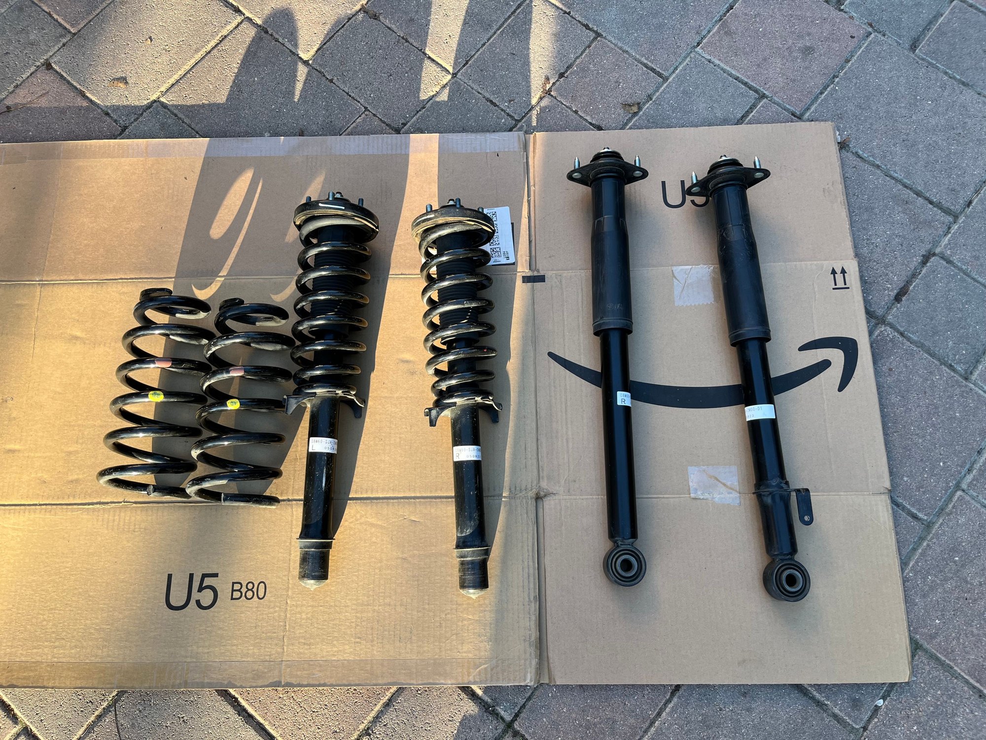

I've been a long time member here since 2005, but I couldn't login to my old account. But! Today I removed the A-spec suspension from my RL and placed the original ones in. Didn't take photos of the progress, because it took longer than expected. Removing the rear seat back was a PITA, and the front suspension fork was also a PITA. Ended up having to remove the upper control arm, the upper double wishbone part. The service manual just says to push down the lower control arm to give it enough space to remove, well that wasn't happening at all.
Anyone interested in a set of lightly used A-spec struts and springs? They're definitely discontinued at this point.
Why did you decide to go back to the standard suspension? Curious
i am curious to know as well about what makes you to go back to stock suspension. i also might be interested in ASPEC suspension. depend on the price and you are willing to ship if you are not close by for local pick up.

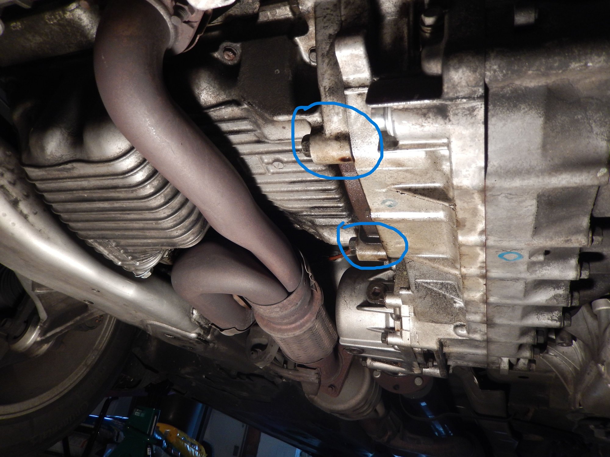

Hi All, I've been working on the '05 RL for about 4 months and tackled the following:
