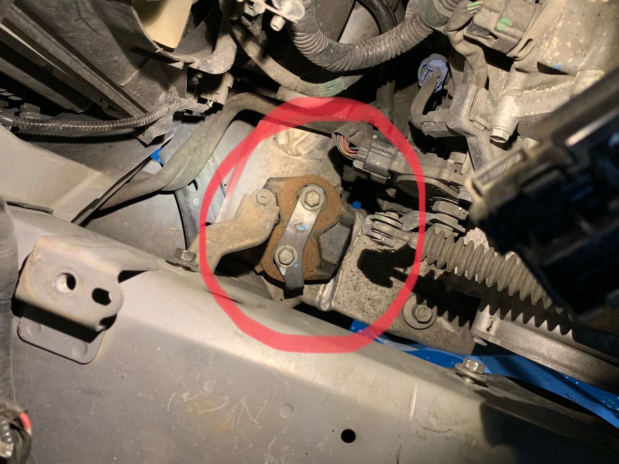

Some pics to help
This is right against the sway bar back side under the transmission
I bought this mount, should be front upper but there isn’t anything like it around
This is lower left under headlights and battery box, i have no idea what it is or what it does.
Expensive mount broken.

I’ve searched the car over and over, the mount that I purchased does not go on my car, I’m 100% certain. However, I did find the transmission mount that’s bad. I found a replacement at parts geek for 309 and a 15.00 coupon with free shipping and no tax made it 294.00
here is the old busted mount, makes sense that I was feeling a large vibration.
