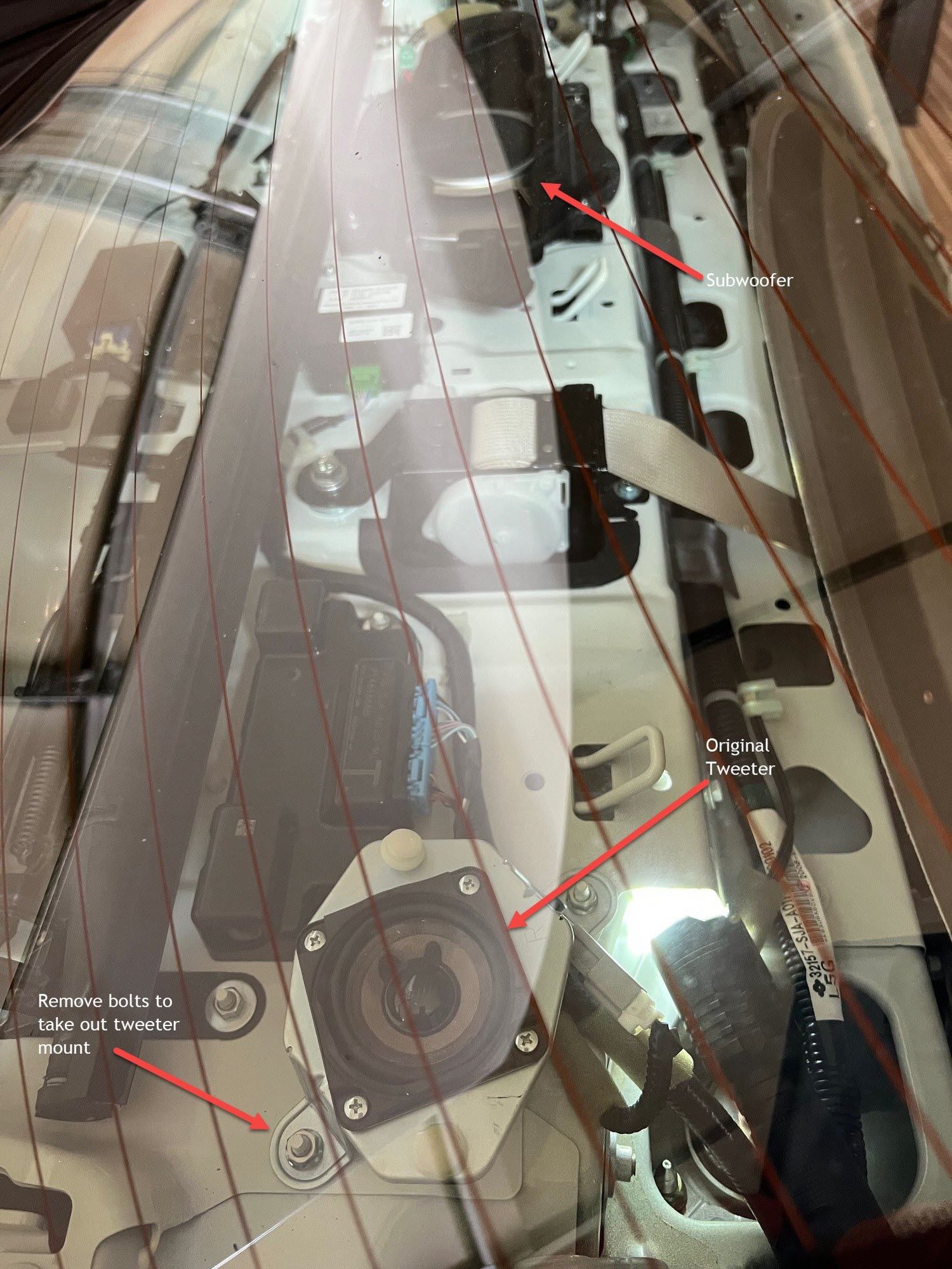

I first tackled the rear deck tweeters. I figured this would take the most time (it did) and I wanted it out of the way. The instructions from Crutchfield came free when you purchase the speakers from them (you can buy instructions for $10 online from Crutchfield – just google it), the instructions have pictures, wire polarity and required tools for each step. I would definitely recommend a tab pulling tool set (plastic), and in addition, a metal bar tab puller because you’re going to remove a lot of tabs in the car. You can find those tools at car part stores, on Amazon or other online places for around $15-$20.
After taking off the rear bottom cushion, you’ll see that there is a wire connector on the driver’s side by the back part of the seat cushion, so don’t forget to release that before taking the back cushion out and reconnect it when putting the seat back together.
The only tricky part of removing the back seat panels is the upper panel by the airbag. One clip slides out (closer to front of car as indicated by arrow) while all others pop out. This is not mentioned in Crutchfield’s instructions. I would recommend popping out all tabs, including those by the back window and then slide the piece back toward the rear window to get it out. Installation is reversed, slide the tab on first and then press other tabs into place.
Picture of rear deck with cover removed, yeah looks like a mess, but the parts were not in the way.
Picture of original rear deck before tweeter removal (above)

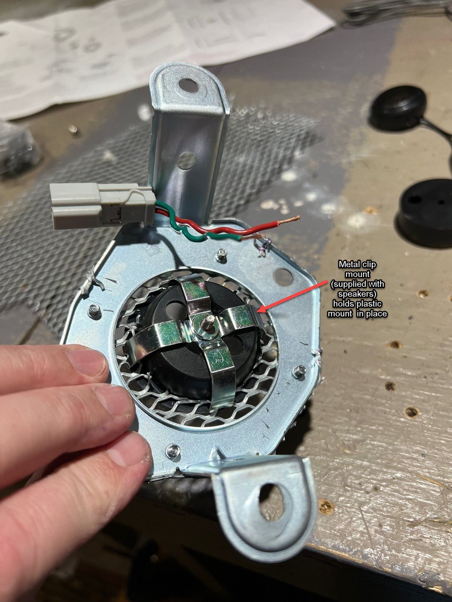

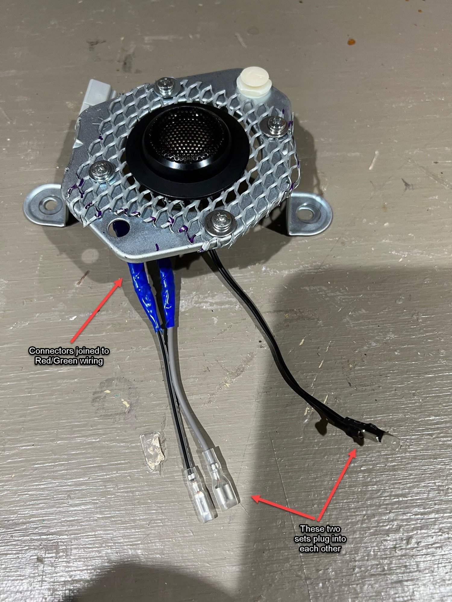

Once you have the old tweeters out, now comes the part that takes some time – trying to hand build a tweeter mount to fit in the old mount. I went through a number of iterations to try and make the first one work, but found that using a wire mess (used a gutter leaf guard mesh from Home Depot) and the Polk Audio flush mount together made it easier to manipulate and get the tweeter to solidly mount. Having some small wire clippers and needle nose pliers helps cut out the hole for the flush mount and allows you to manipulate the mesh wire to the right locations. The Crutchfield instructions do list the polarity (positive/negative) wires to use, though their colors were sometimes different. Below are some pictures of what I made.
While the rear speaker deck was apart, I ran the microphone wire for my HFL through the back deck while I had the back seat apart and ran it down to the USA Spec BT45-ACU unit where it plugged in by the XM radio unit (driver’s side rear in trunk).
Once you have the new tweeters installed, test them before you put everything back together. With the RL stereo, you can test just the rear tweeters by going into the RL speaker settings to select only the rear speakers (Fader), turn down Center speaker and Subwoofer in the settings, and turning the Bass all the way down (off). Once tested, put the rear seat area back together.

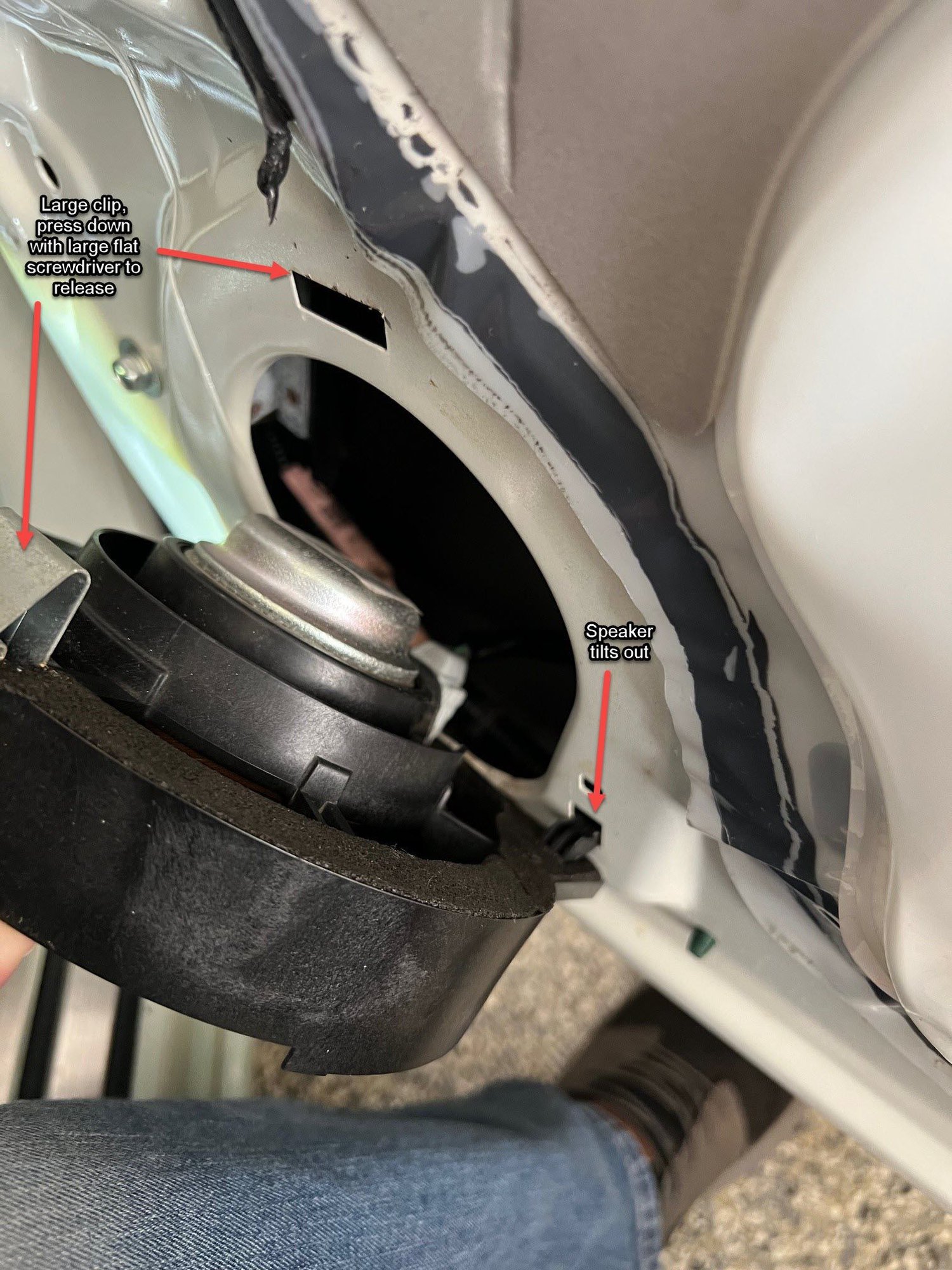

Removing the door woofer is fairly simple by inserting a large screwdriver in the top of the speaker mount and pushing down to release the clip. After that is released, the speaker tilts out.

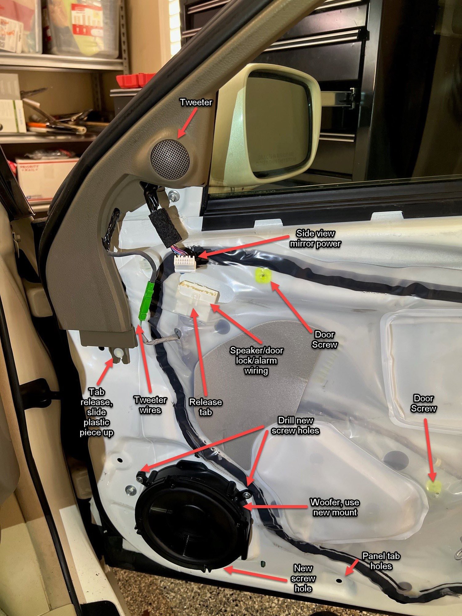

Front door speaker replacements – remove the front door panel by first removing the 3 screws (1 behind door handle, 1 behind upper plate by handle, 1 behind plate in the door map holder area. See youtube shown earlier. Don’t forget to remove the door lock mechanism 3 screws. In addition, there are 2 sets of wires you have to disconnect on the door panel, 1 for the rear-view mirror power (smaller white) and 1 larger white one for the speakers/door locks/power for light. Both have a release tab and you have to find the plastic tab/bar to push for them to release before pulling apart. The white plugs have the release in the middle. The green (tweeter) wire can be released after the door panel is off, and it has the release on small thin protruding tab that I had to use my thumb fingernail to press in to release it.
After the door panel is off, remove the tweeter trim piece that goes all the way around the window area. There are 2 tabs (1 each end) holding it in place where you can actually slide the trim piece up instead of popping out the tab. The rest of the trim piece is held in place by the door seal, just pull it back to release the trim.

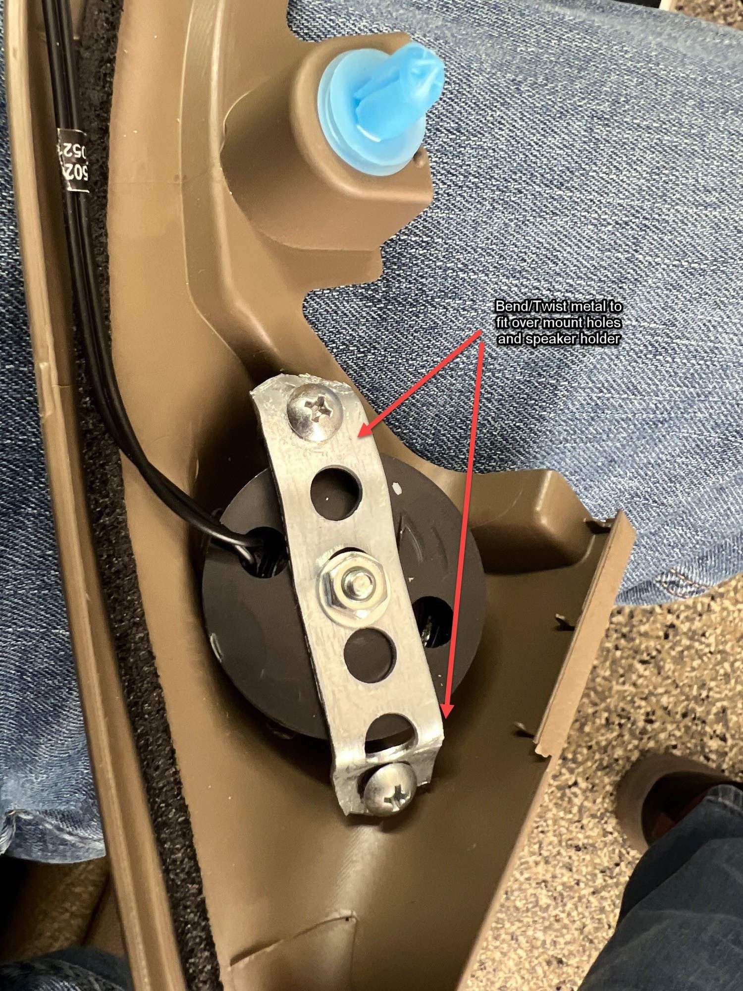

I first replaced the tweeters. Just like the rear, the first tweeter took the most time to figure out how to mount it. This time I used a small, perforated metal bar which aligned above the original mount holes (once you twisted/bent the metal in various ways) and also allowed for attaching the raised mount tweeter holder. Make sure the tweeter is pointing in the same general direction as the original tweeter and that the bar does not get in the way of putting the plastic door trim piece back on the door (I had to round out the corners of the metal bar). Polk Audio gives you flush mount for the tweeters which I used in the rear tweeters and a surface mount (raised) which I used on the front tweeters.
The woofers were similar to the rear doors, but different in the fact that you had to use the 2 sets of mounts that came with the speakers (a thicker door mount and thinner speaker mount that screws to the thicker door mount). You also have to drill holes in the metal door panel (3 of them) to mount the thicker speaker mount. Wiring came from Crutchfield, same as the rear speakers.
Once you have the tweeters completed, reinstall the tweeter/door trim piece and reconnect the wire to the green plug. You can test the tweeters before putting the door panel back on, but woofer won't work unless you plug in the large white door panel plug.
When putting the door panel back on, attach the door lock mechanism first while resting panel on your Home Depot bucket, then plug in the 2 white wires (rear view mirror power and speaker/door power) and finally, attach panel starting at the top and working your way around door tabs. If you did it right, you should see the screw holes aligned over the green screw holes.

Used metal bar by twisting/bending metal to mount tweeter
