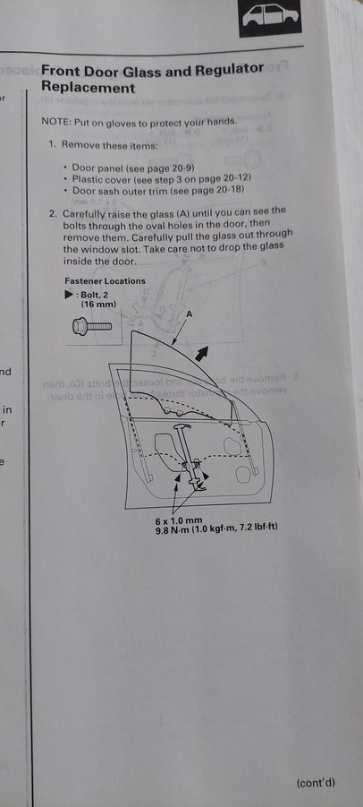

here is an mdx regulator replacement, it may be helpful.

Originally Posted by Jut
If someone could confirm that the actual service manual would cover the glass in the doors, it would be really helpful. I just don't want to buy it to find out that it doesn't.
That help? It's why I like the hard copy over the digital version every time...you can probably use the chapter references in the digital version to find all the pages...

Thats perfect, thanks so much. I really appreciate all the help from everyone
