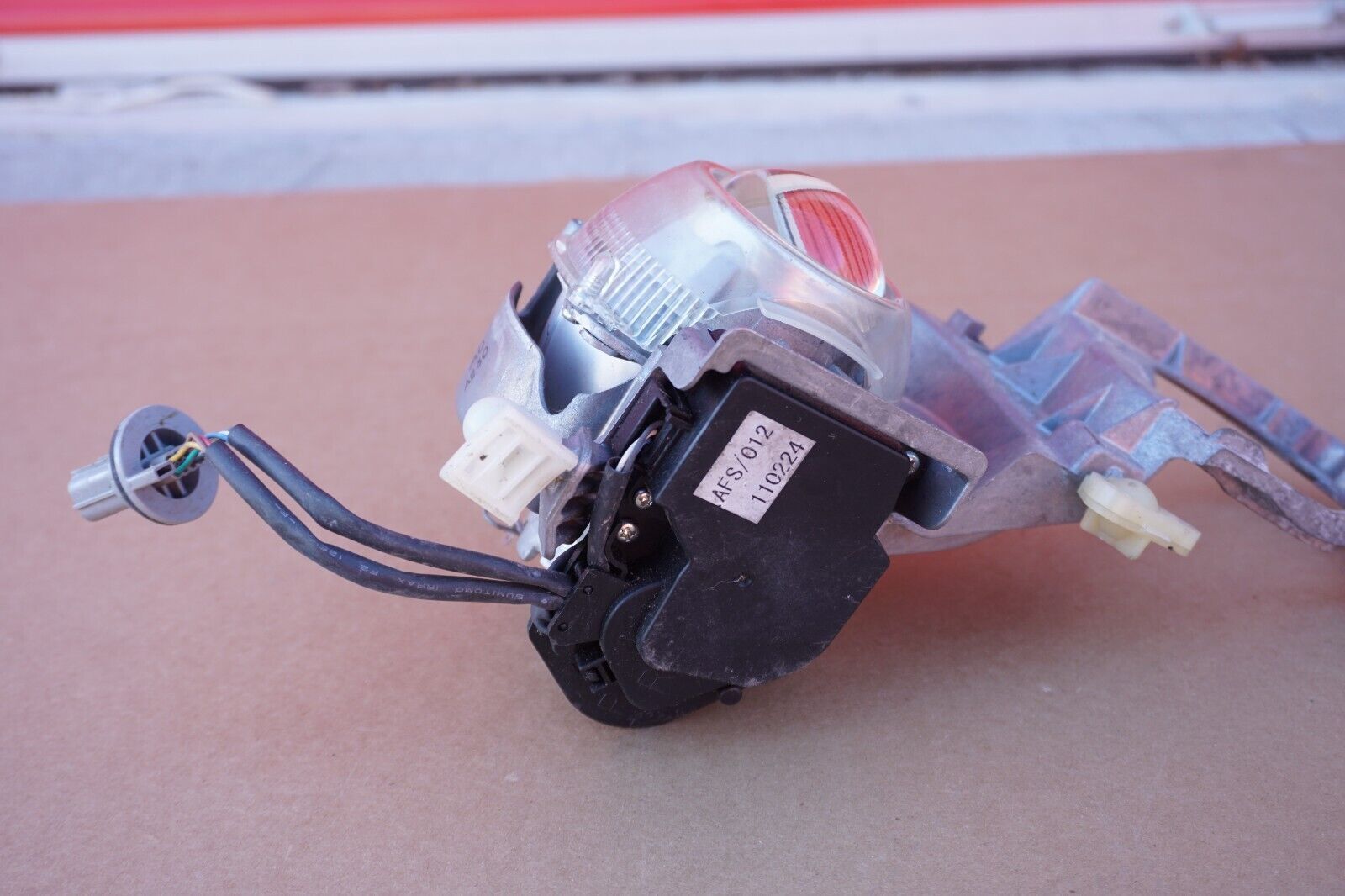

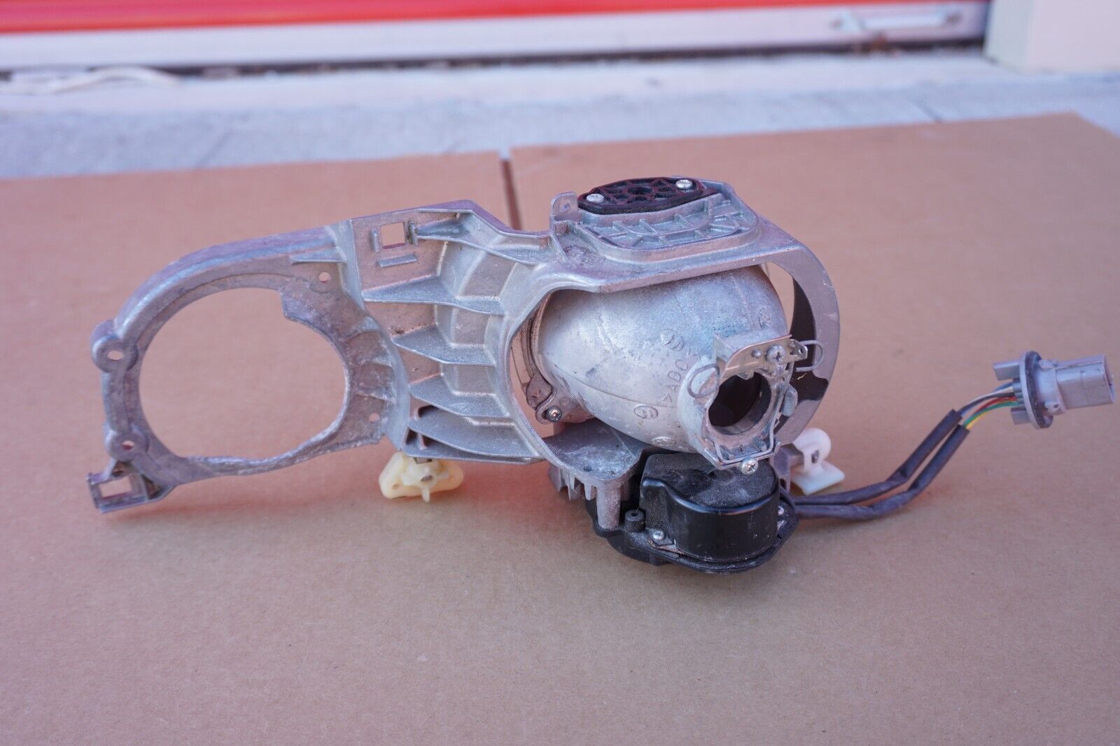

For a start! Yes or yes I will have to open the headlight, since I plan to install Angel Eyes on the headlights anyway.
1. When I open the headlight I want to see the Low Beams projector and disassemble it and see the chrome interior to see if they are burned or discolored, if they are in those conditions, I think that is where the problem would be, so I have an idea for that : and it is to see who in my country can do vacuum chrome plating and try to recondition them and, incidentally, buy a set of HIGH-PERFORMANCE CLEAR LENS UPGRADE 2.5 in: TSX-R and install them.
And in case the chrome of the projector is not burnt or discolored, then I would only change the Lenses
2. The other idea was to change the Low Beams projectors, after searching so much I fell in love with the Morimoto D2S 5.0 (First image), since I liked the light cut it has and the wide lighting it can give and more with my HID 5000k 55w . But it turns out that there is a problem and that is that after seeing photos on the internet of the support of the low beams with AFS and high Beams of the Acura RL 05 (Second image), I noticed that the original projectors have a tip metallic that is inserted into the AFS and that allows it to rotate. Apart from that I think that the morimotos are bigger and that I won't be able to use the AFS with them.
(First imagen):
(Second imagen):
Although looking for ideas it occurred to me to create a metal base with a metal tip just like the original one to be able to adapt the morimoto and be able to use the AFS, but so far I'm not very sure (if someone has already done this adaptation before, can you tell me if does everything work fine?).
3. I already mentioned in #2 that I was thinking of changing the low Beams projectors, but I wasn't sure with the Morimotos, in case I didn't choose Morimoto, I'm thinking of taking the original projectors and removing the part back: Internal reflector, light cut output sheet and adapt one of another projector that can be almost similar and create a base metallic to join the new back part: internal reflector and light cut output sheet, with the original front part: Lens and AFS.
4. And the one that I really don't like at all, is to buy other fucking headlights, but I suppose that if I decide this one I will have to fight for a good price and it will show me with photos and videos, the cutting and the output of the light to see if they meet my expectations.
Those are all my Options.
In case I decide on #3, do you know which projector I can use for this job? I'm looking for something that gives me this light output:

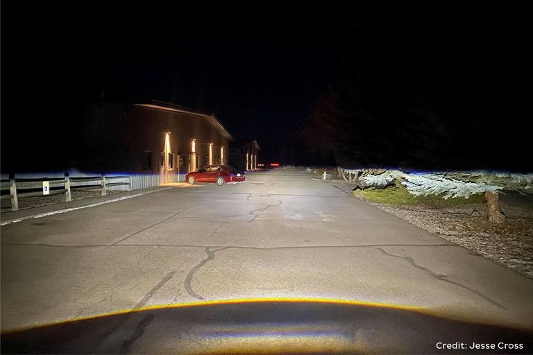

This guy has a lot of (pardon the pun) illuminating advice, which you'll find at this link, his own website and elsewhere. I urge you to read him.
https://jalopnik.com/why-most-led-he...-ex-1843070472

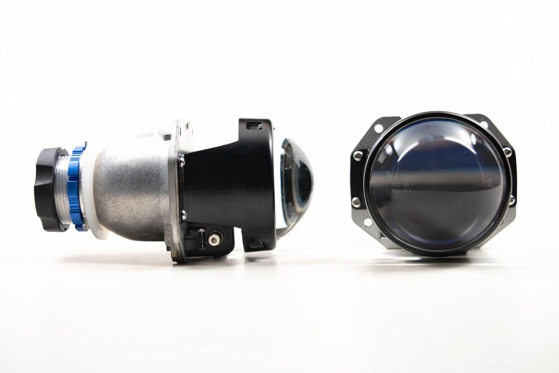

Here an example:
Here a photo:
These are the original Acura RL 05 06 07 Projectors but with crystal clear lenses like the: TSX-R.

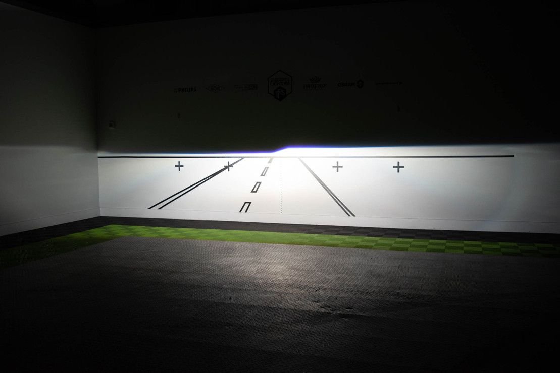

I am seriously impressed by the amount of light in fact. It has a good cutoff and great light output.
You can't even tell the difference with the Morimoto d2s 5.0:
They are practically almost the same, if they are really the original Projectors of the RL, I suppose that the money for some new headlights would be worth it if that is the result.

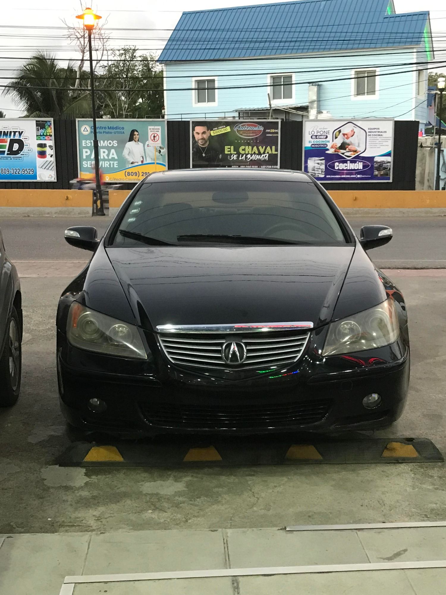

As I mentioned before, I have decided to change the headlights, but before I will disassemble the headlight, just to make sure that the internal reflector of the projector is not discolored or burned, in case it is not, then I would simply buy some TSX-R Lens, would polish the headlights and use liquid polymer vapor. But if in the end they are burned then I change the headlights.
here a photo of the RL:

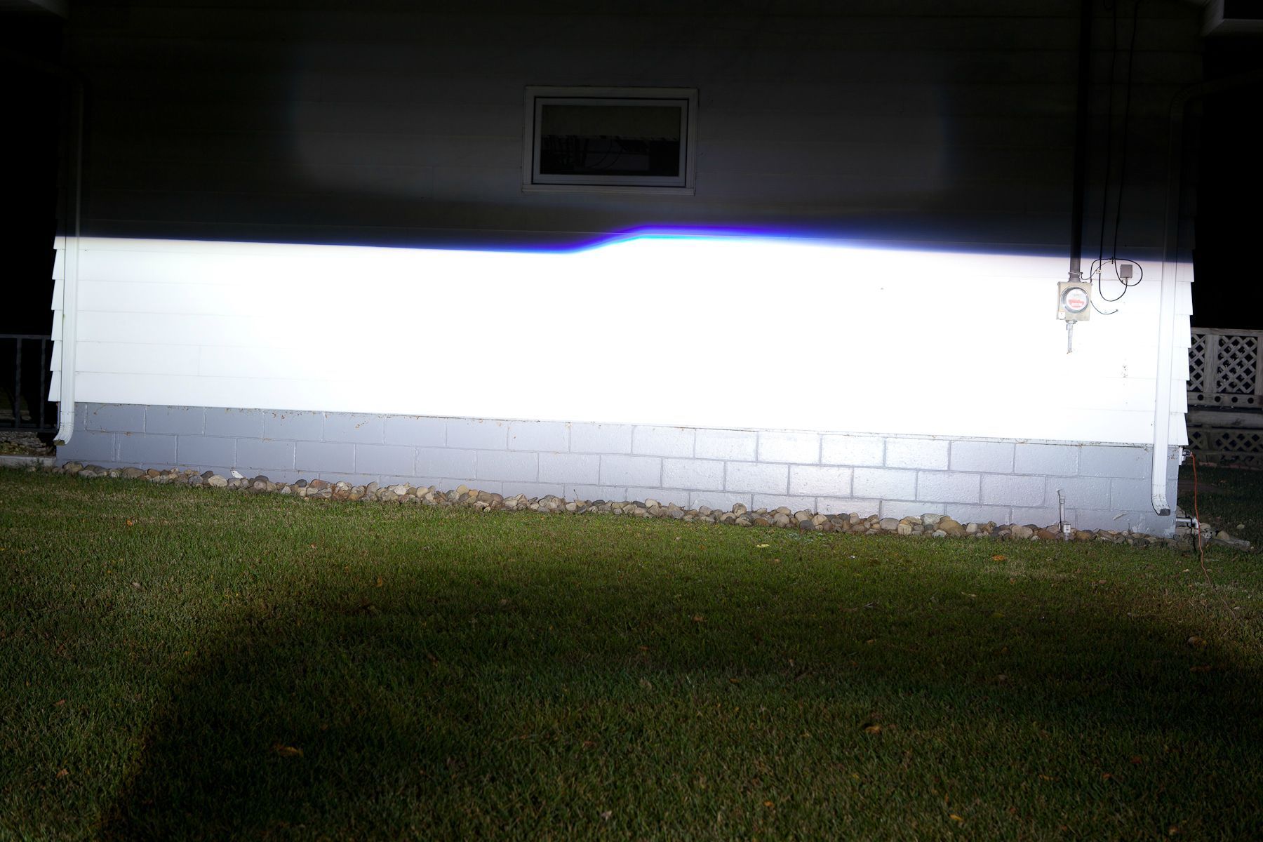

Great looking car my man, I am telling you its the windshield tint thats messing you up.
I dont think you are going to solve it with any light solution, but I am 100% here for the journey.
A good way to measure how much light you have and the "spread" is to park it in front of a white wall or a garage door at night and take a picture of the light on the wall.
You can google this for examples. https://www.google.com/search?q=HID+...hrome&ie=UTF-8
That will help you baseline what you have and after each upgrade you can go to the same spot for a picture and compare

Hard to tell from the photo, but do your headlights have frosting on the plastic cover ? UV light from the sun slowly yellows and fogs the clear plastic over time. I've had great results with this kit -
amazon.com/CERAKOTE-Ceramic-Headlight-Restoration-Kit/dp/B084RQKLV8/ amazon.com/CERAKOTE-Ceramic-Headlight-Restoration-Kit/dp/B084RQKLV8/
- have a read of the reviews for some awesome before and after photos !

The lowest you can put on headlights like that is HID 4300K. But if you want, you can retrofit those headlights and install Morimotos 5.0 DS2 projectors or ones that can be well adapted to the input of your headlight bulb. In case your bulb is H4 type, you can look for some on ebay or anywhere. But I will tell you that the result would be Wonderful, The LED Bulb would be better used or you can also install HID, you would have a Clear cuttoff line and best of all you will not bother other drivers.
here is an example:

Originally Posted by Nomgle
Not trying to be rude but, that photo is a terrible light pattern - you're just making life really uncomfortable for everyone else on the road
Unfortunately for old-school reflector headlights like those, there's simply nothing you can do to make them "good" without hurting everyone else. Projector headlights are the only way you can seriously increase light output on an older car without causing massive glare.
Indeed.
The only problem I had with my Prelude was that the projector headlights lost the levelling-function that comes on Euro-spec cars. So if the boot were fully-loaded, I'd dazzle people in the slow lane. Otherwise, almost OEM standard.
Since the RL already has projectors with motors, maintain them correctly, don't ditch them.
