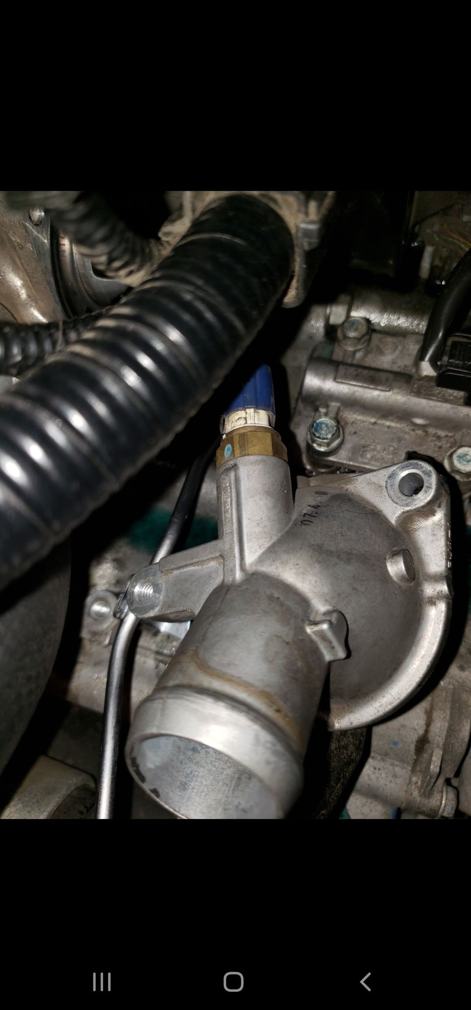

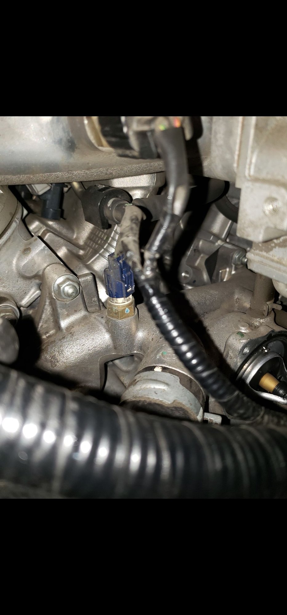

What part number did you replace? I changed out my radiator recently and also replaced the temp sensors. There is no temp sensor on the radiator for my 2008 Acura RL. The two sensors located in the thermostat housing and the other is nearby. see my photos below.

I used pn 37870-RTA-005 that deepa1600 gave me i replaced the 1 up by the thermostat back while I was at pepboys before we got layed off
