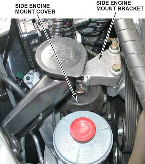

Was going to check fluid, but car is still hot right now. Is the powere steering reservoir at front of engine compartment on passenger side? If so, Have to take some plastic off to get to it.

should be on the passenger side by the washer jug

Just checked power steering fluid level. Pretty low.

So there is evidence that the pump is leaking. They topped it offf and the sound disappeared on drive home.
