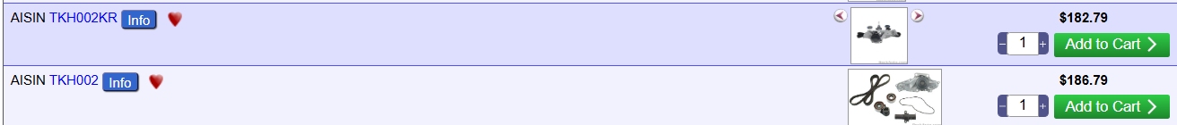

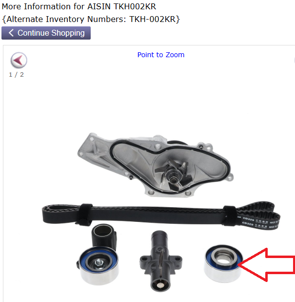

The two Aisin kits (same fitment for your 08 RL) below from rockauto are a good choice to save $$ over OEM components; however, looking at the two pictures and the price intervals, the only obvious difference is the color of the pulley bearing 'rubbers' & maybe the belt markings?
The kr is Korean. He should get the other one (Japanese)
