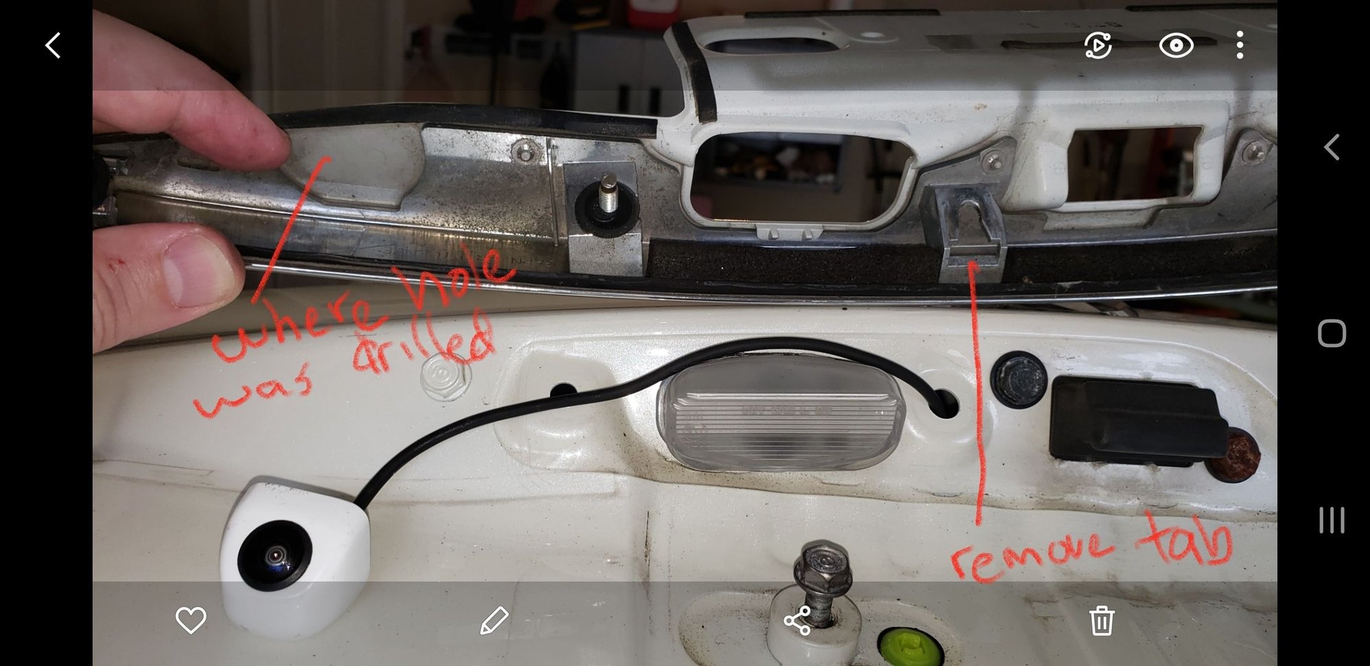

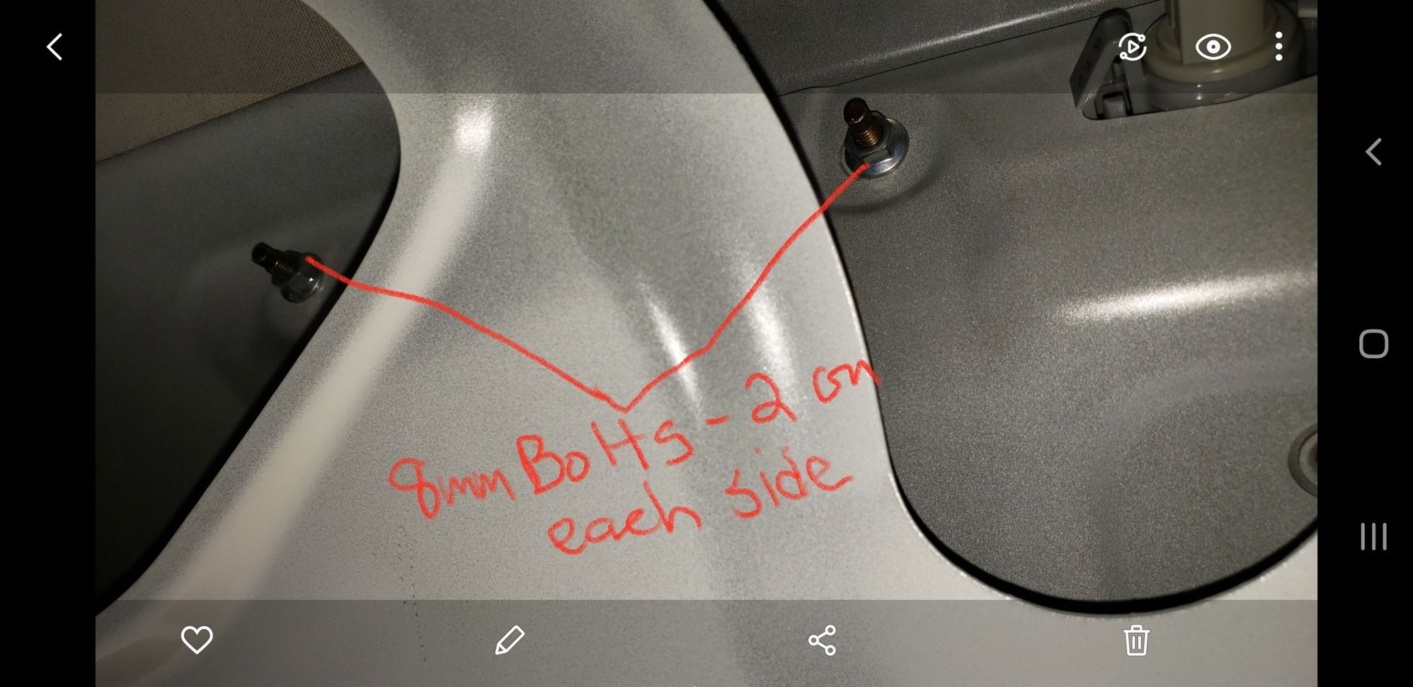

Next, figure out where to mount the camera. I had to remove the trunk lid liner, which can be done in about 5 min. There is a youtube on how to do it, look for a way to replace your license plate lights, which by the way, you might as well replace them while you have everything apart. By all means, use a trim removal tool (I bought an orange set years ago) or you'll bust those simple white tabs.

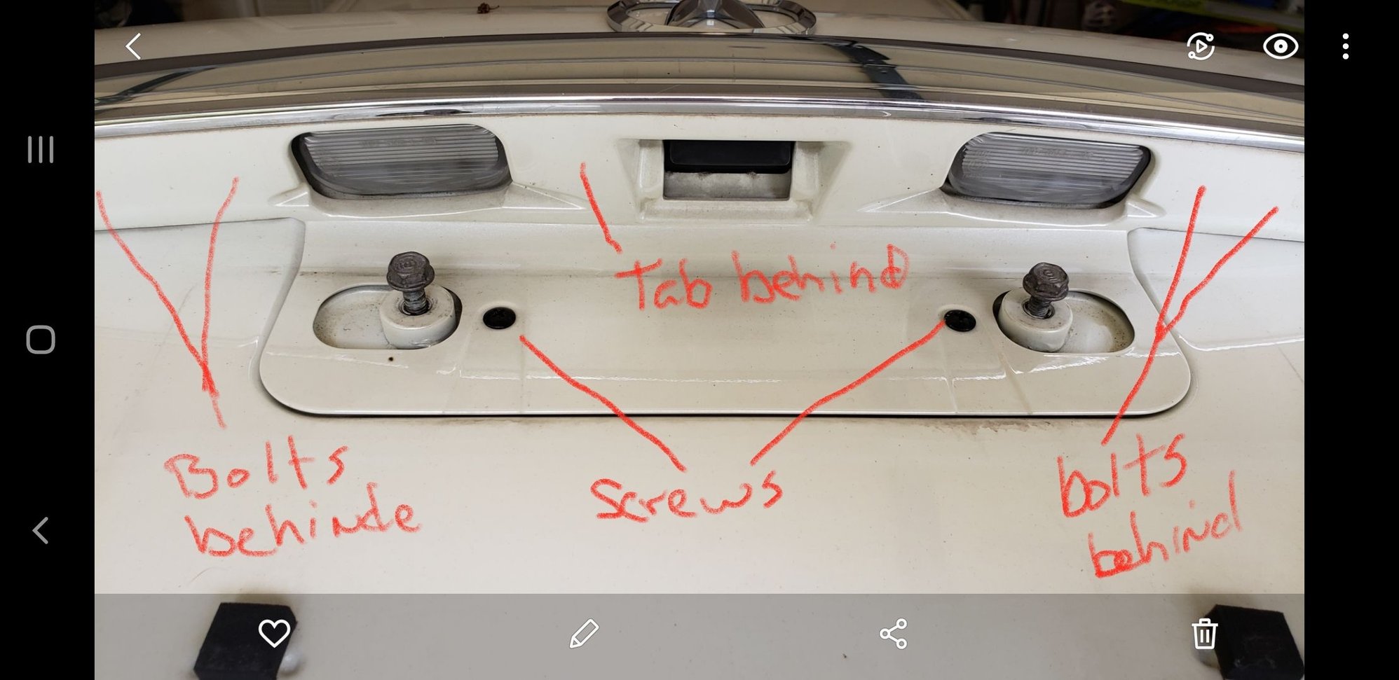

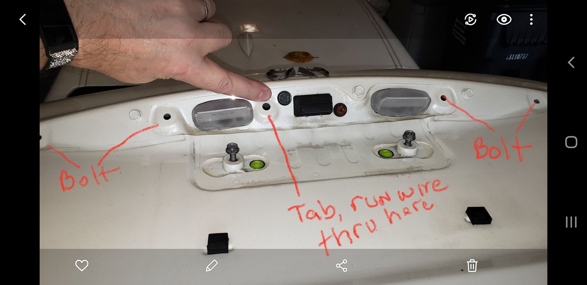

This is the license plate trim piece you want to remove once you have the trunk liner removed.
The 2 screws and 4 bolts are easy to remove, the plastic tab was a little difficult at first, but I found using needle nose players and pressing in the 2 sides released it.
Once you have the trim piece release, it should look like this...
This exposes the hole where i ran the wire through the trim piece, which is where the tab was located.

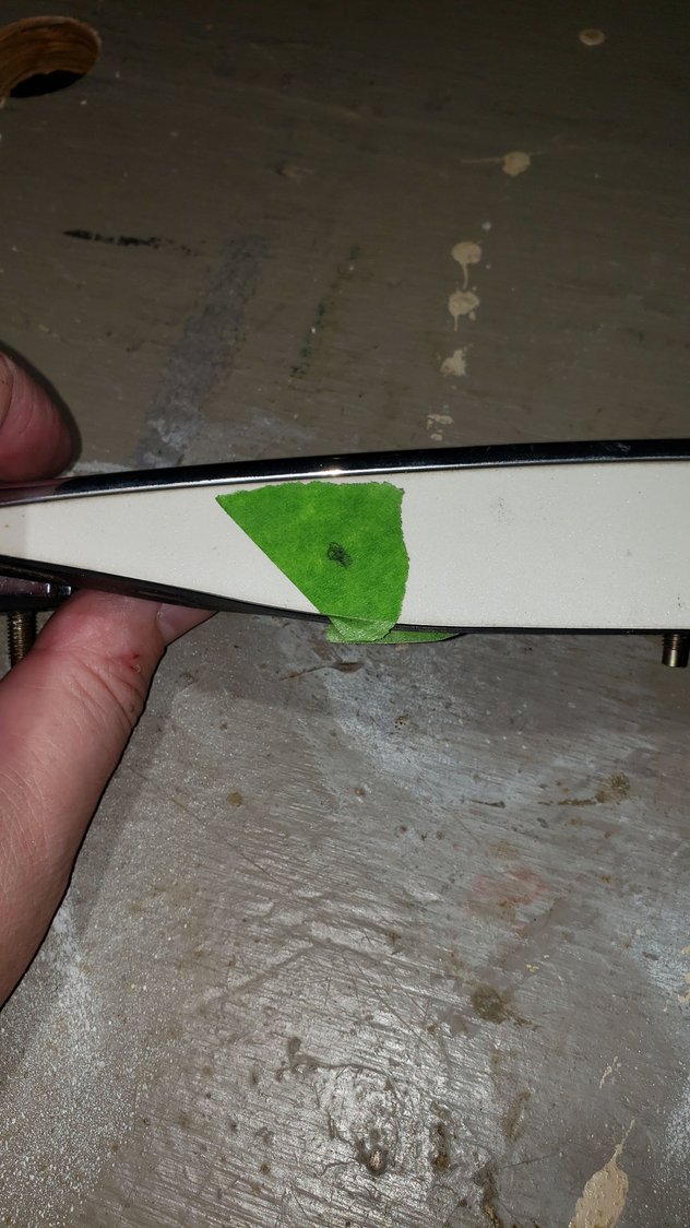

Next step was the final mount. Since the license plate trim is plastic, it was easy to drill and no worries about rust. Cover it with tape to prevent splintering, mark your hole and drill.

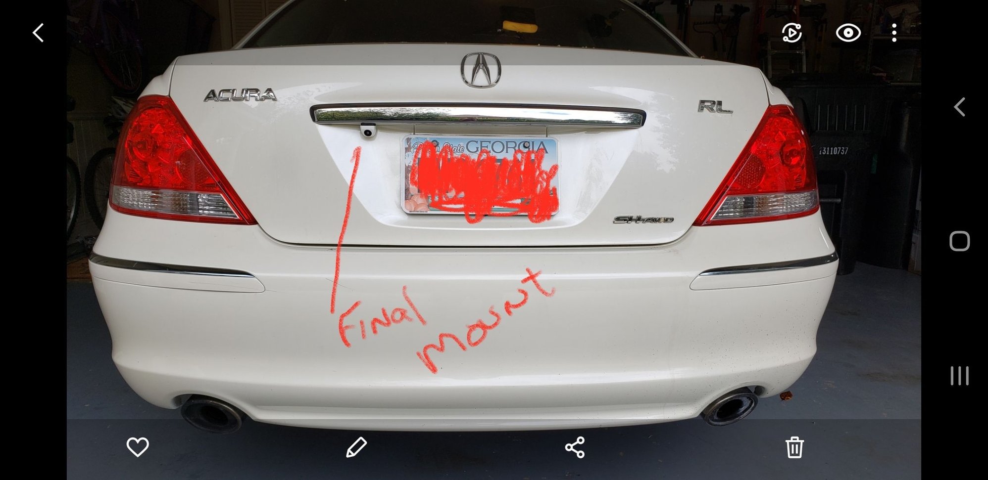

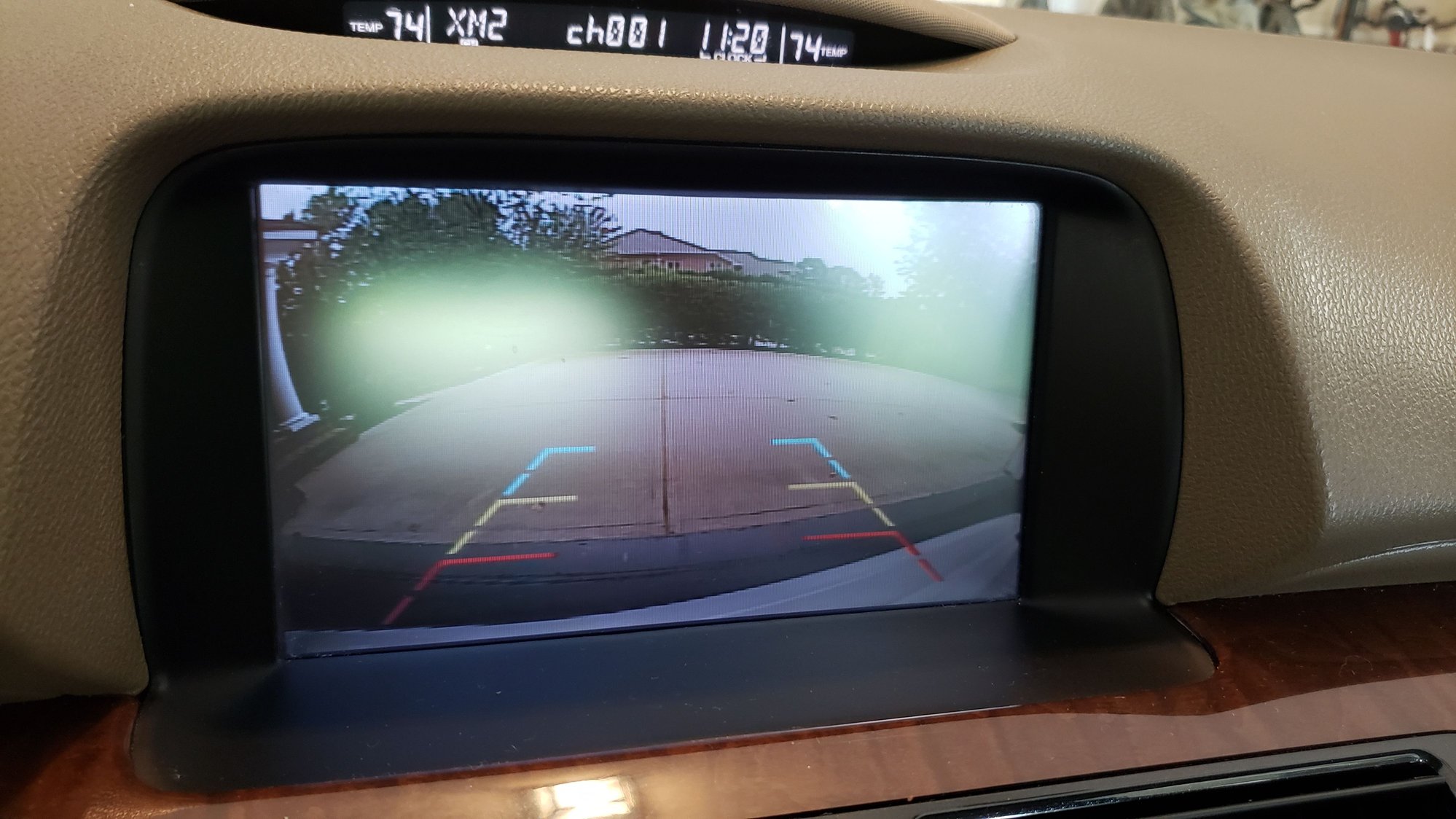

Next, I used the 3 degree angle piece included with the camera and the base mount piece to give it the proper angle. Again, I tested this before final mount by starting car, putting into reverse and viewing.
Here is a picture of the backup camera on the dash, pardon the glare, it was sunny 🌞.
Works great!

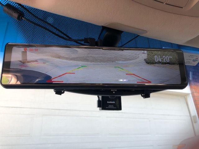

Nice! I just recently added a back-up cam to my 2nd gen RL as well. I went a different route and added a rearview monitor display which doubles as a dashcam. Also, really helps with the blindspots!
