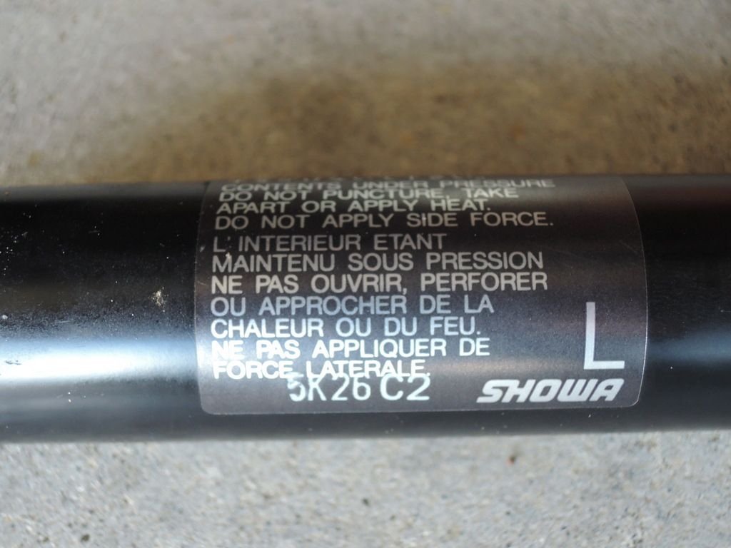

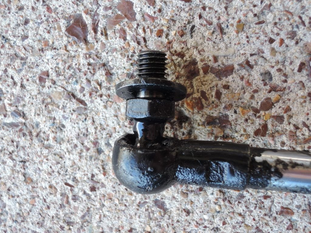

my 05 RL had "Showa" struts that had non-removable studs. to re-use the studs you'd have to cut away the socket, that's probably not something most owners would want to do. see pictures below.
those pictures technically came from this forum https://mechanics.stackexchange.com/...-have-a-c-clip the 2006 Honda Odyssey has one side just the non-removable stud and the other a stud with bracket, while on my 05 RL it was just the non-removable at both ends.

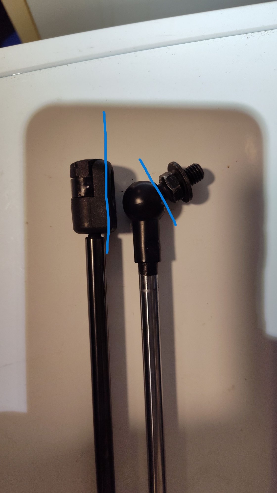

The TuffSupport 618461 were the correct length, but they did not work because the end socket that mounts to the hood is not angled (see photo). This prevents the clip from snapping onto the receiver ball. The ball studs I used were Stabilus Lift Support Hardware SG900001 (from autozone).

I then installed the new socket studs, first snapping the cylinder end in place at the base of the windshield, and then trying to snap the rod end onto the new socket stud under the hood. And that's where it became clear that without the angle, the replacement hood support would not attach. It also did not work if I first snapped the rod end onto the hood because then the cylinder end would not come close to the socket stud at the base of the windshield.
