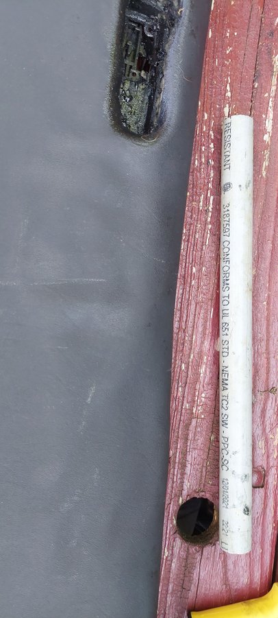

So I bought a sheet of kydex to recover my glove box and I'm planning it all out. Want to start in the latch area since it's the most complex thermoform, and cutting around the edges will be much easier with it as an anchor point However. I know that if I just formed it straight it would cause the latch to bind due to the tight clearances.
So I need to find a way to cut a straight line about 1/4" on top bottom and left side of the latch to account for bend radius (right will just form along the existing line since it's a pocket anyway), but I'm not sure how I can cut it to achieve a straight line. I can't use a saw because it's a shallow bowl and all that funky crap is gonna make it hard to cut straight with a box cutter or hobby knife. I figure a Dremel will just clog up within seconds.
I had thought of possibly just rubbing the gunk away with my fingers, but there's no way to guarantee a straight line. Kydex generally thermoforms to the surface you're molding it to, and I want clean straight lines after this is done because it needs to conform to the latch. I can calculate the bend radii, but I need to be able to make exact cuts to make it look good after.
Anyone got any ideas of what I can use to cleanly cut through this stuff to achieve a straight edge all around? The divot on the left is where I tried to roll it, unfortunately unsuccessfully. The smear on the top (left in picture)is where I tried to flatten it after trying to run the gunk off and away, also unsuccessfully.

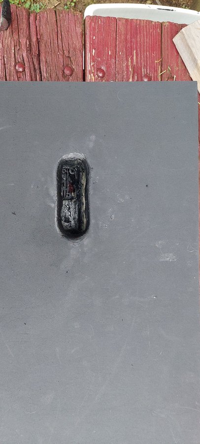

Ok, update while in progress, letting the kydex cool a little before I make another pass...
I ended up using a cheap harbor freight Dremel with the cutting discs. They worked quite well, only broke two cutting out the shape. Best part is I was able to cut the straights with them and then use them to grind out the cavity a little. You'll see why this is necessary momentarily.
Got it all cut out, looked like crap but the lines were straight. Started work with the kydex...got a 24"x24" sheet from Amazon which is plenty to cover. I cut the cavity edges back about 3/16" to allow for clearance issues with the Dremel and ground the side walls smooth.
Because it's the most complex part, im starting with the latch cavity and will cut the kydex to fit the rest of the lid after that's perfect. Keep in mind, as you'll see, the kydex comes in textured flat black, so you will need to paint after (prime first then I use krylon fusion satin or matte black because it's perfect for plastic). I started by cutting a center line horizontally to about 1/2" from each side of the cavity. I cut a vertical cut in the center line just a little on the NON LATCH SIDE Then I cut the LATCH SIDE ONLY off to about 1/2" from the edge(bottom pic) for clearance purposes on the latch.
Having lined up the wedge cut on the left(top) side to the edge of the cavity on the latch side, I used a heat gun to melt the kydex to the point where it JUST BARELY starts looking shiny in spots. Then I used a small teaspoon to begin forming the cavity. Don't worry about it being perfect at the bottom of the cavity, just focus on getting as sharp a bend as you can and smoothing it along the side walls of the cavity. You can melt a piece in on the non latch side later to fill in the bottom of the cavity if you want it to look perfect when you drop your keys and look up.
Don't worry about smearing the plastic a little, as you can smooth it out by using the spoon like a paintbrush, and sanding/painting will hide the rest.

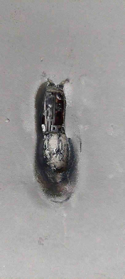

Ok, moving forward since I'm waiting for primer to dry. We left off with the rough formed opening for the latch cavity. At that point it doesn't need to be perfect because you're gonna have to improve upon it later anyway.

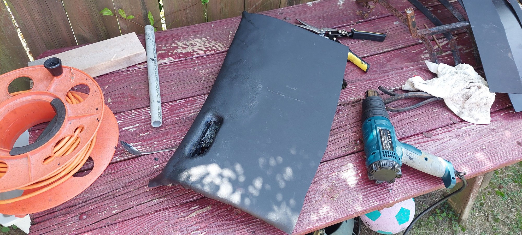

I started after this point by thermoforming the overall shape of the box. I started by using the heat gun slowly and evenly across the entire surface of the material until it essentially started to drop into place by gravity.
It's important to start around the cavity and work your way out, in the same way you would if wrapping vinyl or leather...slowly moving and removing the high spots. To help with this process , I used a piece of old PVC pipe as a rolling pin and also wrapped my gloved hand in a thick old sock to help smooth things out by hand.
You're gonna have ripples and low spots. I found that one of the biggest causes of this is that the gooey stuff melts underneath and forms high spots...you can use the rolling pin to smooth most out and press the others in with your gloves hand if that doesn't work.
Working on this shifted my cavity cutout a little, so I used a 2x4 both to hold the piece in place, and because it helps to form a perfect edge on the inside of the cavity.
Once I had the general curvature of the piece down I started working over the top curve to the edge, both because it's the more complex curve with its drastic angle and because it helps to anchor the piece once you've formed over the edge.
To form the edge I heated it in sections and used the rolling pin to flatten and hold it in place until the plastic cooled and set in. In some cases where I wanted it to roll over I used my gloves and besocked hand to make the more complex and sharper bend.
I found that starting with the top gave best results and then stretching and rolling it downward toward the bottom. For the corners it got a little hairy. In some cases I made relief cuts in others I just heated and rolled over, depending on how important the corner is. The top and bottom are not as crucial as the sides on this piece.

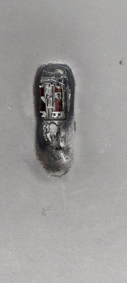

If you stick out too much on the sides on this piece it will catch and the box will have difficulty opening. Knowing this I prioritized the more smooth surfaces to be on the sides, with the excess mostly on the bottom where it will never be seen and some on the top, which is only seen when you open it. As you see in the pics, you will have to heat and reheat to get it perfect..
Once you have the top and sides worked in you'll have to spend some time working bulges, ripples and high spots out with the rolling pinand your gloved hand. Unfortunately since it's a PVC pipe it melted a little and left gray spots...fortunately I planned on having to paint anyway.
When you get done and everything looks manageable, don't forget to check the fitment of your latch before moving forward. I'm ok with the fit of mine so far. In the cavity I'm going to backfill a little bondo or just some silicone sealant just to get it to look smooth before I paint it all black. Thinking I'm going with matte black krylon fusion because I want to throw some clear coats on after to protect the finish without being too shiny. So it'll be two coats primer, three of the matte black and four of the clear. You're seeing this after the first light coat of primer.

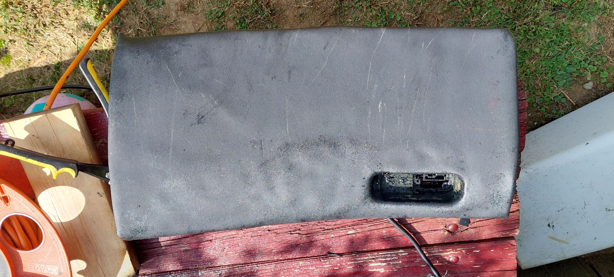

So I hit up the junkyard and they actually gave me my new project piece for free:
This one's in even worse shape than mine originally was, but hopefully that'll make it easier to strip that gunk off...seems like I already stripped a little off carrying it up to the counter:
Anyone have any good ideas on how to strip the gunk off without hacking up the foam underneath? Its acting like butyl rubber so I'm hoping some good off might work. If not I might have to take it all off and cover it with some form of heat resistant filler.
