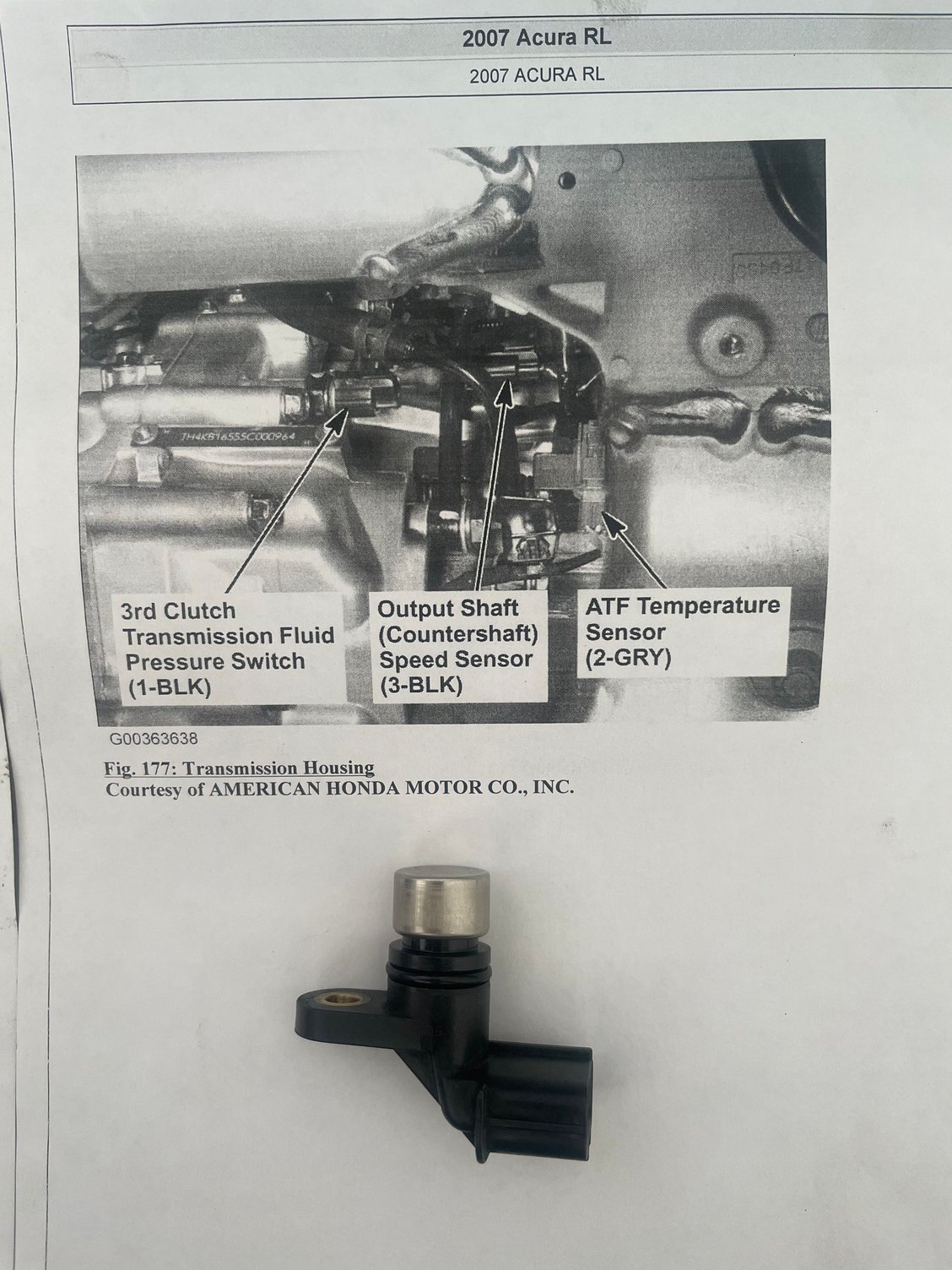

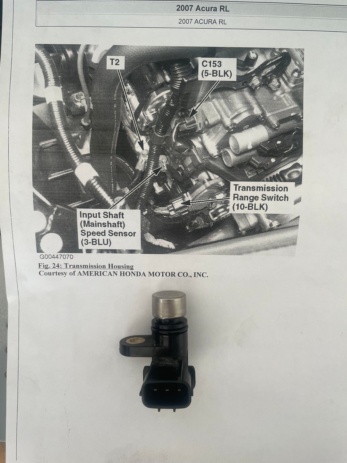

The parts diagram shows that the sensor closest to the engine is the Output Shaft Sensor (28820-PPW-013) and the farthest is the the Input Shaft Sensor (28810-RER-004)...#17 and #15 shown below.
The manual shows them in the following pictures....note that the pictures states the connector colors for each (BLU is for the Input Shaft Sensor and BLK is for the Output Shaft Sensor.
Note the actual sensor has the bolt hole straight up.
Note the actual sensor has the bolt hole to the side.
So, I think in the manual pictures it states that the Input Shaft Sensor takes the blue connector and the Output Shaft Sensor is the black connector is wrong....
The Input Shaft Sensor is the one with the bolt hole to the side and placing it into the hole closest to the engine contradicts what the parts diagram states because the Output Shaft Sensor is the closest to the engine.
