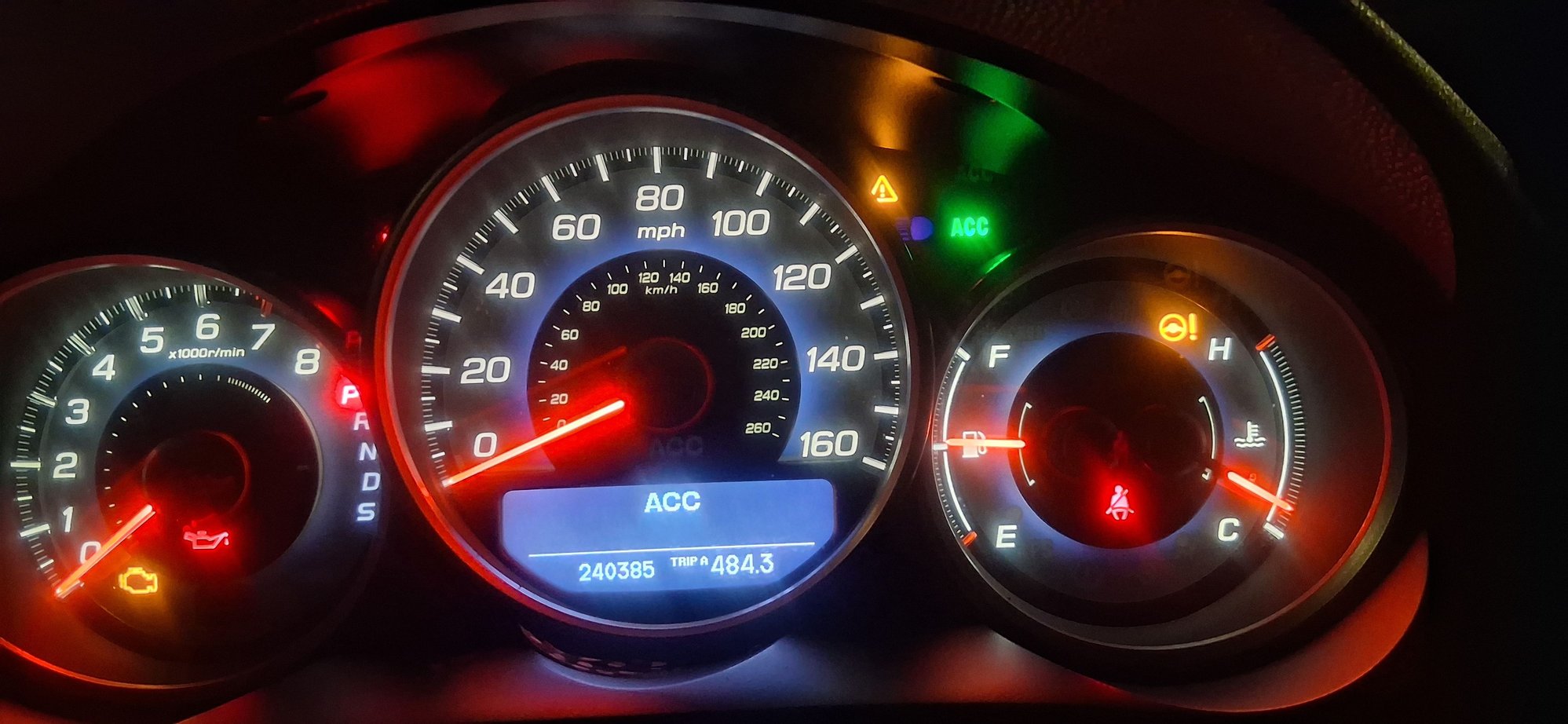

My 2010 RL suddenly started having these codes pop up. It started last week as I was on the freeway going to work. Wasnt having any problems before that except having to change the starter due to car not starting 1 day and my brakes were lightly sqeeking so I had front brake pads changed. No problems other then those that I was aware of. I also didn't hear any unusual sounds or have the can do anything abnormal while driving prior to these lights coming on. My mechanic friend changed the 5th cylinder spark plug and coil. Still nothing changed and codes are still there. DOES ANYONE KNOW WHAT IS GOIN ON OR HAVE HAD THIS ISSUE THEMSELVES. What do I need done to have these lights go away and that will fix my car so it doesnt have these lights coming on dash.

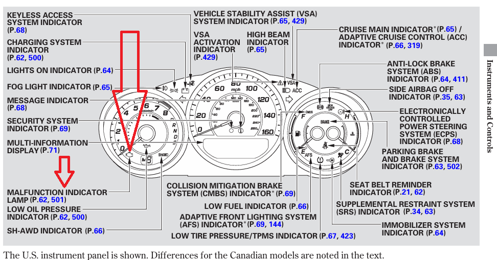

The picture above does not show the left side of the instrument panel.
With that said, if the malfunction indicator lamp 'engine' symbol (red arrows) , on the left side instrument panel, comes on & stays on, the engine computer is throwing diagnostic trouble codes for current potential issues with the car....

There is the complete dash view

It appears that the engine is not running because the left most gauge (tachometer) is at 0 rpm.
If the yellow 'engine' symbol (green arrow) continues to illuminate AFTER starting & running the engine while driving the car, there is a high probability that the engine computer has thrown one or more DTC(s) that need to be read / recorded / researched as explained above.
