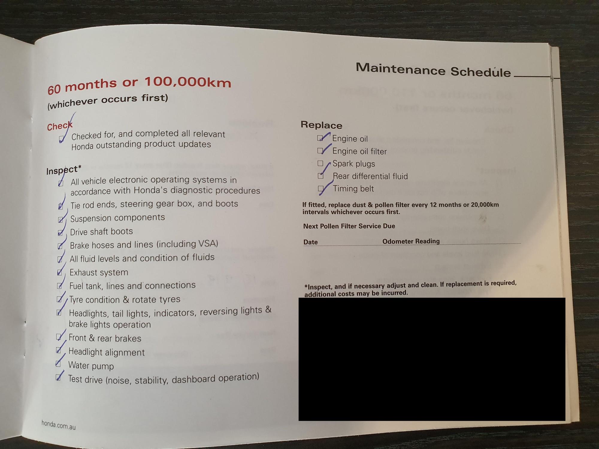

My '08 RL is approaching 110K miles and the transmission fluid's never been changed. I checked the owner's manual and it said to change it when the MID gives the indicator that maintenance is due. However, my local mechanic said it should be changed every 100K miles or so. Should I go ahead and change it or am I good waiting on the car to notify me?
Are you missing the second book in the owners manual set, the maintenance and service guide ? The precise service items and mileage/age for each is listed in great detail - it tells you exactly when you should change each fluid etc.
If you haven't been following this, you've probably missed a whole bunch of other things too
Here's what the 5 year age page looks like :
