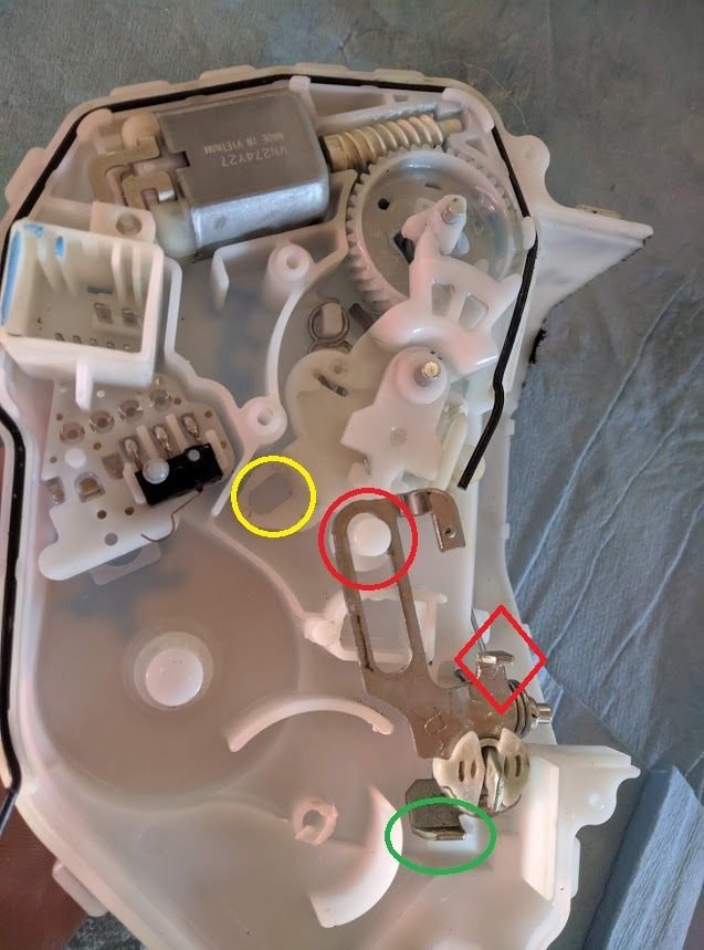

I believe I messed up when aligning the components that control the door lock (see pic for reference).

Let me begin by illustrating how these actuators work:
These actuators lock the door using a clutch style system where it can engage or disengage a bracket that makes contact with the actual latch.
The yellow circle is what controls the locking mechanism. You can see it here in the locked position. When the motor or the cable unlocks it, it shifts the plastic to the right and it is able to engage the latch (red diamond).
(The driver's side door has an additional provision that allows you to manually unlock the door using a key)
The green circle is what is engaged by the outer or inner door handle and moves the metal bracket up regardless if the door is locked or unlocked. If it is locked, nothing happens; If it is unlocked it will engage the latch and open the door.

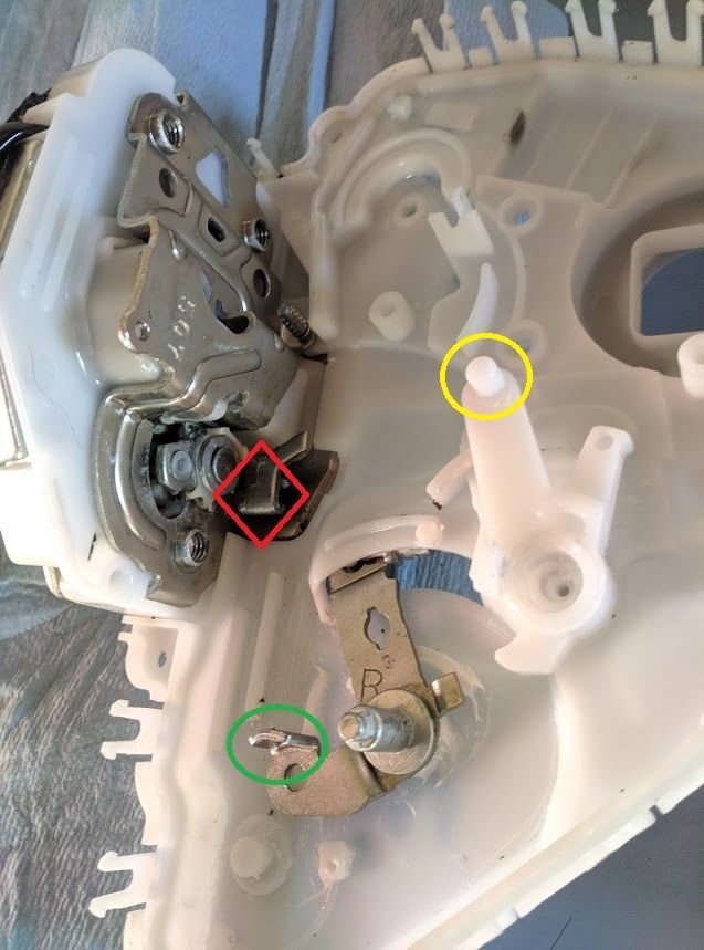

Here's the other side of the actuator so you can see how everything connects.
(If assembling your actuator, make sure the yellow circles are connected to each other, the part circled in green on pic 2 is UNDER the part circled in green in part 1 and most importantly, that the bracket and locking mechanism circled in red are engaged)
Now my problem: The ever so important connection of plastic to metal circled in red in the first picture was completely disconnected (hanging freely to the left) which resulted an inability to ever engage the latch.
Solution: Since the lock uses a clutch style locking system, all I had to do was get something to lift on the part of the latch with the red diamond and that would open the door.

The blue box is where I drilled my hole with the hole saw:
(The purple box was made before I knew exactly how the actuator worked when I was under the impression that was door was just "locked")
After making the big hole in the blue box, I used the 1/4" drill bit to eat away at the plastic to allow for visibility and space for my hook.
Here is where the holes leave you in terms of the actuator:
Once the holes were made I then used my hook to reach in and open the latch by pushing up on the part of the latch sticking out (red diamond) and the door opened easily.
