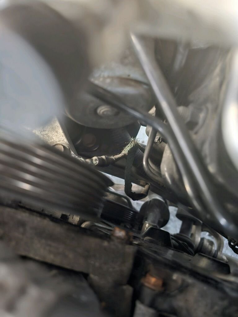

ok well we found a bunch of wires chewed up
we will send pictures
quote for harness over $7000
well looks like I’m going to be doing some soldering and eBay shopping

OOF. That'll cause a few issues. Very unusual damage. They look melted. I think someone jumped it backwards. Well good luck in both finding all the matching color wires and all the solder you are going to use.
crazy right who knows how long it’s been like that
Thanks for the luck 😂 I’ll keep it posted what’s going on

Wowsers @Buddha823 ! It looks like bite marks ... like a rat got in there and just chewed some random things !!!

You might have some animals chewing on your cables...mice, squirrels, etc.
