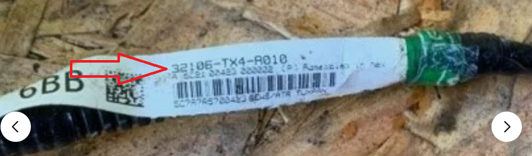

I bought a 2018 Acura RDX used i ran a scan on it and I had a fault with the rear engine mount. After looking for the rear mount I noticed that the wire harness is not even connected and I cannot find it. I found a wire harness on eBay but where does it connect to after it leaves the motor mount?

As you know, the below reflects what the sub-harness looks like connected to the motor mount:
The below shows the part number for said sub-harness:
The below shows where it is located on the vehicle. I'd look at the rear of the front subframe assembly or lower firewall for the place that bracket (yellow arrow above) to attach to??

Thank you so much, where the other end of the motor mount wire harness goes ...does it plug into another wire harness or should there be a module there? This car was in a accident and I'm just not sure what wasn't put back.
