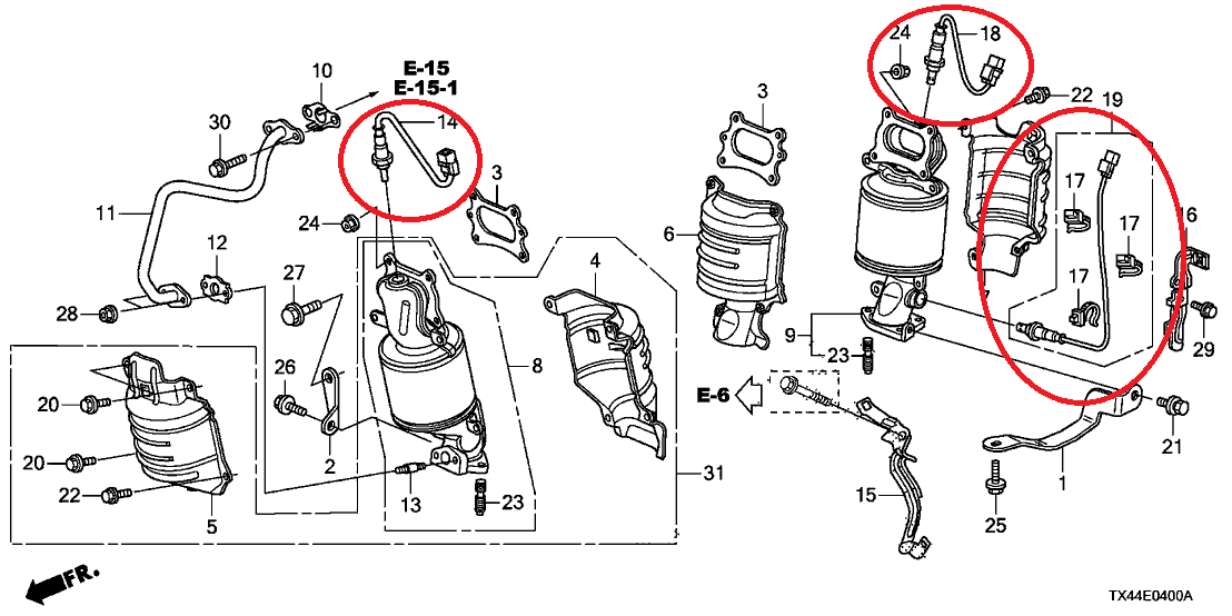

Could someone please tell me where exactly Bank 2 Oxygen Sensor 2 is located and what the OEM part number is. As far as i know it is the one after the catalytic converter on the side of the motor facing the radiator fans, but the downstream sensor i ordered from Amazon (compatible with RDX) has a longer cable and a different (male rather than female) connector as well as different looking sensor tip (see pictures, Original OEM sensor is on the right)

That's right, a sensor with a long wire is the downstream second sensor, sensors with short wires are the upstream first sensors. You are probably confusing the concept after the catalytic and before the catalytic. The diagram says that there is no second sensor of the Bank 2.

I figured out your sensor is down on the pipe, on the transmission side
I take it #14 and #18, the upstream sensors are the wideband sensors and #19 and the one in the pipe #11?, the downstream sensors are the narrowband sensors?
What is #1 in the second diagram? Is that an additional cat or a flex pipe. Impossible to tell from the line drawings.

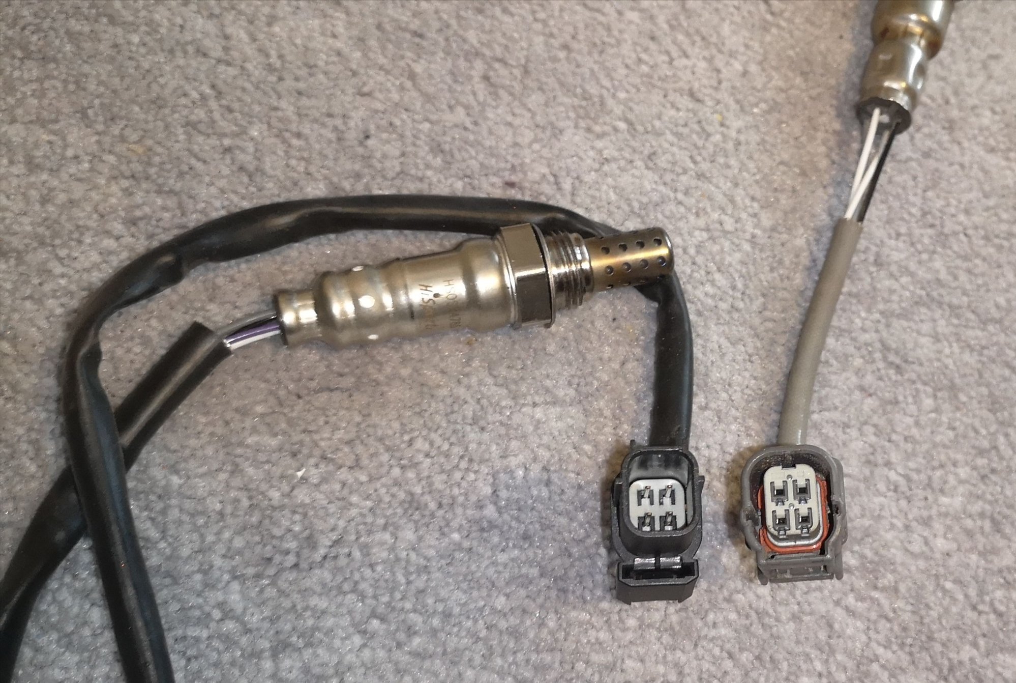

Thanks guys, I figured it out: As far as i know there are two catalytic converters and 4 sensors on the RDX, two for each converter. The sensors on bank 2 (where front catalytic converter is) both have short cables. The upstream sensor is accessible from under the hood, at the front of the engine compartment, downstream sensor is on the exhaust pipe right after the cat, and easily accessible by crawling under the car from the front. I needed the downstream one for the second bank but they sent me the downstream sensor for the first bank (#19 on the second diagram). Anyway I returned it and ordered another one but this time i made sure to check the connector and the cable. I received it and installed it yesterday and it seems to have solved my problem. No more P0159 (Sensor Circuit Slow Response Bank 2 Sensor 2). See the photos for sensor location. First one is the upstream sensor, the second one is downstream.
2013 RDX - Bank 2, Upstream Oxygen Sensor
2013 RDX - Bank 2, Downstream Oxygen Sensor

Also know that the upstream and downstream O2 sensors cannot be interchanged even if the connector and wire lengths are the same.
Most likely due to the fact that they are not interchangeable, this is the reason why Honda makes different lengths and different connectors.
Like I said in my post, even if the connectors and wire lengths were the same, they could not be interchanged if one is a broadband sensor and the other is a narrowband sensor.
Like I said in my post, in Hondas this does not happen.
You missed the point. I know, but the point was those two types of sensors cannot be interchanged and sensors (yes even brand names) can also be bought where they just come with wire ends where the owner splices the old connector in. In that case, you better get the correct sensor type.
