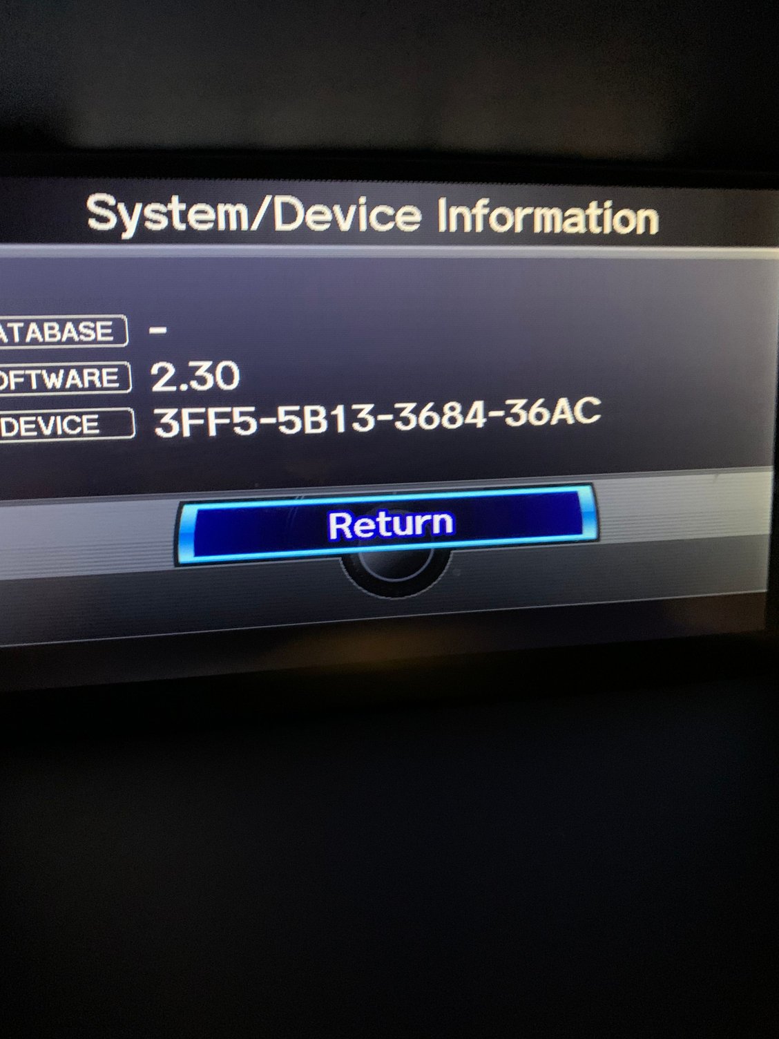

Bumping up as ours shows the same thing. I was looking to update the maps for my daughter and the HERE vendor for the discs is no help. The number on their email was to a doctor's office!

Yes, that was the instructions we followed. Here's the screenshot.

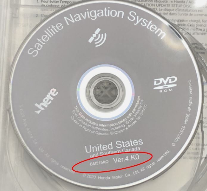

Another thing, and it is my understanding you should have a DVD either in a DVD reader or have been supplied with one, but that being the case I think the database version is on the DVD. See the attached image.

Bummer - we don't have a disc.
