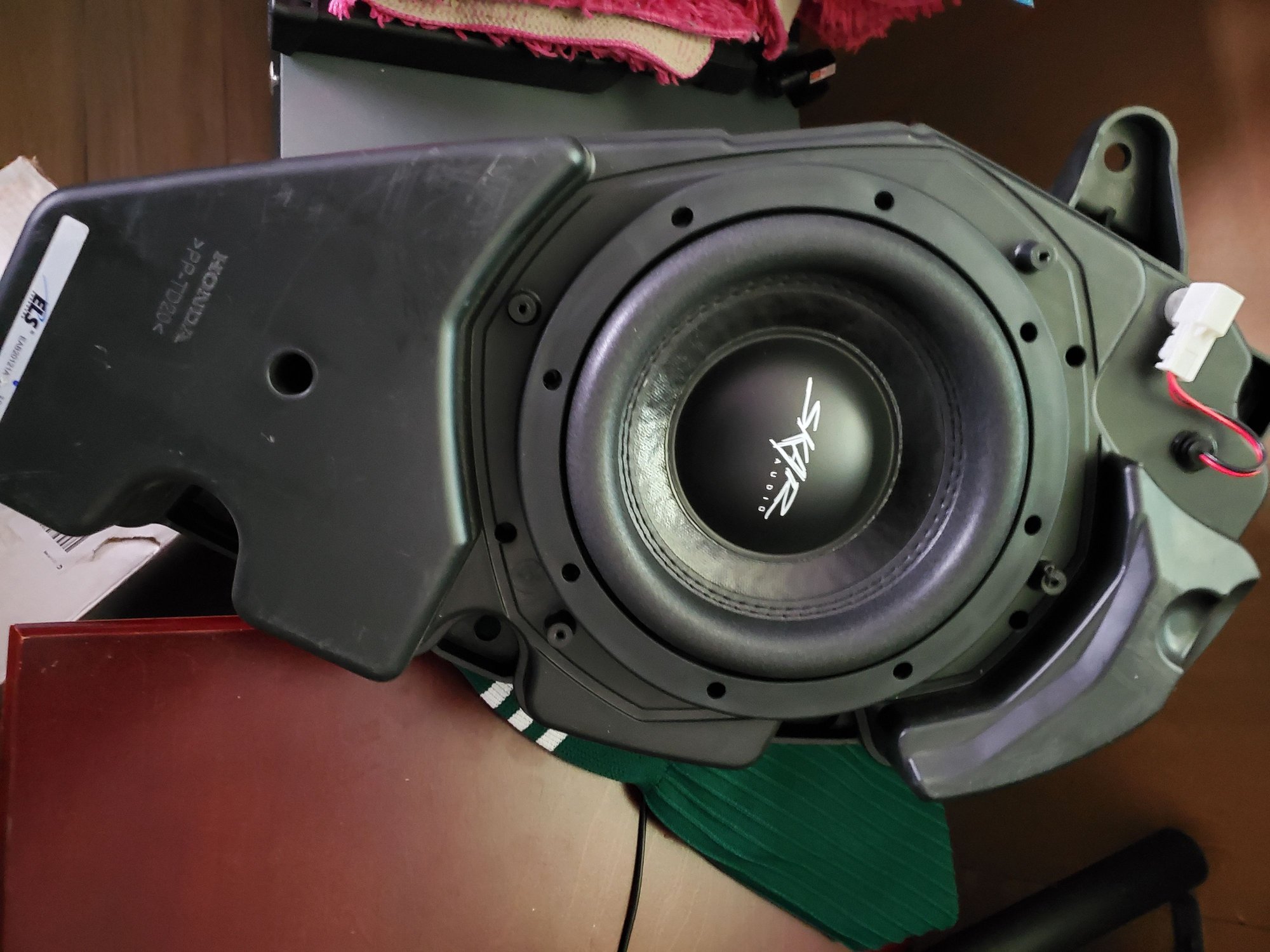

One thing that I often see missing from posts like this is what the install experience is like for those that choose to do the job themselves. So I figure I will give you guys a few words on what it was like to install everything. Getting access to the subwoofer is relatively easy. I didn't have much trouble there following steps detailed in some of the other posts here. My only recommendation here is DON'T Try to remove the grill from the outside. It is screwed in from the inside and you are just going to mess it up if you try to pry it off. Remove the panel to access the subwoofer. The sub is bolted in with a handfull of 10mm bolts and 2 nuts that attach to posts from the body. Make sure you have a deep socket to remove these as they like to fall out and will be a pain if the fall into the body recess once removed. Because I had purchased the other sub enclosure, I was able to stage it outside the vehicle before installing it. This saved a ton of time and meant that until I was ready I could continue to have the factory "sub" installed.
Prepping the sub and box was pretty straight forward. Once I removed the grill and screws from the sub it came out with minimal effort. There is a small gasket around the sub that you will need to either use a flathead screwdriver or panel pry tool to get the sub to pull away from the enclosure. In my case the gasket came away clean and stayed attached to the sub after removal. There was a small square nub on the box that was used to key the factory subwoofer to the enclosure so I need to trim that with a razor knife as well to ensure it fit flush. If you look closely in the pictures you will see the trimmed area in the second picture (Mounted in the car) just above the sub. The inside of the box has a set of fins in the molding that create these small square recesses within it and when I test fit the new sub I found that some of them were hitting the magnet on the Skar sub. The Skar sub has a pretty large magnet for a shallow mount so this was to be expected. I used a razor knife to trim them up a bit until the sub sat nice and flush. After that I added a little bit of poly fill (about 2 handfuls spread out across the base and the little pocket at the bottom) to give the sub the impression of being in a slightly larger enclosure. Here is the finished product of the sub install:

After reading through I wanted to post a clarification on the differences between the Base and Tech enclosures. Here are some images that clarify what I meant:
RDX Base enclosure (rear):
As you can see there is a post that extends up into the enclosure with a screw that mounts to the back of the subwoofer.
Here is the Tech version:
That post and screw are not present and make for a much easier install of the upgraded sub. If you choose to use the base version, you would need to get a sub that is more shallow and you would need to plug that screw hole to prevent any air leaks.
