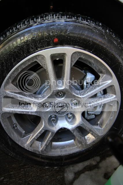

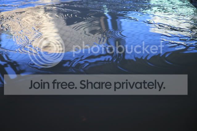

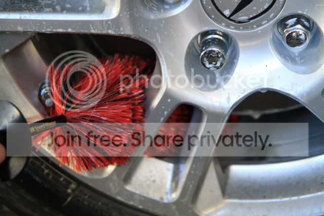

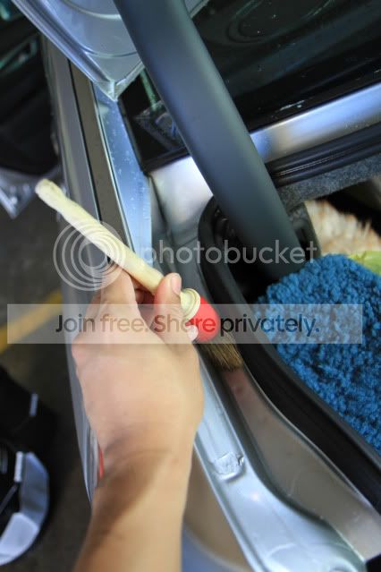

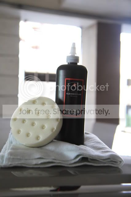

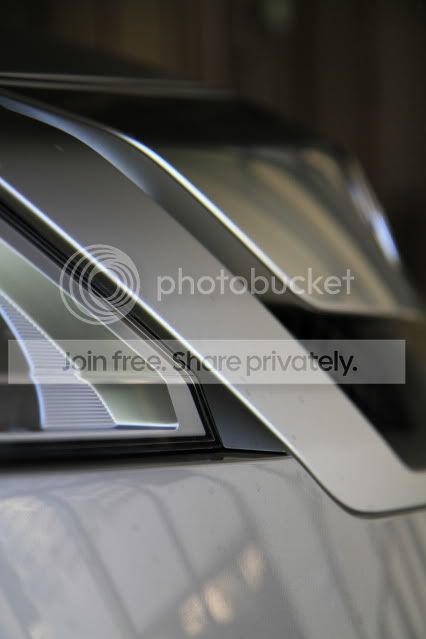

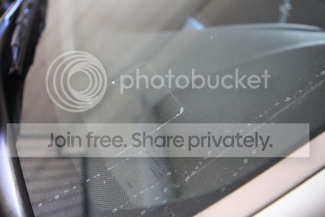

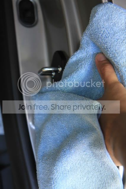

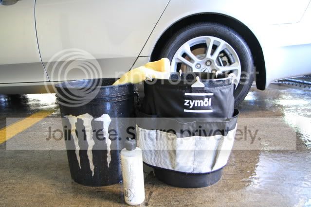

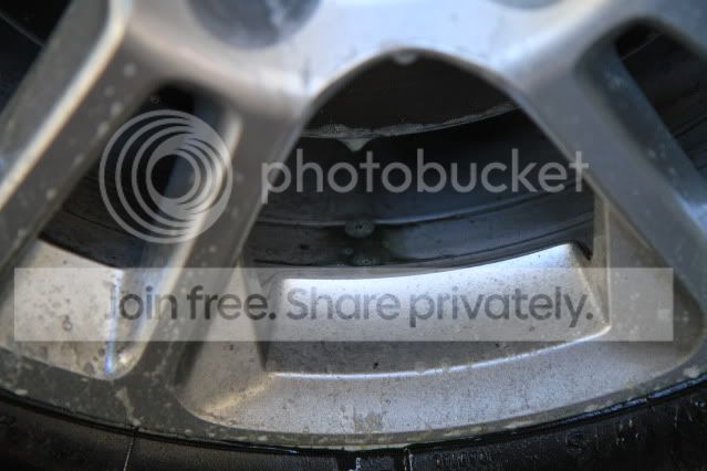

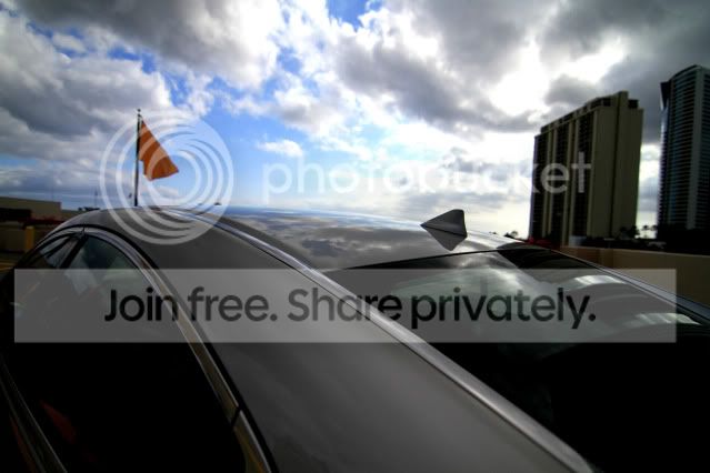

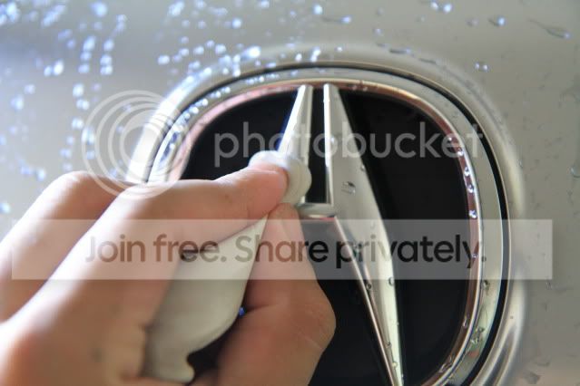

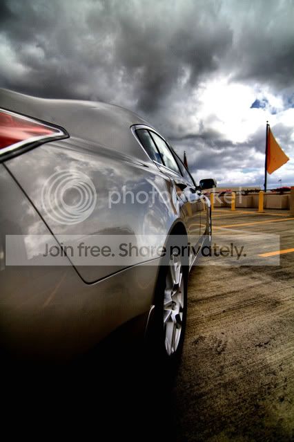

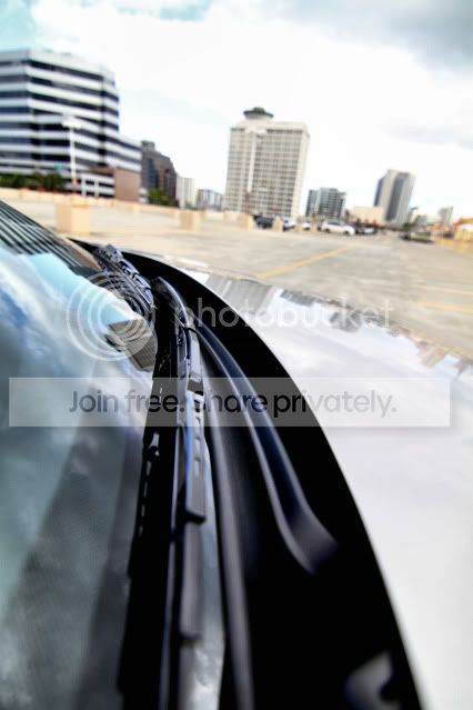

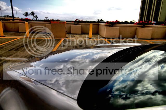

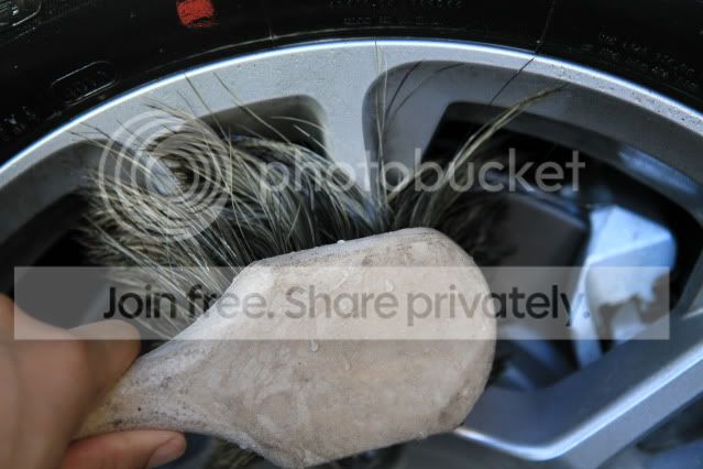

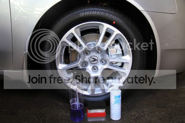

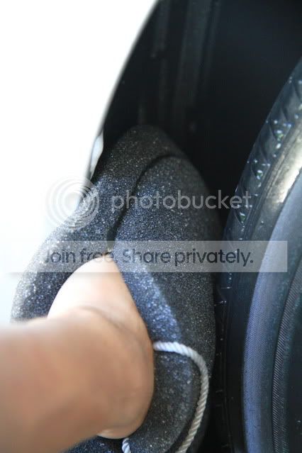

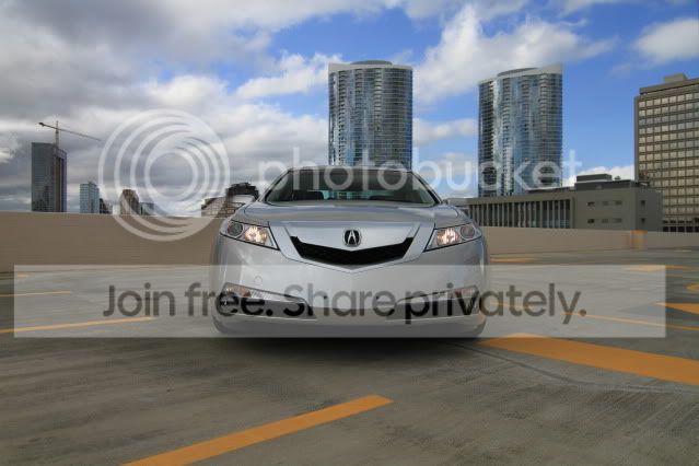

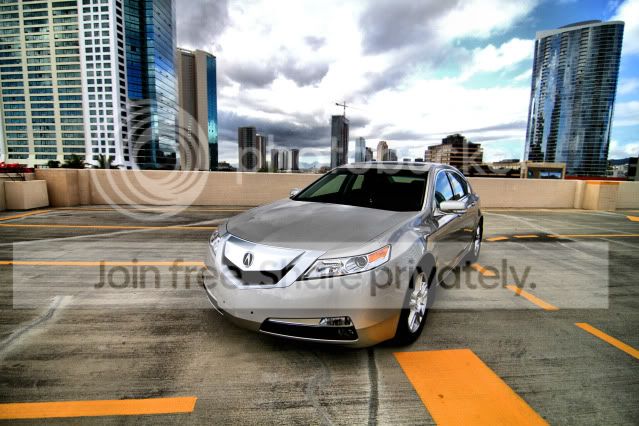

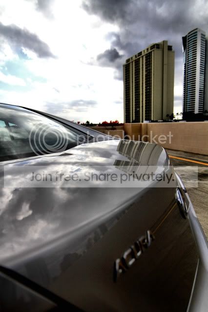

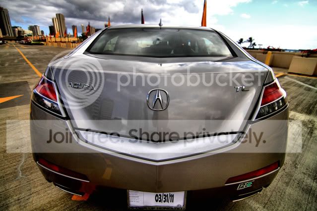

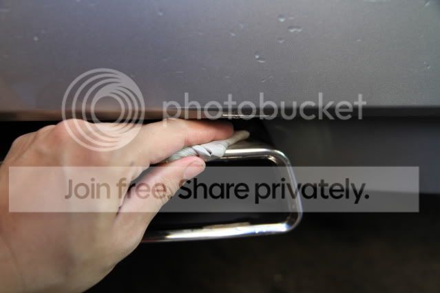

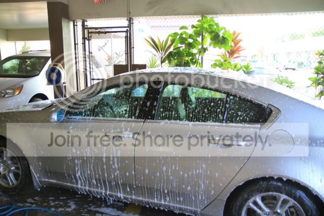

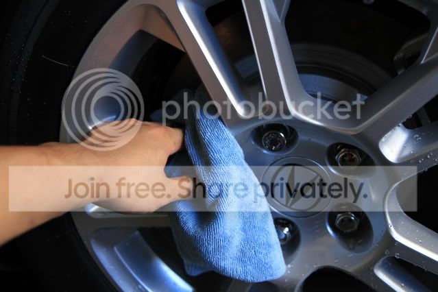

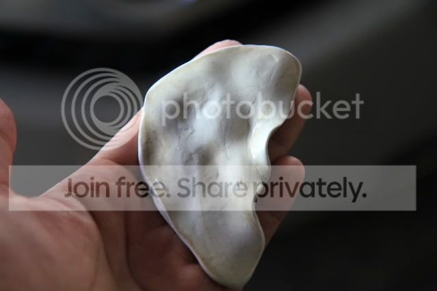

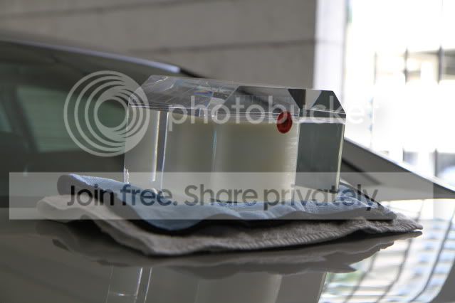

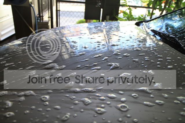

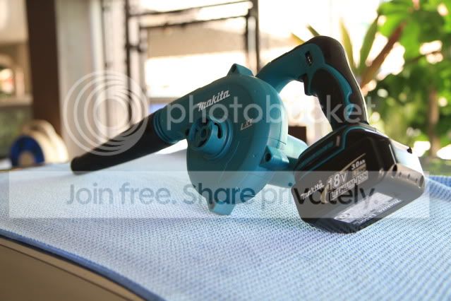

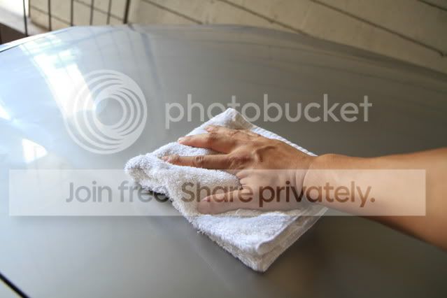

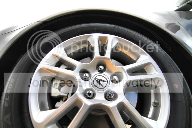

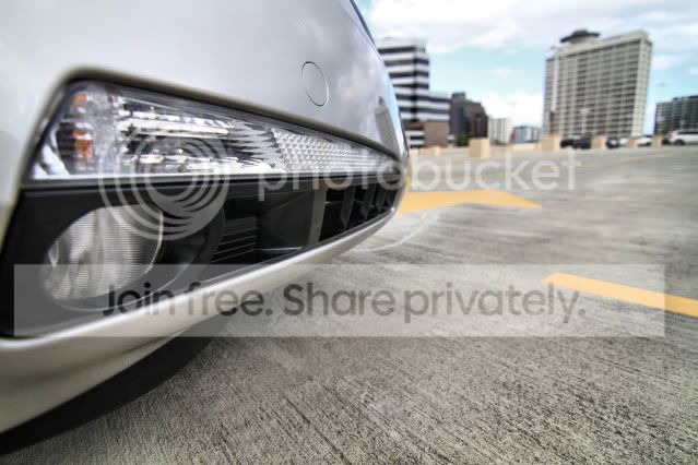

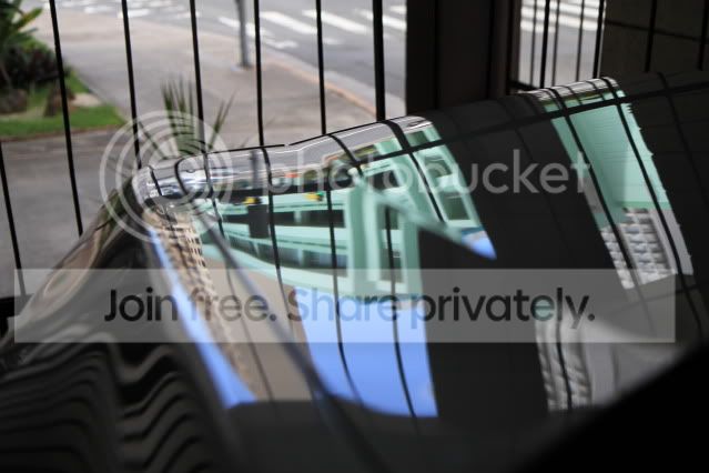

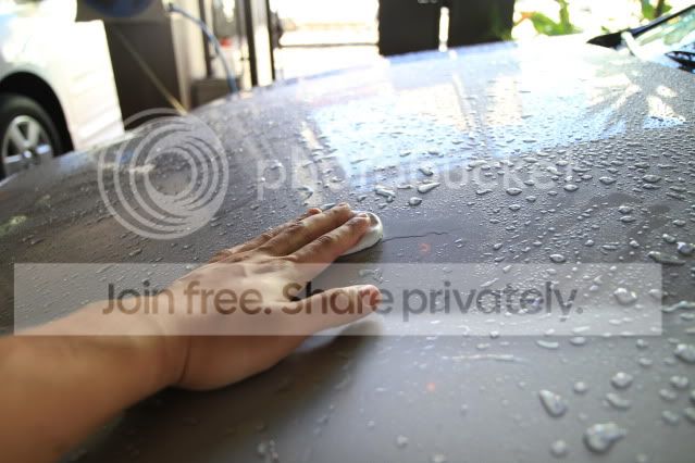

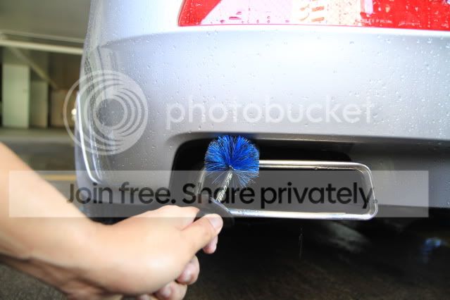

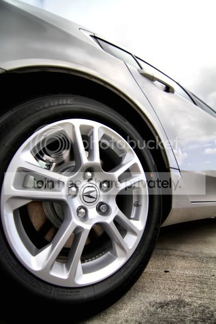

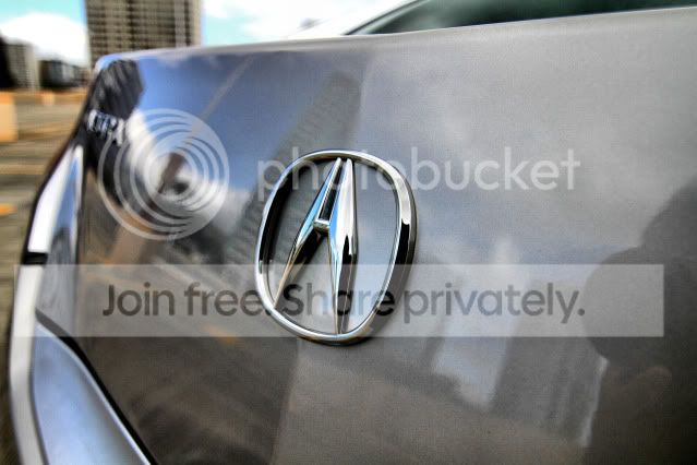

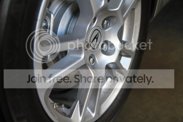

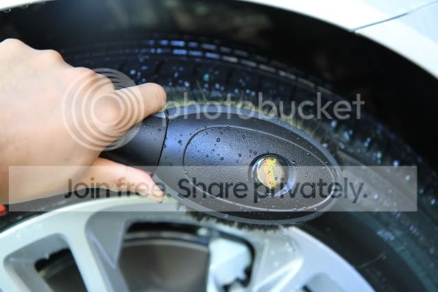

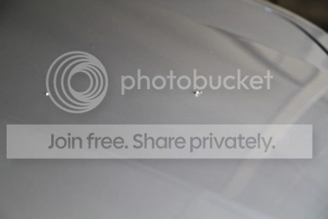

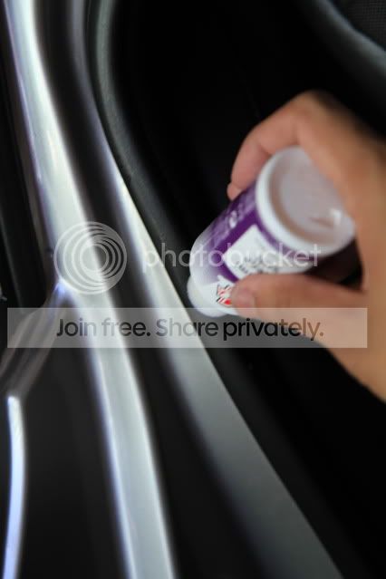

Here's some steps i do, Picture below, is when i first got my TL back in 11" (Now RDX 14")
Didn't do anything to the car yet "As it receive"

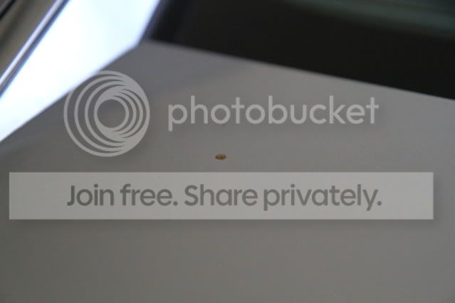

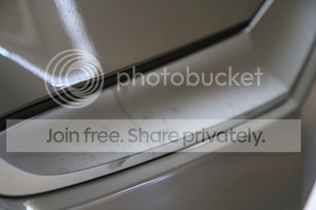

[Spot Check]

[Spot Check]
waterspot was forming
Tar spot
Birdbomb
adhesive left behind when removing sticker
Brake dust

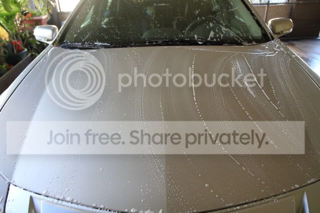

[Foam Prep]
Used Foam gun mixture of CG CWG Concentrated to Loosen dirt/oil/tar.
[Wheel/tailpipe cleaning]
Pre-soak Wheel/Well with MS SGS
Brake dust loosing up
Agitated With Valuable Brushes
Scrub Tire/Wheel well w/ Mixture of MS SF/SGS
Clean Tailpipe w/ MS SF/SGS
Clean Cracks and Crevices w/ MS SF/SGS
[Wash]
CG CWG Concentrated w/ 2 bucket method

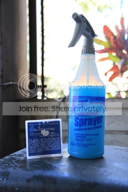

[Claying]
Bilt Hamber Soft w/ ONR Detail spray formula
Nasty
Also did the Badge/tailpipe
[Drying]
Flooded the car to remove much water as can
Used Pakshak WW and Makita Blower get any water left on surface and Crevices
Wheels dried

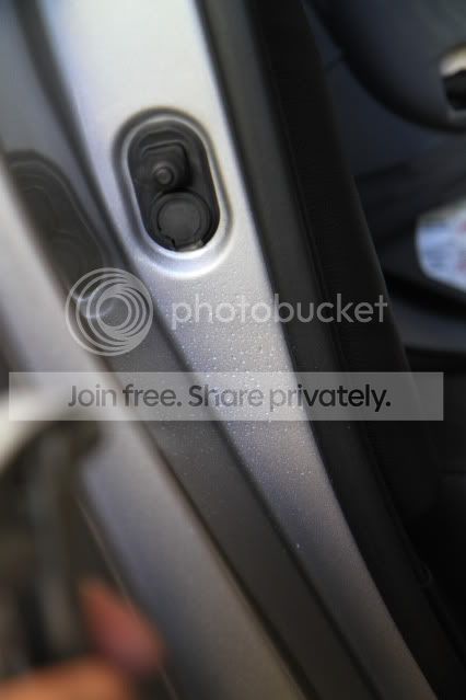

[Door jams]
Door Jams cleaned with ONR.
[Surface Prep]
I wanted Maximum Nubu glow and bonding, so I choose SV Cleaner fluid.. also it is easier to work with then zymol field glaze
Used 4" white pad with CF by hand :cursing:
After.

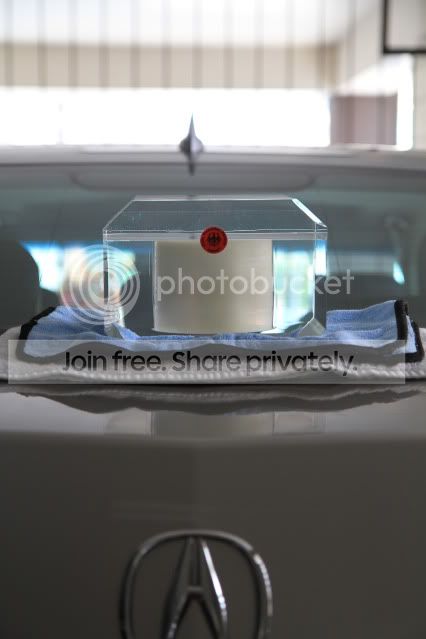

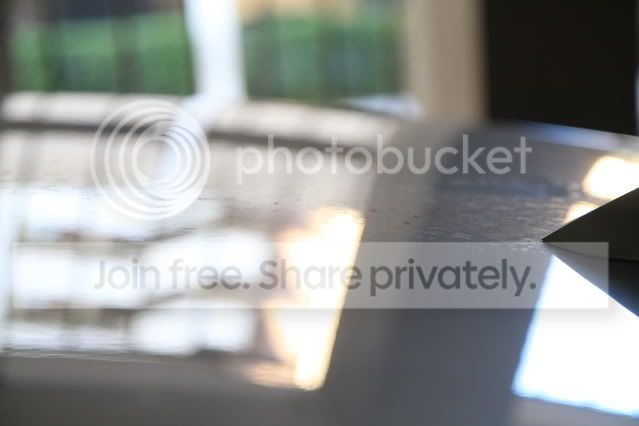

[LSP]
I choose Zymol Vintage
Let it sit for 15mins or so
[Trim&Tire Dressing]
Tires, I used my Favorite tire dresser "Zaino Tire Shine"
Wheel well dressed with CG Bare bones

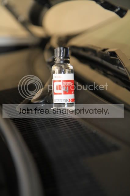

and last Gtech c4.. and WOW the best one i've used so far.. the problem with the other trim dressers was it was to tacky and collected dust... i highly recommend this and try n overlook the price tag. because IMO its worth it!

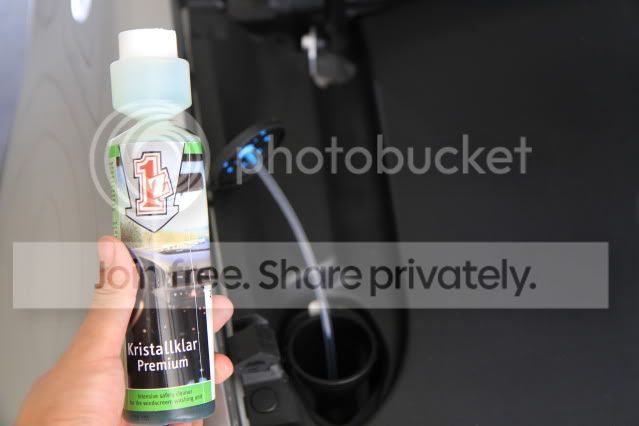

[Washer fluid/Rubber trim]
My Favorite Einszett Products was used "Kristallklar Premium" & "Gummi Pflege".

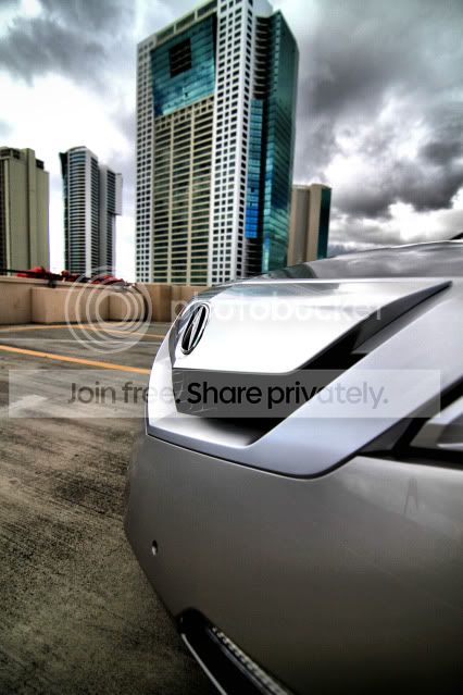

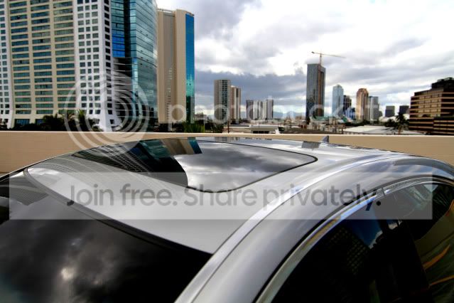

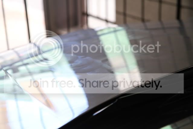

[Final Shots] Note: the weather had overcast with dark gray clouds, real bad lighting. so enhance the brightness and contrast to bring out the color.
And Last a Pano shot
Hope this helps, if you have any question feel free to ask.
