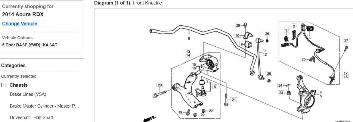

Does anyone know part number for Front sway bar Bushing Bracket Bolt? I believe these are 12mm.
Thanks.
Thanks.
Is it #28 below?
Front Knuckle - 2014 Acura RDX 5 Door BASE (2WD) KA 6AT
Old Aug 17, 2025 | 06:08 PM
wallmike's Avatar
Joined: Oct 2013
Posts: 182
Likes: 28
No. It is bolt on #10 which is a bracket that holds the bushing (#9) in place.
Old Aug 17, 2025 | 06:37 PM
Posts: 6,884
Likes: 2,204
#28 flange bolt (8X16) (red arrow) passes through #10 front stabilizer bracket (purple arrow), which houses #9 front stabilizer holder bush (green arrow), which in-turn fastens the whole component assembly to #15 or 16 front compliance bracket (blue arrow) as demonstrated by the black solid line path.
Is that not what you asked for?
If not, which flange bolt are you talking about shown in post 20's above diagram?

wallmike's Avatar
Joined: Oct 2013
Posts: 182
Likes: 28
Looks like you are right. My bad.
Thanks.
