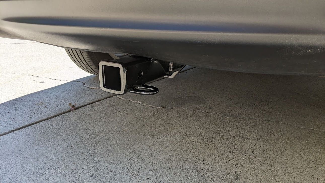

installed the hitch, fortunately, it's actually quite clean underneath there, I put 2 washers on each side that I found from home depot
I'm extremely concerned about damaging the bolts, what torque did you guys set the torque wrench to tighten it? I saw someone mention 60?

If the bolt/threads are in any way lubricated with oil or WD40 or the like, the torque required will be significantly less. Even on a perfectly dry bolt, 100 felt like a lot.
60-80 would be good I'm sure, but as with anything keep a keen eye on it and check the torque after the first few uses.
Over torque it, and you'll strip the threads just like I did.
