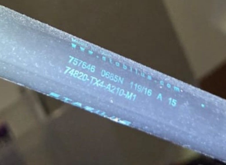

The old ones say 74820-TX4-A210-M1 (Is it 74820-TX4-A21 ?) It seems like 74820-TX4-A22 is a replacement for 74820-TX4-A21 (~$130 for 2).

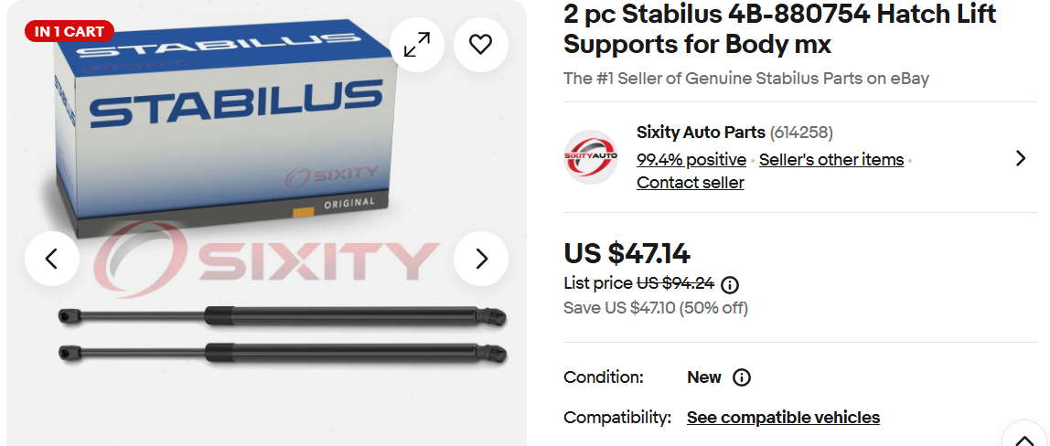

According to the Stabilus catalog I need 4B-880754 (~$50 for 2)
There is an option to buy AISIN parts (~$36 for 2)
What do you recommend?

If the 8 to 9 years of utility received from the old Stabilus factory OEM component pictured below (possibly made in 2016?; red arrow) is not reasonably acceptable to you, then try another brand, no?
Yes, it's absolutely reasonable. Thanks.

Just to let everybody know, these solved the issue. They look like original ones.
Stabilus 4B-880754 (~$50 for 2)
