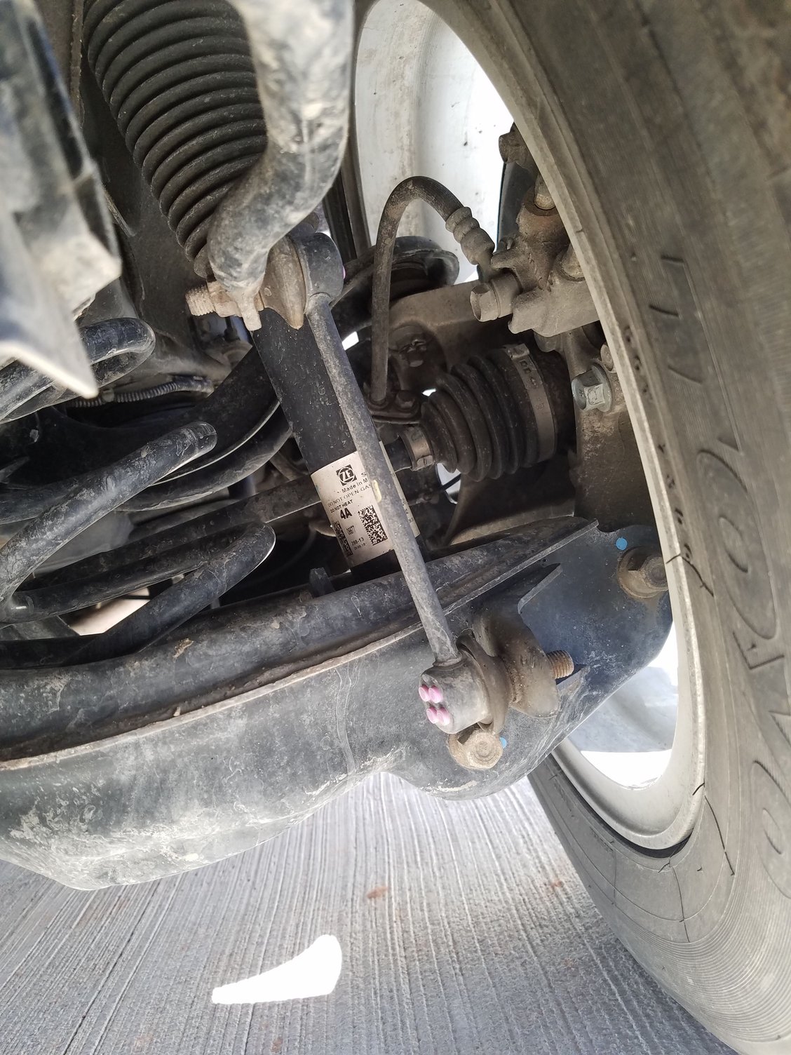

Found the problem. It is a thin rod that seems disconnected from some purple colored thing. Perhaps the tow rope was connected to that. The rod itself doesn't seem damaged. What is this thing? I couldn't pull it out of where it is. Perhaps needs to be replaced.

Here is the picture from the other wheel where it seems connected and just fine.

Sway bar end link...and yes, you need to get it replaced.

You may have some recourse with the towing company. If they tied onto this to pull it, they're idiots.

I got under my '16, and you're right. It doesn't look like there's anything substantial to grab onto back there that isn't some sort of stamped piece of metal structure. That rod isn't even the diameter of a pencil. I don't know why someone would hook onto that thinking it would handle the weight of the vehicle. They've got to have something significant to attach to while transporting, though, so there's got to be a way to do it.

My opinion...go ahead and take it to the dealership or trusted mechanic and let them replace it. In my experience, installation is not the problem with end link replacement...it's getting the old links off. As you can see, the link nuts get rusted up and become very problematic to remove...most shops just cut them out to replace. Installation is the easy part.

Sway bars do just that...control sway or body roll. With one link detached, you've lost that control on the rear of your vehicle. As you've stated a couple times...the part is cheap, go ahead and get it replaced before that link becomes dislodged and gets into something else and causes further damage to your vehicle.
