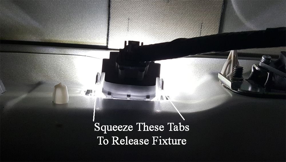

There are release tabs on both sides of the fixture (see photo). Squeeze them and the fixture comes right out. If you can't squeeze hard enough try releasing one side at a time by pressing one of the tabs and lifting that side a tiny bit then release the other side.
Thanks for the photo. I was able to get the bulb housing out, but once out I could not pull the bulb out of the housing. I was at the point I thought the bulb would break if I pulled with more force. I was tempted to use a tool but did not want to damage the housing.
Old Sep 28, 2020 | 08:24 AM

The bulb (should) pull straight out. Try wiggling it side to side while pulling. If you have something made of soft rubber (like a jar lid remover) use that to get a little more traction on the bulb. As a last resort use pliers. You risk crushing the bulb but it isn't going to hurt the socket.
Old Sep 28, 2020 | 08:34 AM
