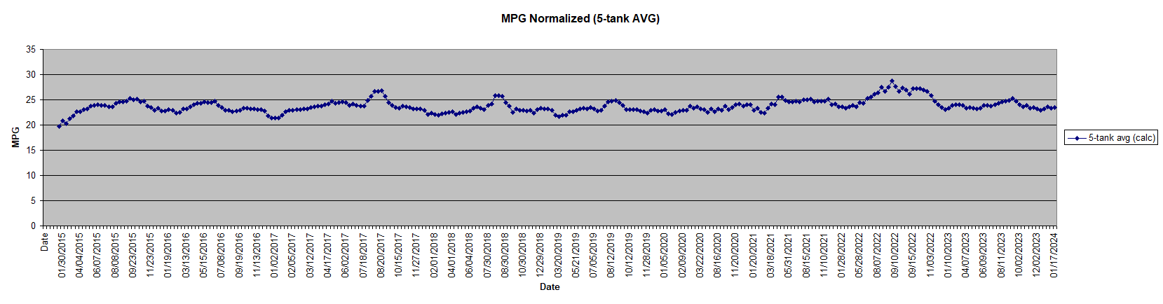

This is my real life MPG data ever since I bought my 2015 brand new. You can see the peaks during summers and valleys during winters. Overall MPG over the life of the car is 23.7. All numbers are calculated actuals - miles driven / gallons filled, not what the computer shows (that's usually about 1 MPG higher). To avoid any tank-to-tank fill variations, I use rolling 5 tank averages.
