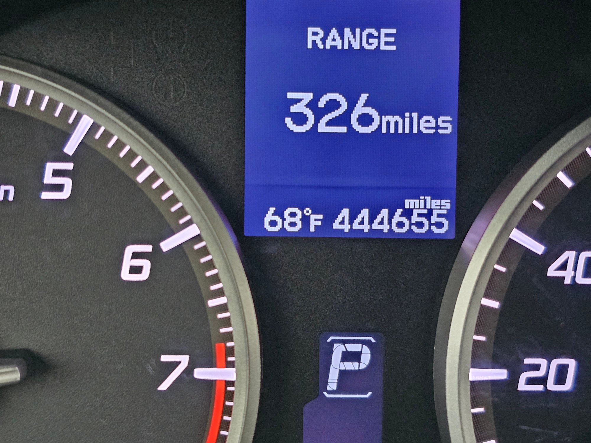

Originally Posted by acuraflight
That has to be a typo right? 444k miles?!
Old Dec 4, 2025 | 07:40 PM
