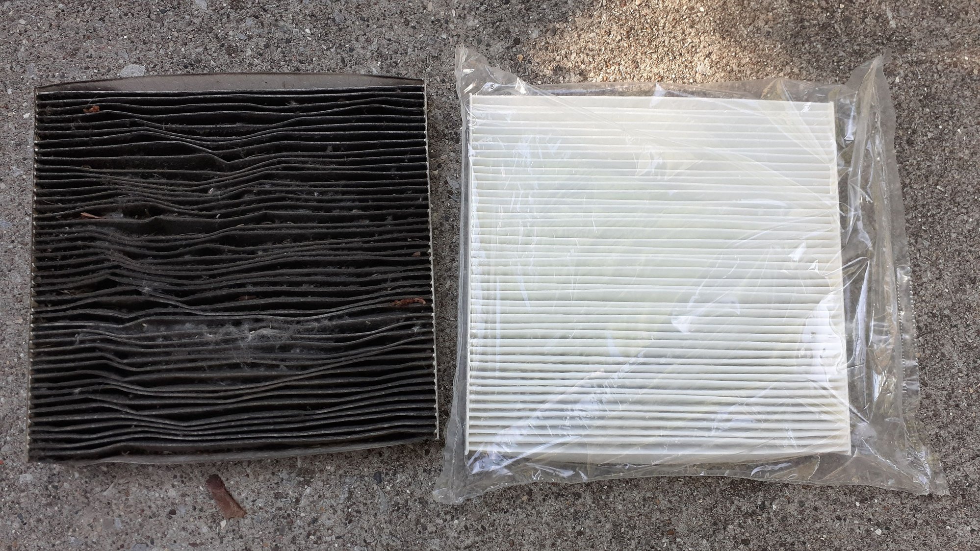

Old Jul 28, 2020 | 04:48 PM
AmbersDad's Avatar
Joined: Jul 2020
Ick
Been there, done that...a couple times. This pic is from a week ago on Amber's new-to-her RDX!
