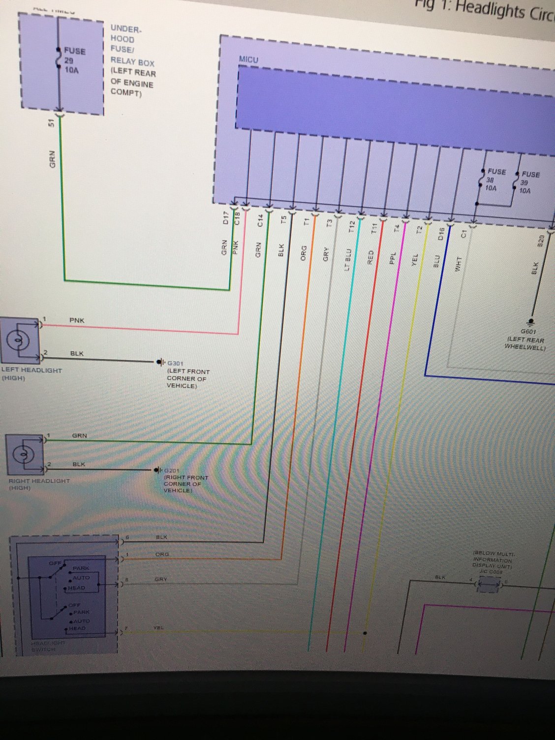

The high beams is switched on and off by power mosfets in the MICU module(Driver side FUSE box)

Old Jan 29, 2022 | 11:04 PM
altair47's Avatar
Joined: Jun 2016
Posts: 1,870
Likes: 600
Originally Posted by Whitety1025
[size=16px]Hi everyone I'm new here this is my first post..[/size]
[size=16px]I have a 2014 rdx that the passenger side high beam won't turn off, can anyone tell me where the relay or module is located? I pulled the fuse so it off for now but I definitely want to fix it... thanks in advance for any help[/size]
If you cut off the green wire (14 PIN C conector ), but 12 volts will come out on this wire of the FUSE BOX even when the high beam is off, then I would put a relay(+12v from 1st PIN C-conector with 10A fuse ) instead of replacing the whole FUSE BOX
