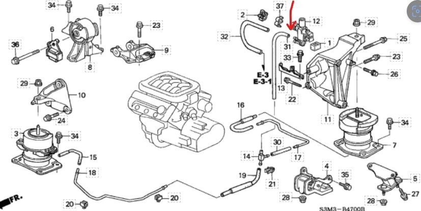

Check all of the vacuum lines and their respective connection points thoroughly. You have a 22+ year old car chances are one may has disconnected
or dry rotted through? Use the diagrams below to trace them out for careful evaluation:
Especially check the two connections at the #12; Valve Assembly, Electronic Control Mounting Solenoid ; Hydraulic Control Unit below.
I had a similar 'dogged' surge that I could not get rid of in the past and after in depth under hood review, 'stumbled' upon one of the vacuum hoses on #12 had disconnected completely. Reattached it with a reinforcing small cable tie and the surge was cured.
Good Luck!

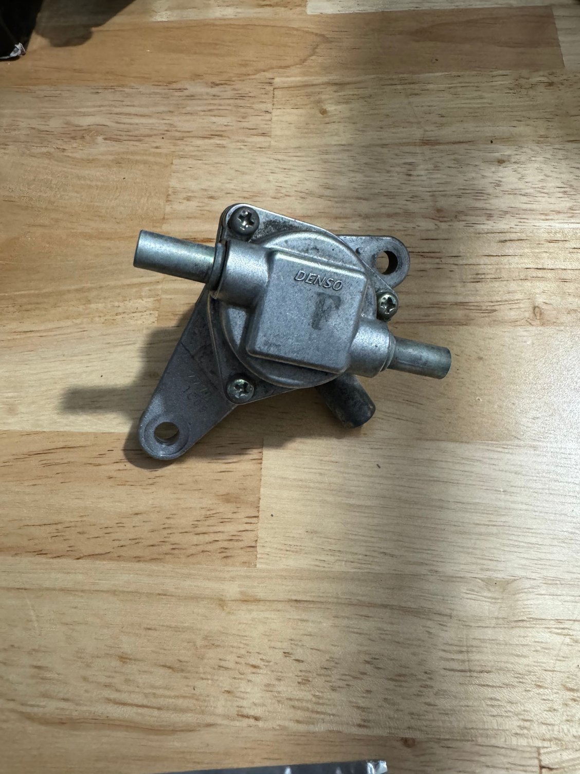

Turns out my problem, was a little bit different… After replacing the throttle body with that from a junkyard, I was still experiencing the same issues:
  • Idle surging after letting off the throttle during the warm-up phase.
  • High idle when cold
  • restarting the engine recovers from surging idle.
After checking for any possible, vacuum leaks, using carb spray I was not able to find anything.
Moved on to clamping vacuum hoses leading into the intake manifold and or throttle body and found nothing there either.
One last hose that was not thought of previously is the one that leads to the intake air (IA) bypass control valve shown below, it feeds into the air tube in front of the VSA valve component .
I clamped that and blipped the throttle a few times while the car was cold and found that the problem was resolved.
Luckily, I had recently picked up several parts from the junkyard, and this happened to be one of those parts that was included so I swapped it over quickly and the problem has been solved.
After I removed the faulty part, I disassembled it and observed that it does appear to be adjustable, meaning that if one were to know the point at which it’s supposed to close and they immersed in some water at that temperature and then adjusted it until the valve was closed I speculate may make an effective repair; could be the reason why this part is no longer available as just something that could be adjusted
