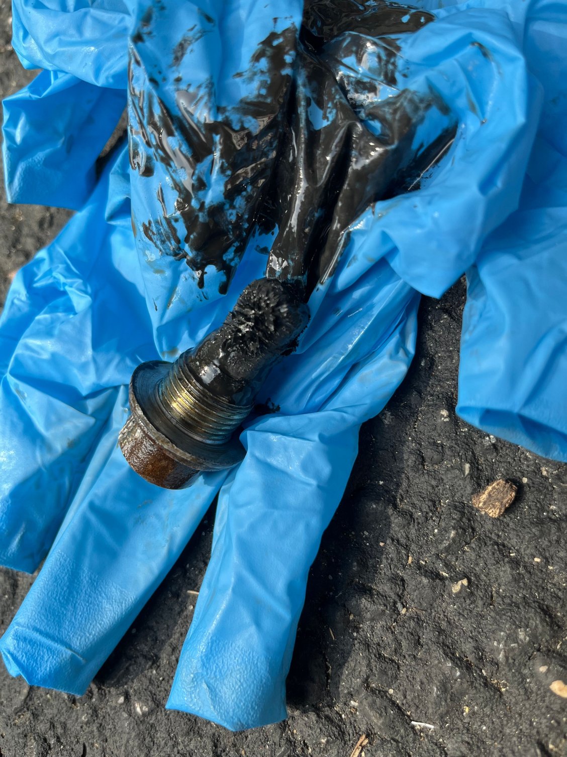

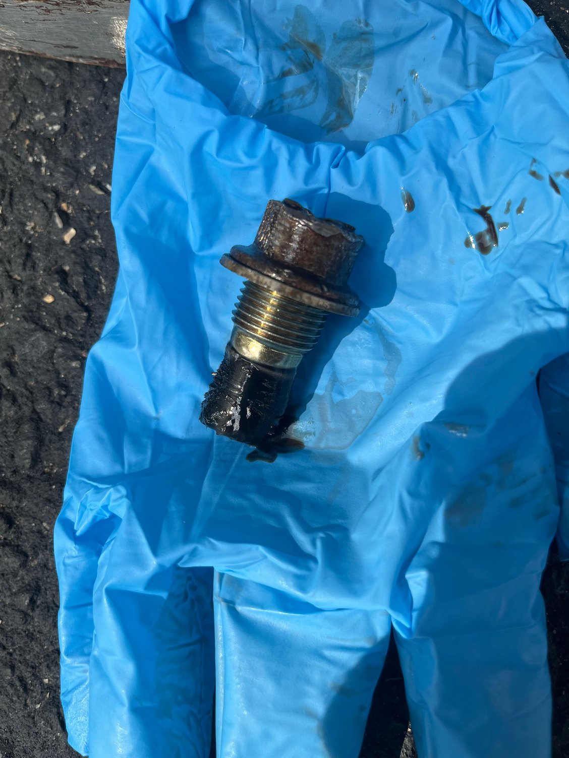

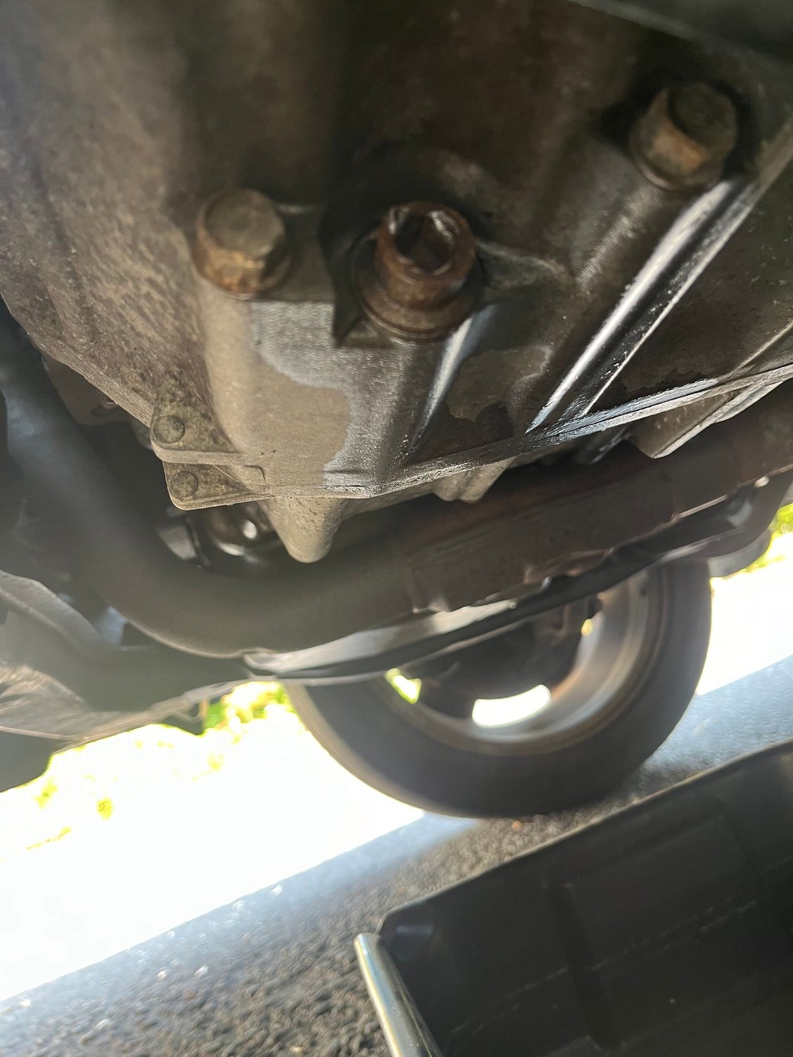

so i changed the trans filter, cleaned out the solenoid screens and they looked pretty clean already, i didnt see any gunk in them and when i went to drain the trans fluid, the drain plug was on there insanely tight, i ended up stripping it. any ideas on how to get that thing off?

You actually stripped out the 3/8th socket end part trying to remove?

yes! it was pretty chewed up when i got to it, got the ratchet snug in there and gave it all i got i could NOT get that thing off
Old Sep 16, 2024 | 12:42 PM
mikeynyhc's Avatar
Joined: Jul 2024
Posts: 11
From: NY
Originally Posted by mikeynyhc
Got the bolt off with vice grips, got a new one ready. This is before and after I wiped the plug
