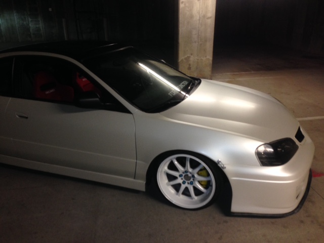

quick shots of 3M satin pearl white and gloss black wrap i did this weekend. still debating on different wheel color, and some of the plastidip'd trim came off in the process so need to respray but overall its 99% done.

its been raining here so havent gotten any work done but took a few parking garage pics. ill get some better quality no cell phone bs soon.
