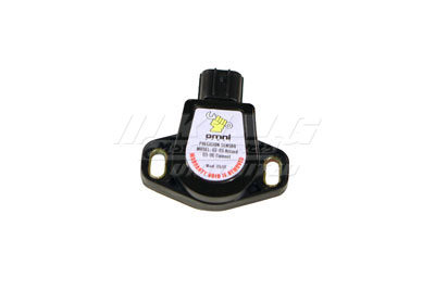

I'd almost bet this would work. you just drill out the goofy rivets and screw this one in. volts are volts. although our car isn't listed doesn't mean this one won't work. Look at the mugen cooling mods for the prelude that works on our cars. but you never know.
http://www.kingmotorsports.com/category.aspx?cat=61

You could have tried this, i would risk 80.00 to save 400.

im wondering if any of these will work.
http://www.streetimports.com/products.asp?catid=187
Old Jul 18, 2007 | 06:53 PM
Sly Raskal's Avatar
Joined: Sep 2002
Posts: 30,991
Likes: 582
From: Fontana, California
^^^ $99
a brand new TB costs $200. I'd rather just buy a new TB for $200 if I'm spending $99 on just the TPS sensor
