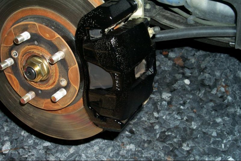

If you all are interested in painting your calipers.. What are you gonna do about the crappy looking rusty rotors?? Can the edges (where all the rust is) be painted? I think doing both would look much better.

Do not use spray cans, it looks like crap. G2 is the best and the most durable. I did my CL in black and my girlfriends Sorrento in red. I recommend sanding down the calipers first to give a smooth base. If you choose red, do three coats it's the bomb. Black only needs two. I can't host so if you want pics. pm me your email.

they're not rusted... just brake dust i think... you can clean the rotors off...

THose pics of shawns shows why you don't use spray. There's to much labor involved and if the painted surface is not prepped right you get all those little dots you see. Thats due to oils and silicone in the air. That's way they don't use wax in paint shops due to the silicones in the wax. It adheres to stuff and won't let the paint stick properly. With the G2 epoxy paint you don't have to worry about those things.
Those pictures are a little misleading.
Those “little dots” are just reflections of light from the flash off of the pitted surface.
The surface was completely black after the fourth coat.
They jut recently started to look a bit worn.

Its rust.. beleive me

Sorry, My fault! The pics were misleading, because that senario happened to me. I just finished waxing my car, pulled it out of the garage and started to spraypaint something. When I did though there was spots on the surface and it looked just like those pictures. Then I remebered the silicone in the wax and had to start all over again.
