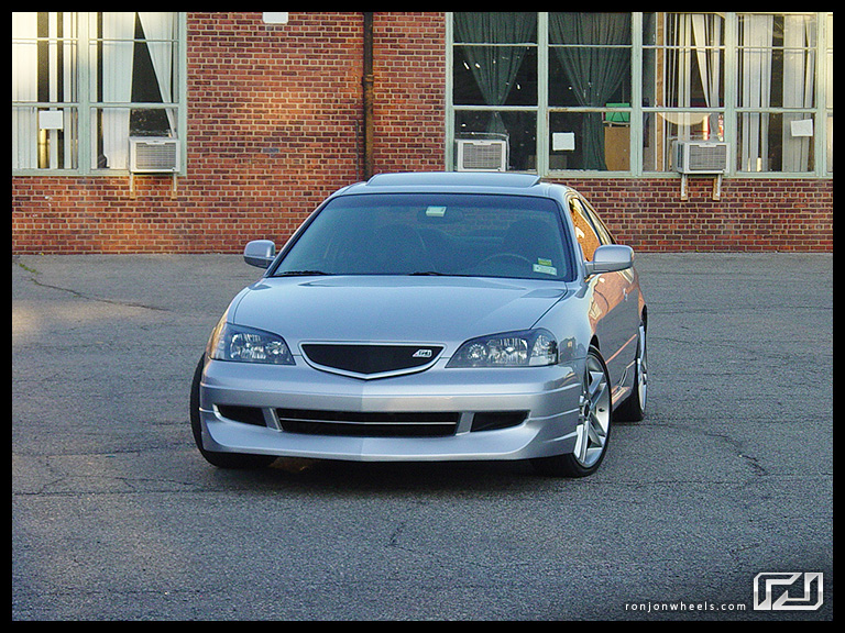

hey everyone i've been looking around for a new grill for my '01 type s and i haven't found anything. I know exactly what i want it to look like.
http://www.ronjonwheels.com/ronjonimages/large/cl8.jpg
if anyone knows where to find that grill or how to make that grill that would be very helpful. thanks for your time

www.mcmaster.com
9232T221 -Aluminum Perforated Sheet 36" X 40", .250" Hole Dia, 58% Open Area, .032" Thk
Make it yourself it's pretty easy.

any tips for a DIY job? I mean in terms of cutting & mounting so it isn't ghetto.

Just take out your grill it has like 4 screws under your hood. Then take off the surround part using a phillips head like 8 or so screws. Then trace that on paper and cut it out. Use that and a pair of kitchen shears to cut out your grill. Then if you want to you can cut off the thing that holds on the chrome Acura wings but if you don;t want to do that you can just take off the chrome part since its just screwed and you have to do it anyways. Make sure the mesh grill you made fits underneath the plastic part and the frame then paint it. Let it dry and put it back together. Its probably the easiest DIY to do to your car.

gingerbead pretty much answered your question. That's the material that looks the best IMHO.
You can see a DIY here:
http://silverknight.clickhere2.net/grille.html Just don't use the gutter stuff, use the mcmaster stuff please. The gutter stuff is kinda ghetto

gingerbread... you have the look im going for...did u buy a sheet and paint it? or does the sheet already come black? thanks
