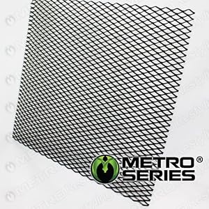

Here is an example of the Mesh and Filter I used & where to find some of the stuff.
The is a random picture i found online of a Filter sample:
The filter comes in different colors & can be found at Home Depot or other hardware stores. Ask for Pod Filters because they are light, made of plastic material and easy to clean & cut.
Mesh pattern is up to you but the one i used look like this:
Good Luck!
