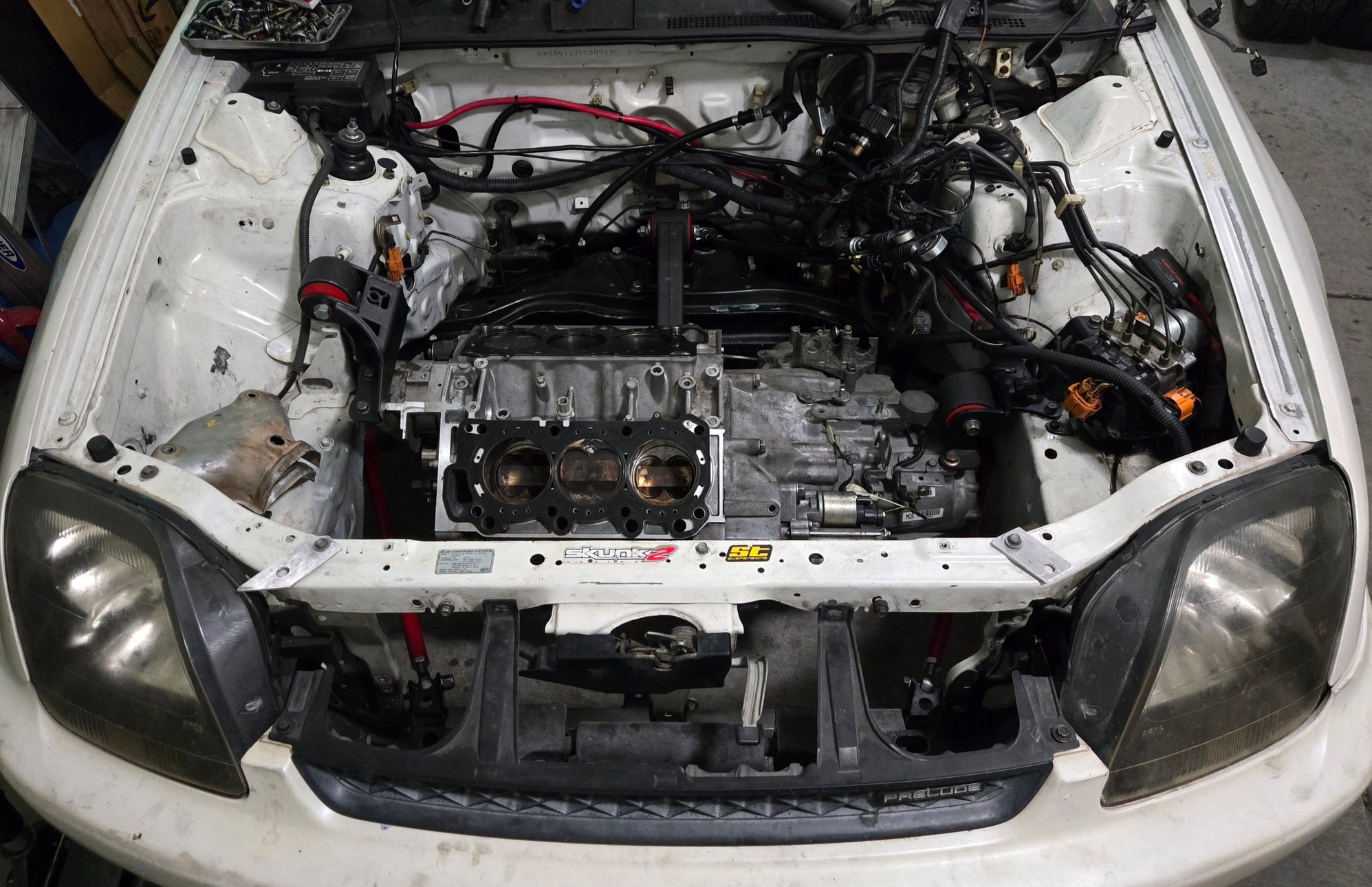

Picked up a j35a3 for $250 from a local wrecking yard today. Bonus, they pulled the motor and loaded it on trailer for free.
Doesn't look too bad for 20+ yrs old. Only notable damage was cut eng harness, broken tps sensor and fan switch. I have more, so no big deal. Plugs look clean and the timing belt and water pump appear to have been done relatively recent.
Here's one more shot after some excess parts were removed. I'm really only interested in using this motor for parts, not to run as is.

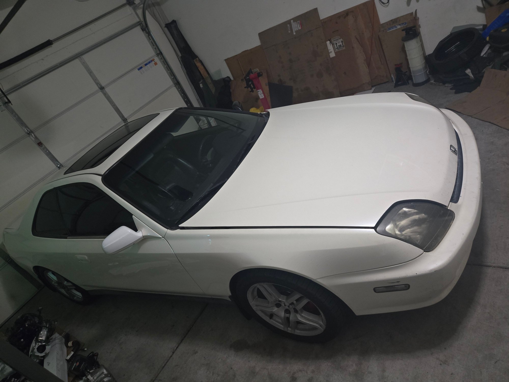

Originally Posted by 619rcr
2021
Three years later

Originally Posted by zeta
That motor tucks into the prelude's engine bay rather nicely!
In addition, those 03 CL-S wheels look great on that 'soon to be a beast' ホンダ・プレリュード.
Thanks Zeta, I do like the look. But, with an estimated 100 ft lbs more torque than the H, pretty sure I'll need to run a sticky 235 width tire. That is if I want any traction...

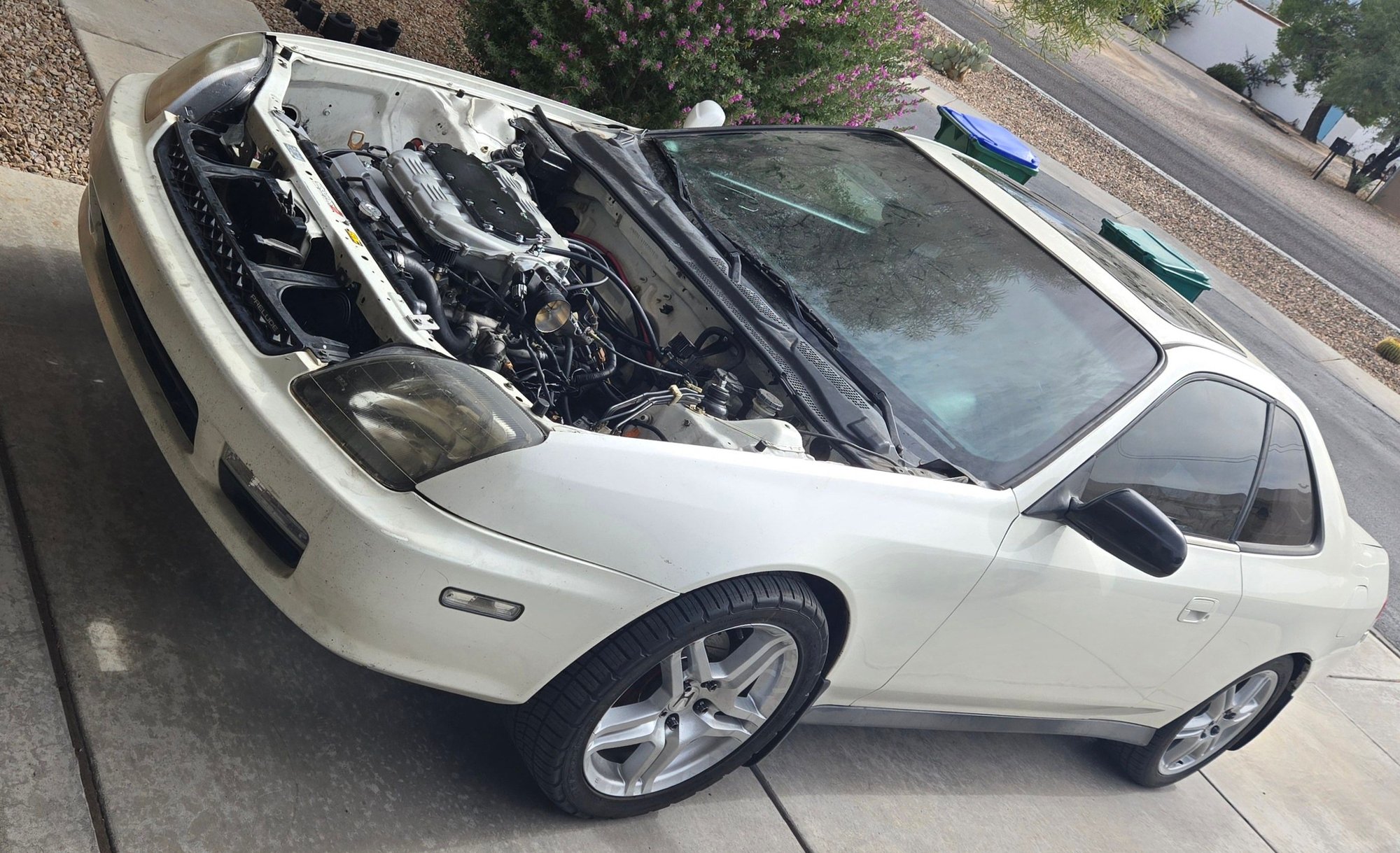

Bumpity, bump. Stopping in for a quick update. Finally sourced one of the final components needed to wrap up the v6 prelude.
Custom Hasport j35 axle
Custom j35 BB6 axle.
Originally, I planned to buy a new flywheel. But, funds are tight rn. So, plan to borrow the CLS6 trans and LFW from the 6GA, pair it with a used stage 3 clutch and pp. Then install on the 3.5 converted CLS6 block, add my already rebuilt P8E heads. Reinstall eng harness, jpipe, fuel rail, etc. Cross fingers and hope it all works... Wish me luck guys.
CLS block
CLS block
Rebuilt heads are in the bags

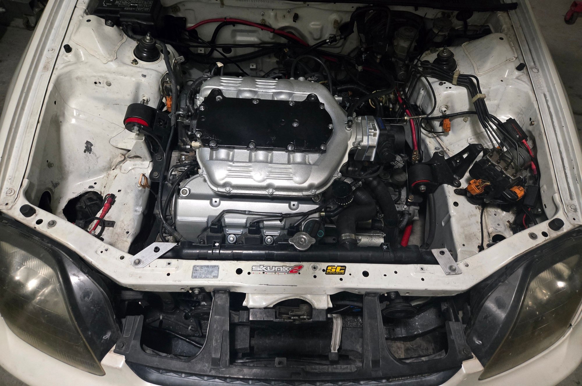

Finally
CLS block, TL 6spd, RL crank & cams
CLS block, TL 6spd, BC rods, RL crank & cams
Done, runs and drives
runs and drives
and yes the hood closes
and yes the hood closes... barely

Hey Zeta, the v6 6spd combo is definitely what the car was missing. It pulls the car effortlessly and still cruises at a reasonable volume and rpm.
There are a few spots that I need to refine in the Infinity software. But overall I'm very satisfied with the results.
