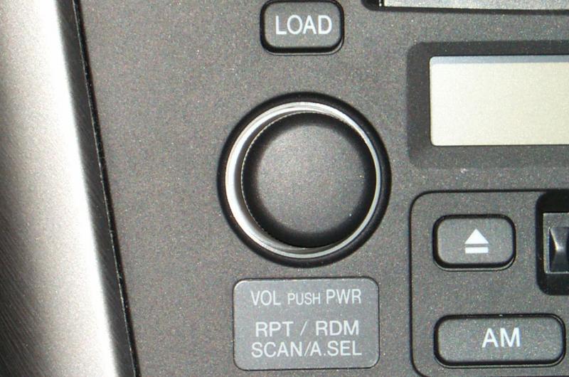

Originally Posted by viet_CL
can anoyone please post pics where i have to adjust to fix the noise??
I use this........ RATTLE FIX
