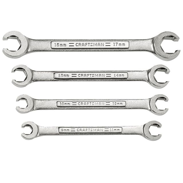

Are you using line wrenches to change your lines? They make a world of difference and is the only way to loosen fittings:
http://www.sears.com/sr/javasr/produ...ubcat=Wrenches
thanks, i give that a try
