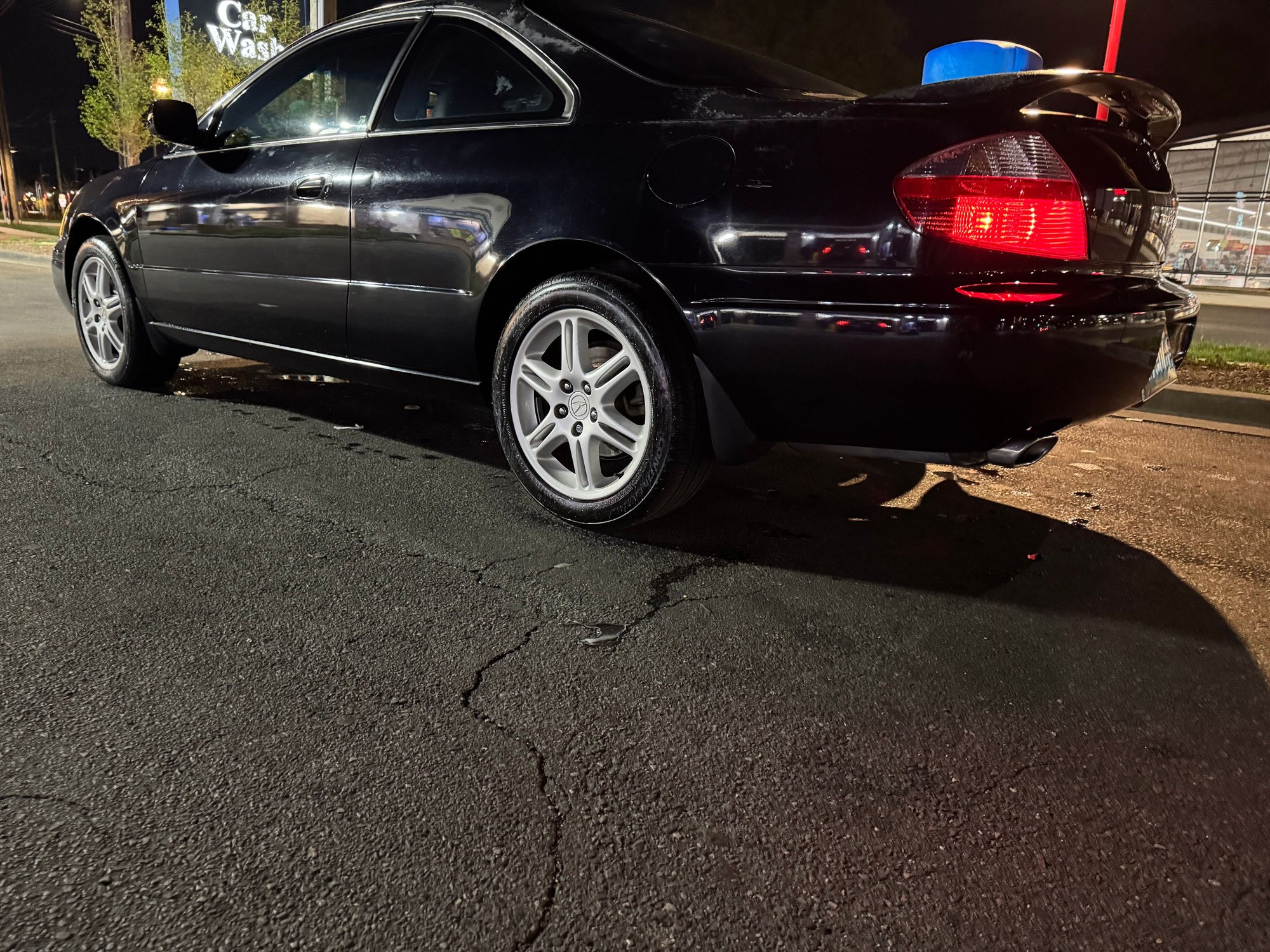

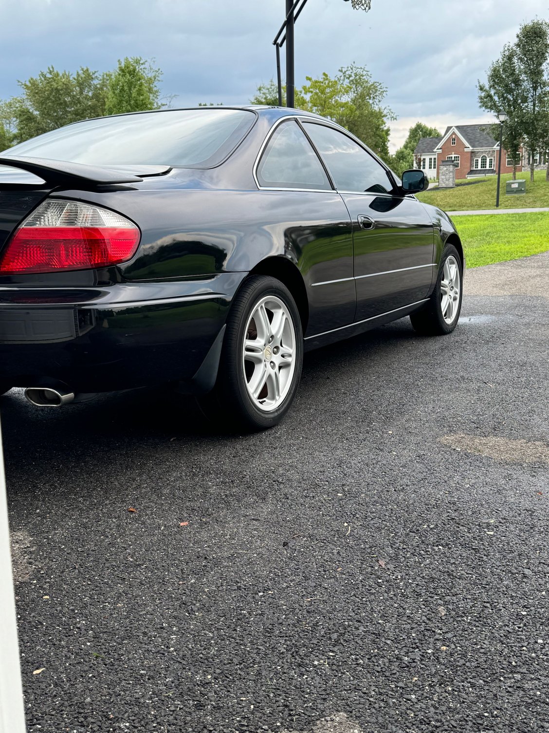

Went and picked her up this weekend. Couldn’t wait to get home and wash her, so I stop at a car wash on the way home. Gave her a nice bath today , next step is that interior, that will be some work. Still trying to figure out what kind of suspension I want and what kind of exhaust I would like. I don’t want the drone effect but I want the a really nice exhaust that doesn’t sound ricey . Also throwing away the garbage that was still there.

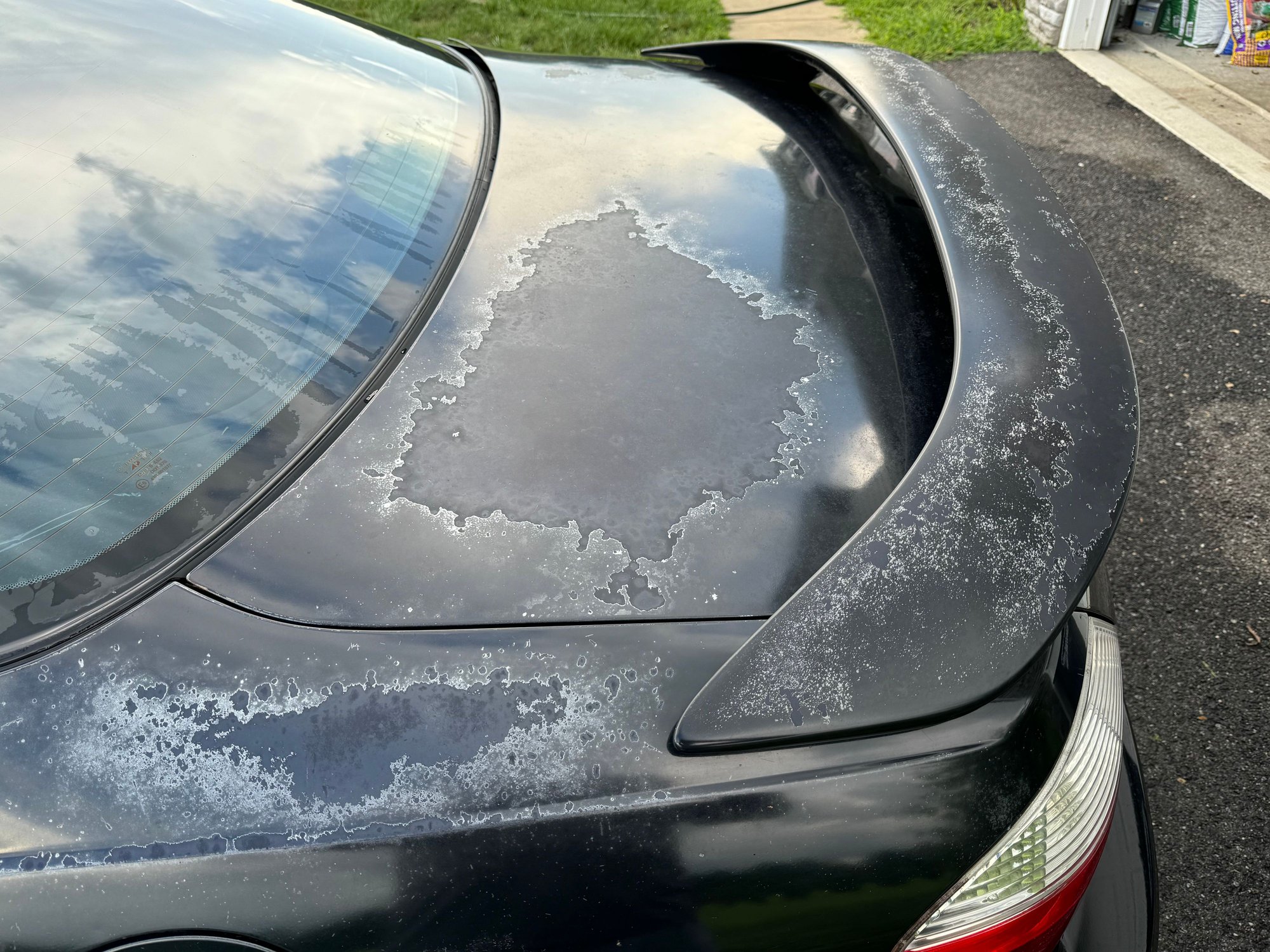

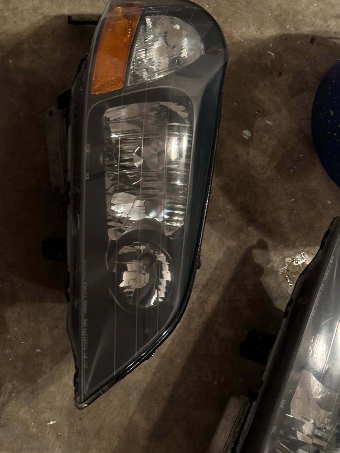

Cleaned up the headlights some, they came out decent but I need to do better, had to redo since I brought the wrong clearcoat

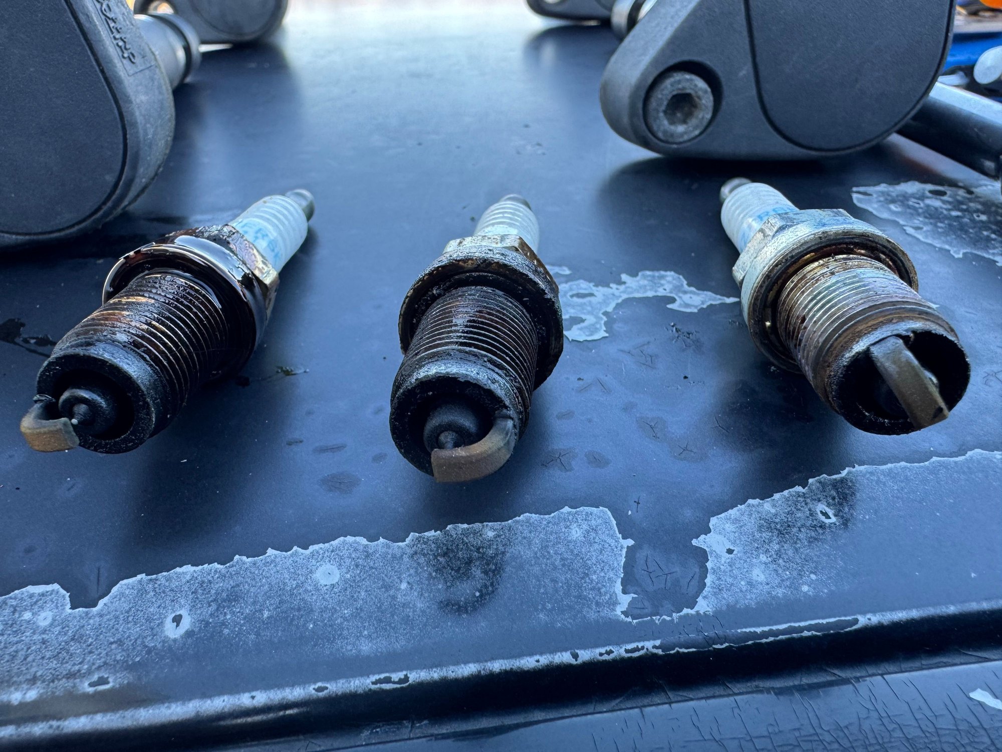

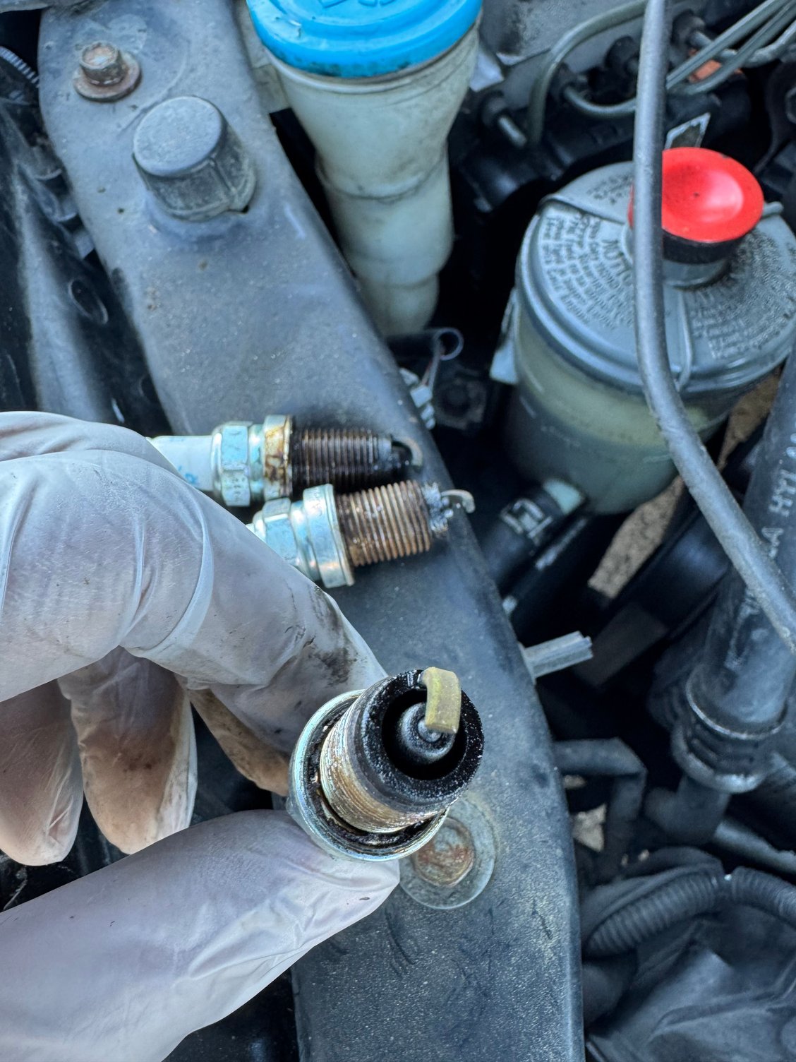

it wasn’t in the air filter box , it was either the spark plugs or the injectors or at least that’s what I’m thinking. So I pulled the plugs today and this is what I see on the plugs. The ones coated in oil are coming from the far left banks.
Can anyone guesstimate what may be the issue with the far left plugs coated in oil
Old Dec 31, 2024 | 10:30 AM
619rcr's Avatar
Joined: Jul 2019
Posts: 1,188
Likes: 670
From: AZ
Blowby caused by worn rings and/or excessive piston to wall clearance.
Time for a rebuild or replacement.
You think that could be the case and not old valve cover gaskets?
There is no smoke coming out the exhaust , no loss of power, engine runs regular outside of the small misfire and an exhaust leak somewhere .
when I take her in, I’ll see what they say, but she still hella strong
Old Jan 7, 2025 | 11:01 AM
619rcr's Avatar
Joined: Jul 2019
Posts: 1,188
Likes: 670
From: AZ
If the oil was coming from the top -> down I could see it being gaskets or a bad coil. At least one of the plugs appears soaked from the bottom.
Yes it does. Pray it’s not.

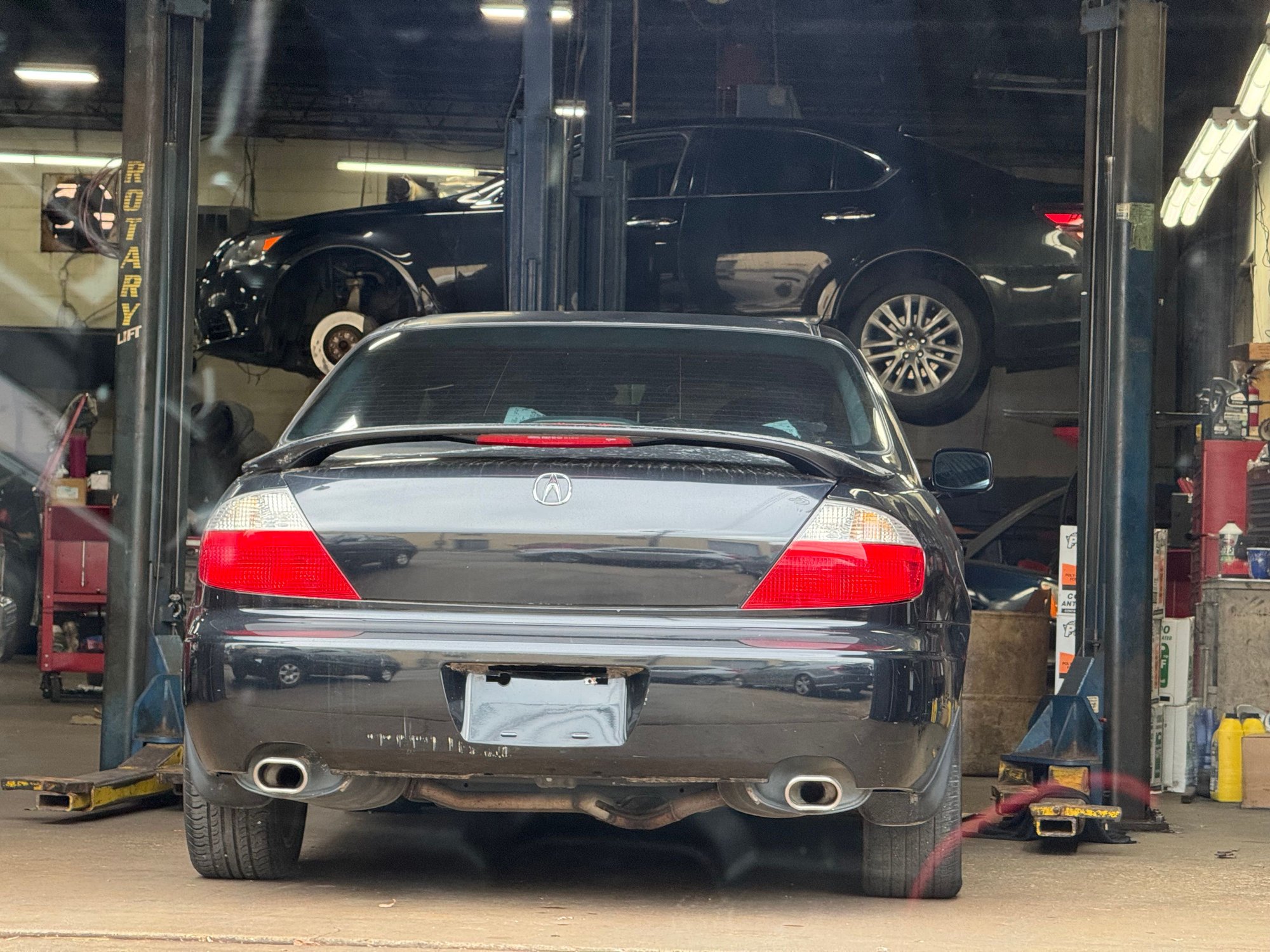

Got her in the shop, to get her right. Feels good to know I’m closer than I was before.
